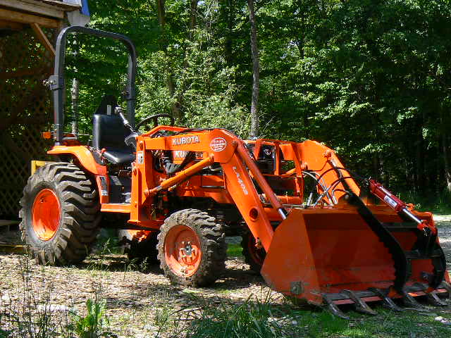

Maybe your images are too large to load onto TBN? Try makng the jpegs smaller (100 KB or so). I'd like too see that 2620
I have attached a pic of my B7800 in small size-89.5 KB
