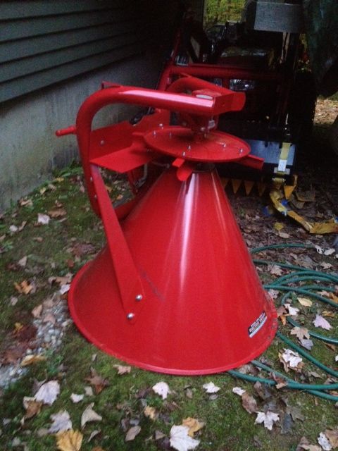

Agrex XA250 spreader

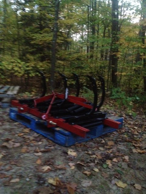

Fred Cain ripper/field tillage

The agrex spreader is very nice with a cast gearbox, also got the shield for sand application.
The Fred Cain ripper is sinister looking, it will breakup the ground nicely for clover. My tractor with loader and filled tires is around 2900lbs and I may have to drop the outside two rippers on this 5 shank ripper,time will tell.
