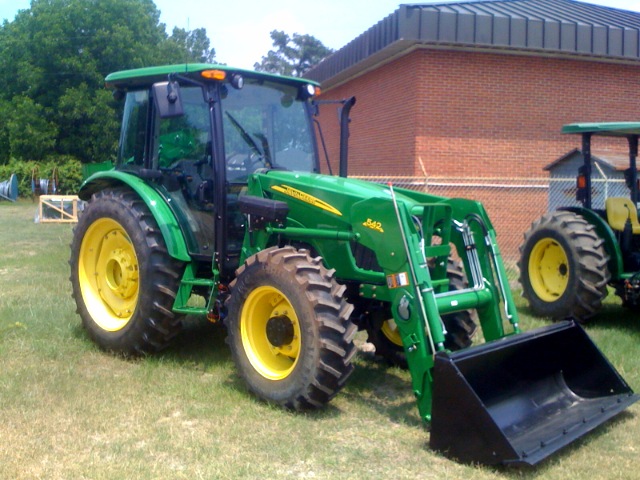

Here is a shot of the farm's new 5425. It still sitting at the dealer's lot, but will be delivered Friday morning.
John Deere 5425
MFWD
Cab with Air Suspension Seat
12F/12R PowrReverser with 540/540E PTO
15.5R38 In. R1 Radials - Rears
13.6-24 In. R1 Bias - Fronts
2 Rear SVCs
3 Mid SVCs with joystick controls
Rockshaft with telescoping links
Front Weight Support
542 NSL FEL with skid steer quick attach and 72 " skid steer bucket
Hood Guard
Mirrors
Antenna

The 'stock tires' (i.e., no cost option) for the 5425 are:
16.9-28 In. 6 PR R1 Bias - Rear
11.2-24 In. 8 PR R1 Bias - Front
That means the rear tires are about 1.4" narrower than 'stock' while the fronts are 2.4" wider. Also, the rear tires are 8" larger in diameter. The tires happened to be the package the tractor was ordered with. I don't mind having radials. If I wanted tractor spec'ed exactly the way I wanted, I would be waiting until September for it. It is supposed to hit 98 F today, I'll take the cab now. :D
The rear looks very narrow partially because of the extra height and also because they are set at their narrowest rim width for transportation.
The skid steer bucket is a bit heavier and a little more heavy duty than the general purpose stock bucket. It allows me to swap between the grapple, post hole digger, bale spear, and bucket quickly and easily.

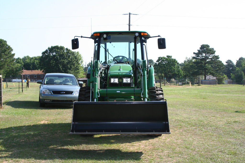

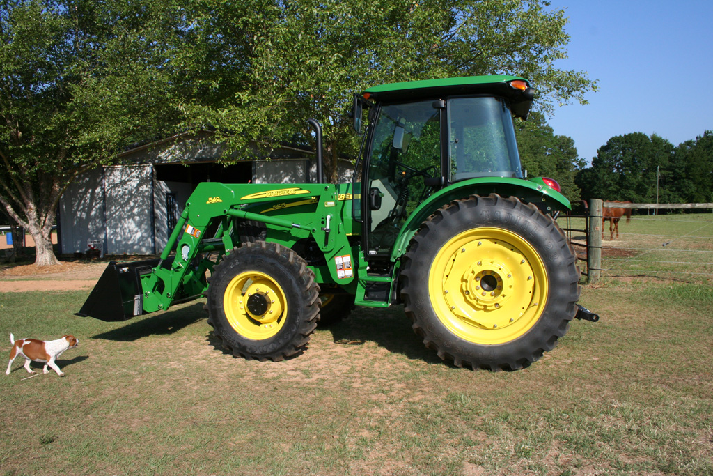

Attached are some photos of the tractor during its initial, short stay at the farm.

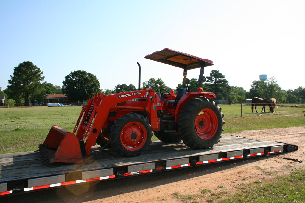

I think Cameron is going to be asking around $21,500 for the M6800. Tell him I sent you and maybe he'll drop that a bit more. :D The M6800 has an ATI Quick Attach with the skid steer bucket, MFWD, hydraulic shuttle shift, canopy, 2 rear remotes, and about 285 hours on the HOBBS meter. I'll add a few more to that this weekend.
The M6800 has been a trouble free tractor. If it had a cab, I would keep it. If you want any photos of it, let me know.
