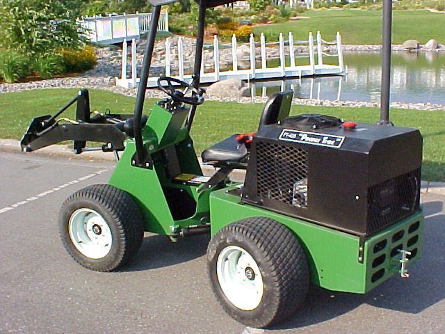

Pajoube,
Thank you very much for the pictures. Your patience in buying yielded a PT with great design improvements. Enjoy it.

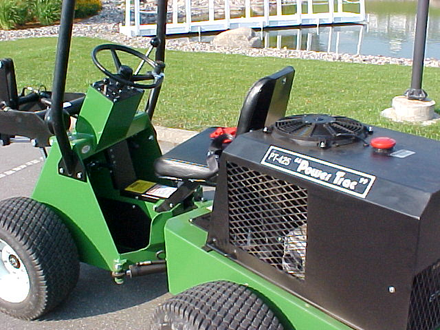

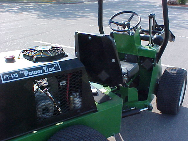

Your correct about the gas tank, ran out of gas twice. I will probably try timing between gas fills today (30minutes?) as I will be moving rock again. Running a full RPM.
The hose issue under the hood will be more difficult to work on but hope that I don't have a need to do so for a long time.
That is one very heavy hood.

MR,
No information from PT regarding the gas tank in the hood (lifting hood) other than the redesign for easier fueling. When testing the machine at PT we did lift the hood with full fuel tank without any leakage.

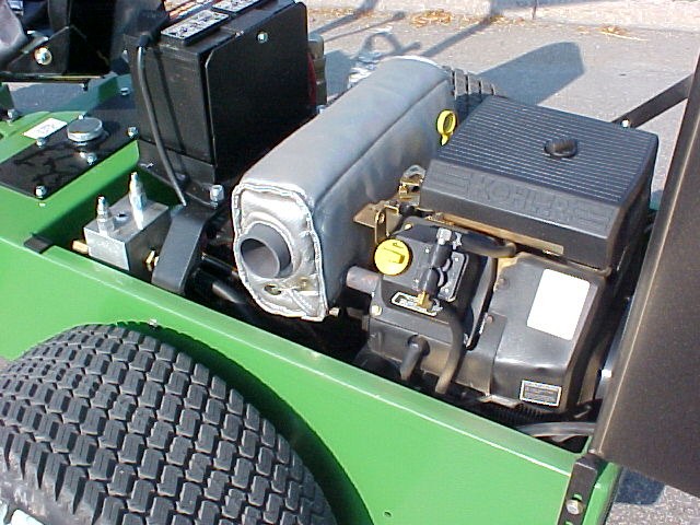

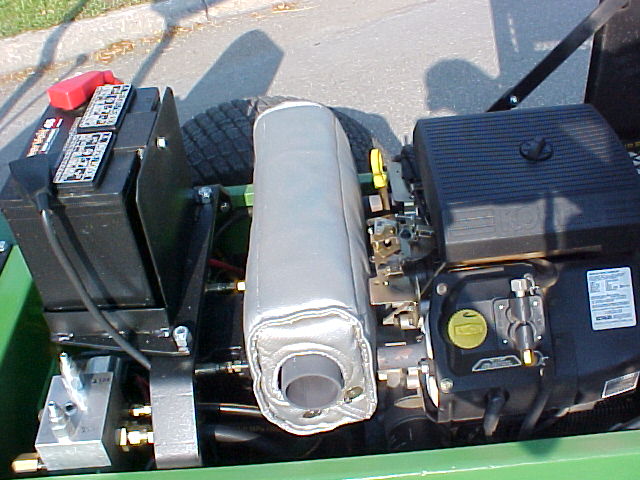

I recognize the filter holder, and connections as Parker components. Parker has a filter replacement gauge/indicator for that filter holder, it threads into the inlet side port (currently plugged on your's). The gauge is a 2.5" Ashcroft #20W1005PH01B and cost $9.10 through Grainger, Grainger part number 2C492. The gauge simply reads filtration pressure. The green or normal range is 0-12psi and then beyond that it becomes yellow and red up to 60psi.
Filter replacement gauge
There are also various Parker filters available for that unit down to 3µm all rated at 20 gpm and they around $13.
3µm parker filter

Terry did mention that they needed to move the fuel tank to the back because flipping the engine around made all the heat near the front, not to mention the lack of room after moving the battery and filter up.
