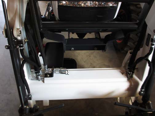

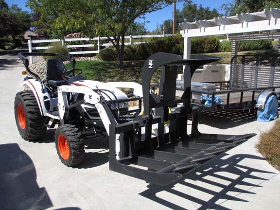

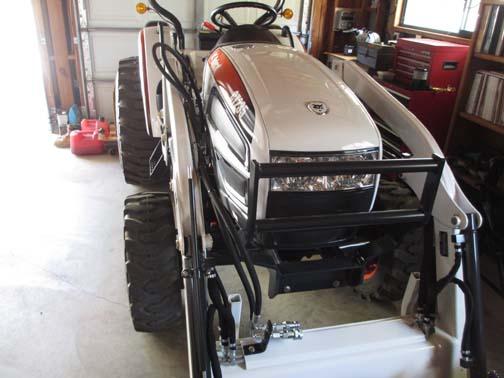

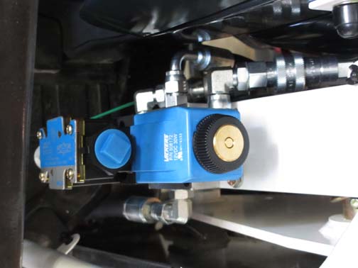

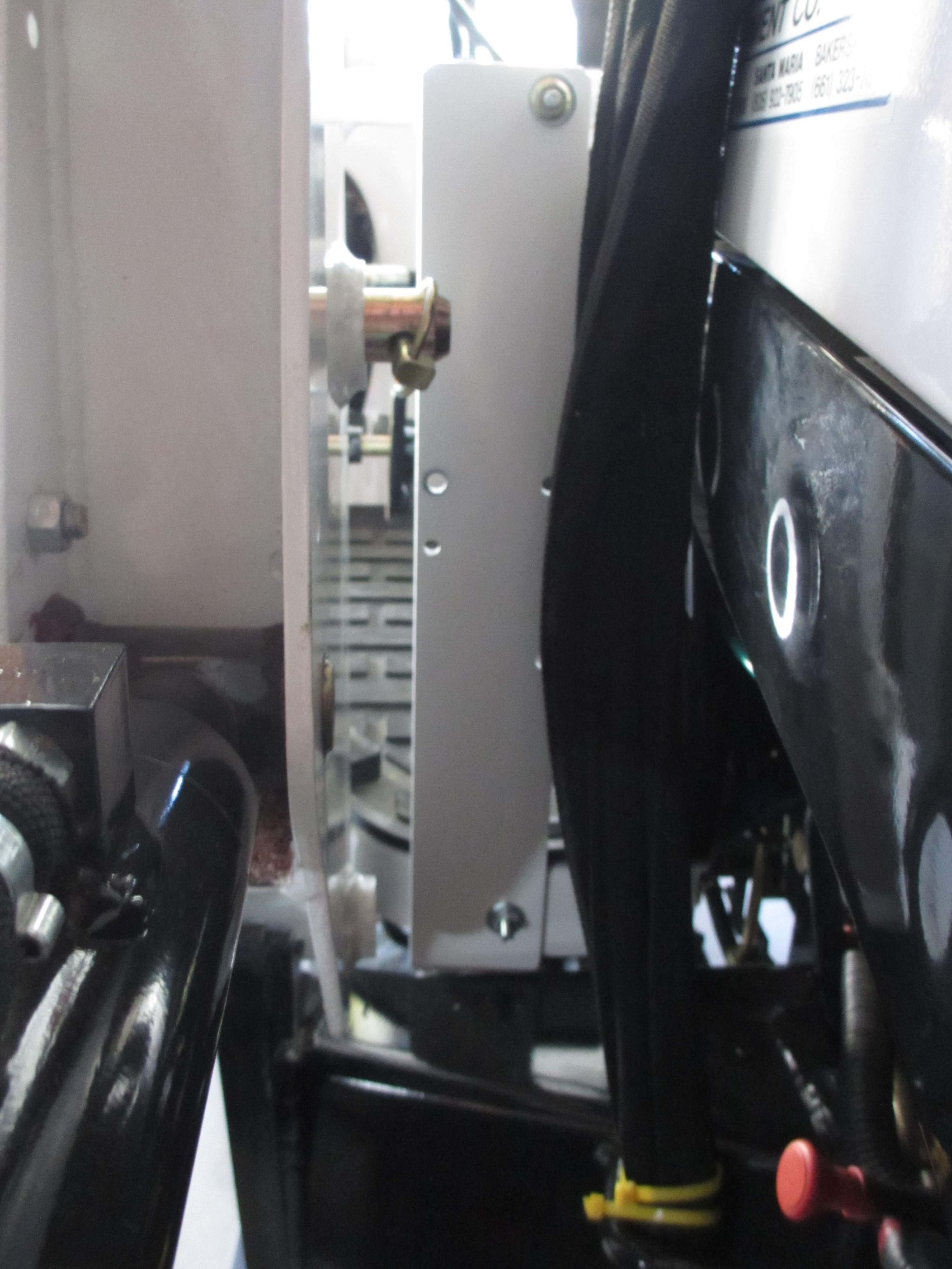

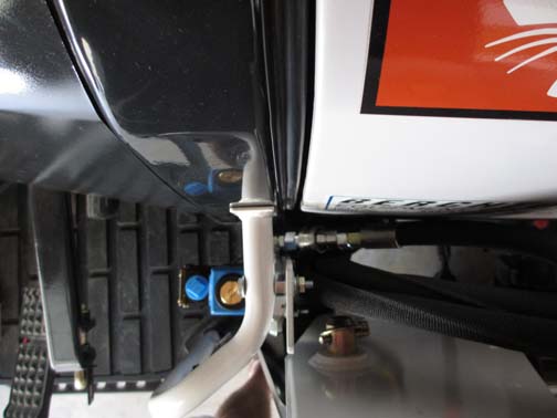

OK, so I just installed the 3rd function valve and hydraulics for my new grapple. I still have to install the Scorpion joystick button handle and connect the wires (simple), but I did test for flow and the valve works. Here are some pics. I'll post more when I get the handle connected to the joystick and replace the flat connectors on the grapple with some 1/2 inch AG QD.

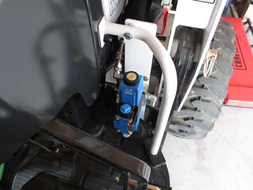

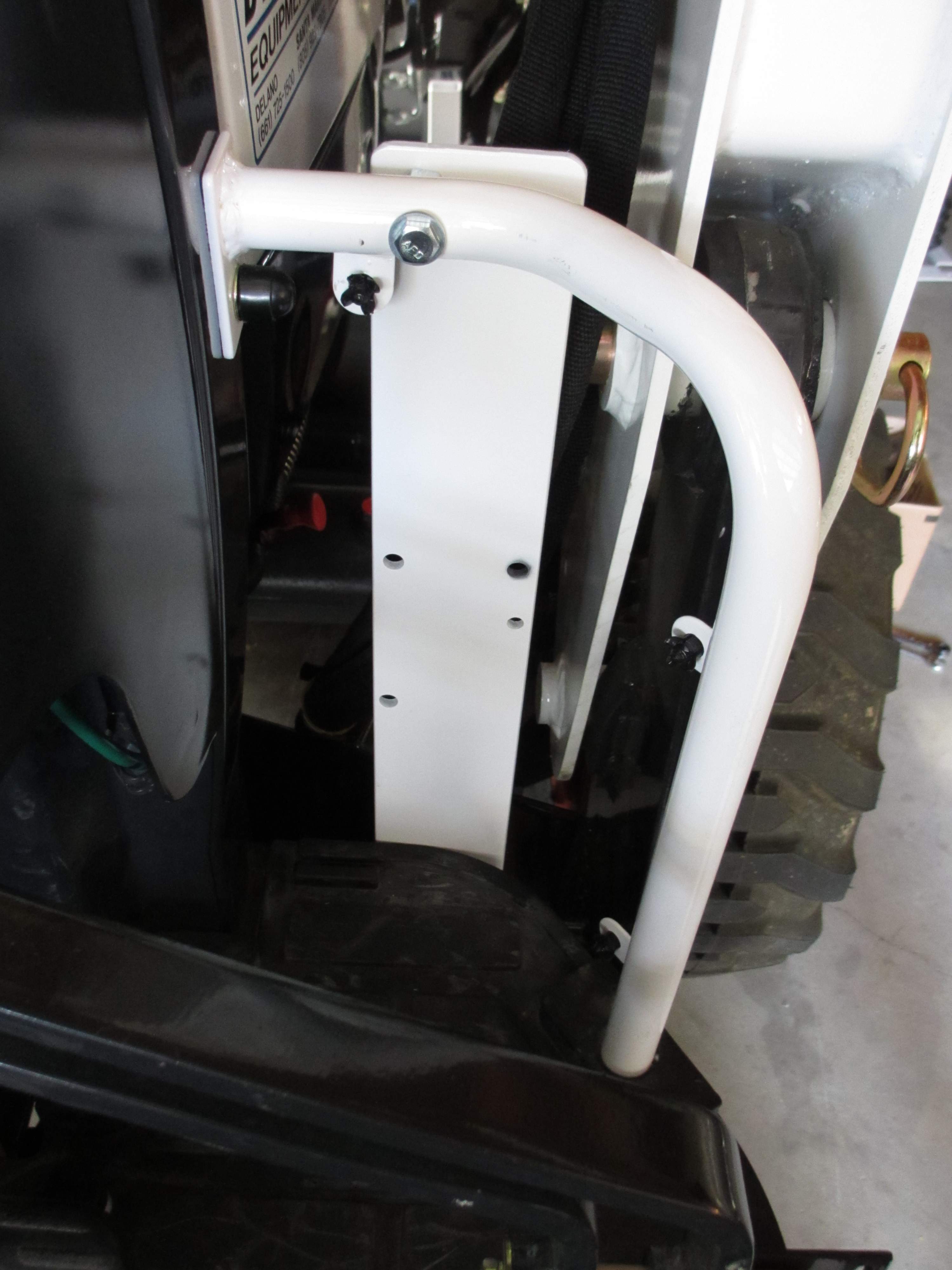

This is a Construction Attachments kit purchased through a dealer. It's actually for an 8TL loader, but works fine on a 7TL by just reversing the position of the valve. I did have to make my own mounting plate as the one in the kit is for the CT335. I also had to remove the clear plastic piece from the mud guard to install the valve.

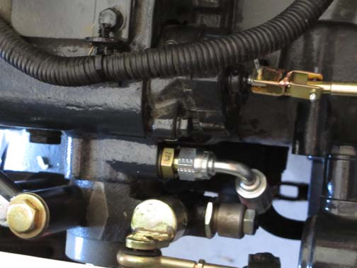

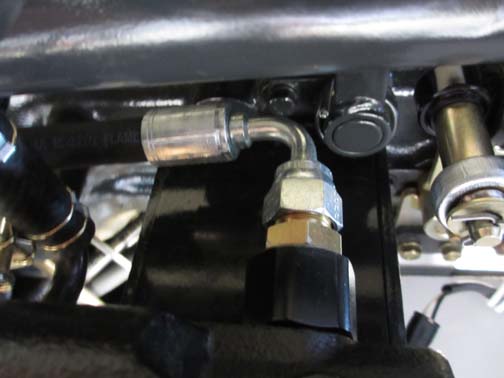

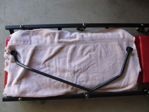

Installation wasn't too difficult except for connecting the 90 degree JIC fitting at the loader "power beyond" port. The tight working space and leaking hydraulic fluid made it a chore to screw on the fitting. I also had to remove the seat in order to connect a hose from the tank to the valve. The tube in the picture below is the power beyond tube that had to be removed. Each corresponding tube port was then routed to the valve by a hose.
The bulkhead hoses were a little too long (made for CT335), so I just dropped the bulkhead mount to a lower position than noted on the instructions. Great instructions and customer support.

Hi SSdoxie. I called and spoke with Construction Attachments to ask questions about the kit and they referred me to a dealer here in California. I should have ordered it from a dealer in North Carolina and would have saved $55 bucks in tax. It was a toss between this kit and the WR Long kit... two different setups. The WR Long kit requires mounting the valve to the left rear side of the tractor (near wheel well). This would have required very long hoses from the rear to the front, about 14' feet. I didn't want to do that. I prefer mounting the valve to the right front side. I also preferred the Scorpion 2 button handle as opposed to a switch and a valve with an accessible electrical connection box.

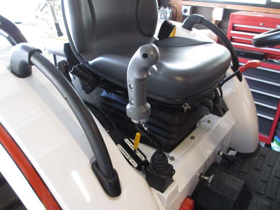

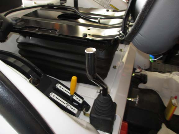

I'm a little frustrated with the way Bobcat designed and mounted the plastic joystick control grip. It does not pull off or unscrew. I'll have to cut it off... and the top of the stick is not round, it's flat. So I'll have to cut that off too in order to slide on the Scorpion control handle. You'd think they would have thought that through a little better.:mad:
In order to install this kit, I had to remove the right plastic mud cover; drill two holes for the valve mount; drill one hole for the electrical and I'll have to cut the top off the joy stick to install the control handle. I also had to remove the seat to remove the tube and install an adapter and hose.
I'll finish it up as time allows.
   / New 3rd Function Grapple Valve on CT235

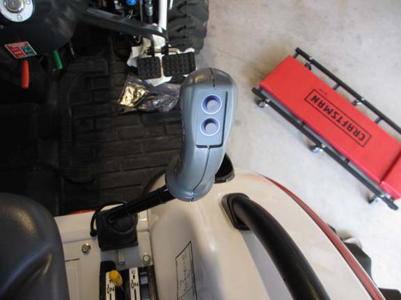

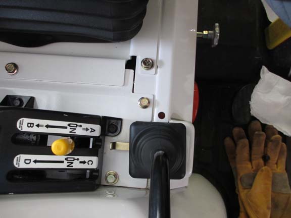

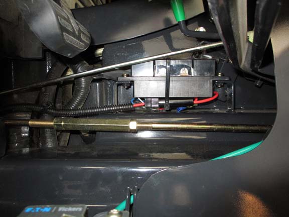

Installation of electrical and hydraulics is now complete. Not enough time for this kind of stuff. Time to test it on the grapple tomorrow. I had to cut off the loader joystick "grip" and grind off part of the joystick at the bottom of the knurling (visible after removing the grip). The Scorpion control handle went on without a hitch after drilling out the attachment for the handle with a 37/64th's bit on my drill press.

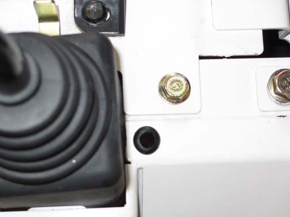

I had to drill a 7/16ths hole for the electrical wire next to the rubber boot and insert a rubber 1/4" grommet. The electrical connection to the fuse box was made using the fuse and hardware provided.
The only hiccup is that one of the up/down lights on the valve isn't working. The setup looks pretty clean.

It Works! Nice and smooth!
