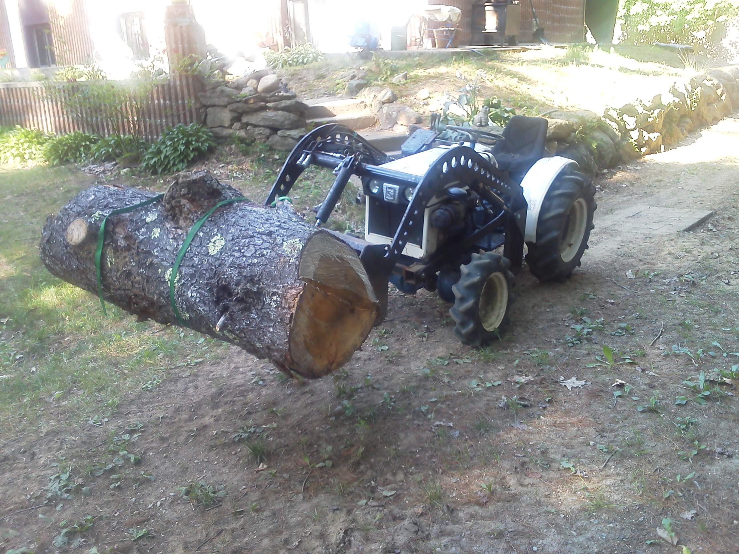

techwrtr2 I need to make a grapple! I am going to burn wood coming up soon. I'm going to make an outdoor wood boiler. And while chaining/strapping logs to the bucket is good for my waistline, I think having more weight in the drivers seat is very important to the health of my front diffs.

Flip your front wheels around, they are not designed to be in the "wide position" and you will likely end up craking the rims from teh added stress with them mounted out. The guys at Valley Power will tell you about that.
These tractor are VERY narrow for the height and power they are, with a loader on there that would only make it worse, be cautious of side hill work and work with the bucket up in the air.

duwem, I'm scared to flip them in, the tractor is so narrow as it is. I'm wondering if I made a ring for the outside of the rim then the bolts would distribute the clamping force to a wider area.

I keep my wheels in the factory narrow position. I've read that having them out doesn't do more than make you feel good. Having never tested the stability either way, I don't know for certain.
I have wheel weights on my tractor as well as having a backhoe on it. You could build a ballast box and get your tires filled. You'll find that having weight back there does wonders for how the machine performs. Instead of a ballast box, you could always use a box blade and add suitcase weights as needed. I run a box blade on my JD when I want ballast. Works very well.
The grapple is so useful to me that I've only had the bucket mounted for a couple of months in the last 5 years, ever since I got the JD. Even then, I kept it on most of the time. I sometimes use it for bucking firewood. Mostly it serves to pick things up, move them, and put them down. Rocks, logs, tops etc. When I trim trees, I'll rake along under them with the Beaver finally closing the grapple at the end of the line and drive off with nearly all of them and never have to dismount.

I have 110 lbs of extra rear weight and when i got off of the tractor the right rear tire was off of the ground 6" at least.
Remember that unless the weight hangs off the rear of the tractor it is actually adding to the load seen by the front axle.
I would also suggest putting the wheel on properly. It will help save your steering box by decreasing the scrub radius. If you really need the stability, I understand why you're doing it, but keep in mind the added stress on the steering box may cause it to break. In a bumpy and/or off-camber situation, things could get ugly quickly.
My personal opinion on these compact tractors is that if reversing the front rims is the difference between rolling over or not, the area is unsafe for operation anyway. I'm definitely not trying to preach, but all of the manuals for all of the tractor builders say not to reverse the front wheels, as do experienced dealers and operators. That's good enough for me.

Thank you for all of your input. I am going to reverse them back to the factory position. I am glad I've come onto this forum as I wouldn't have known it was the factory position.
