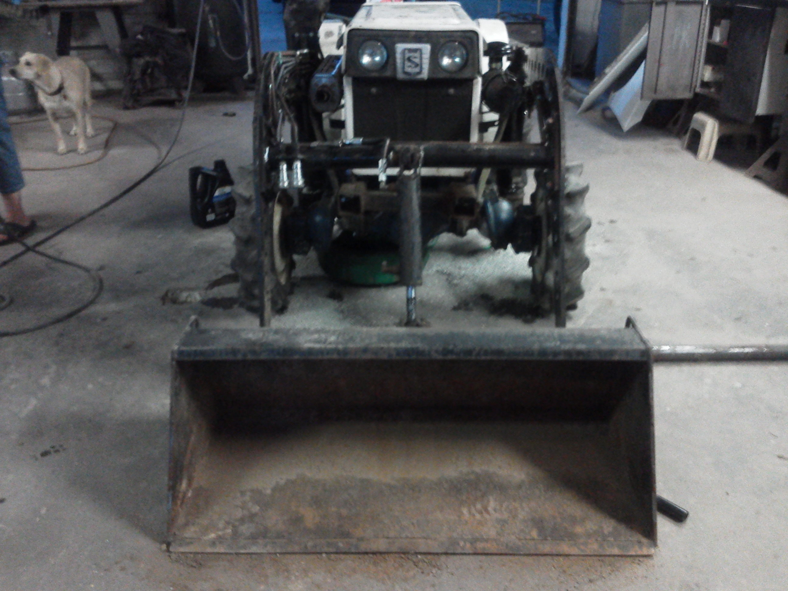

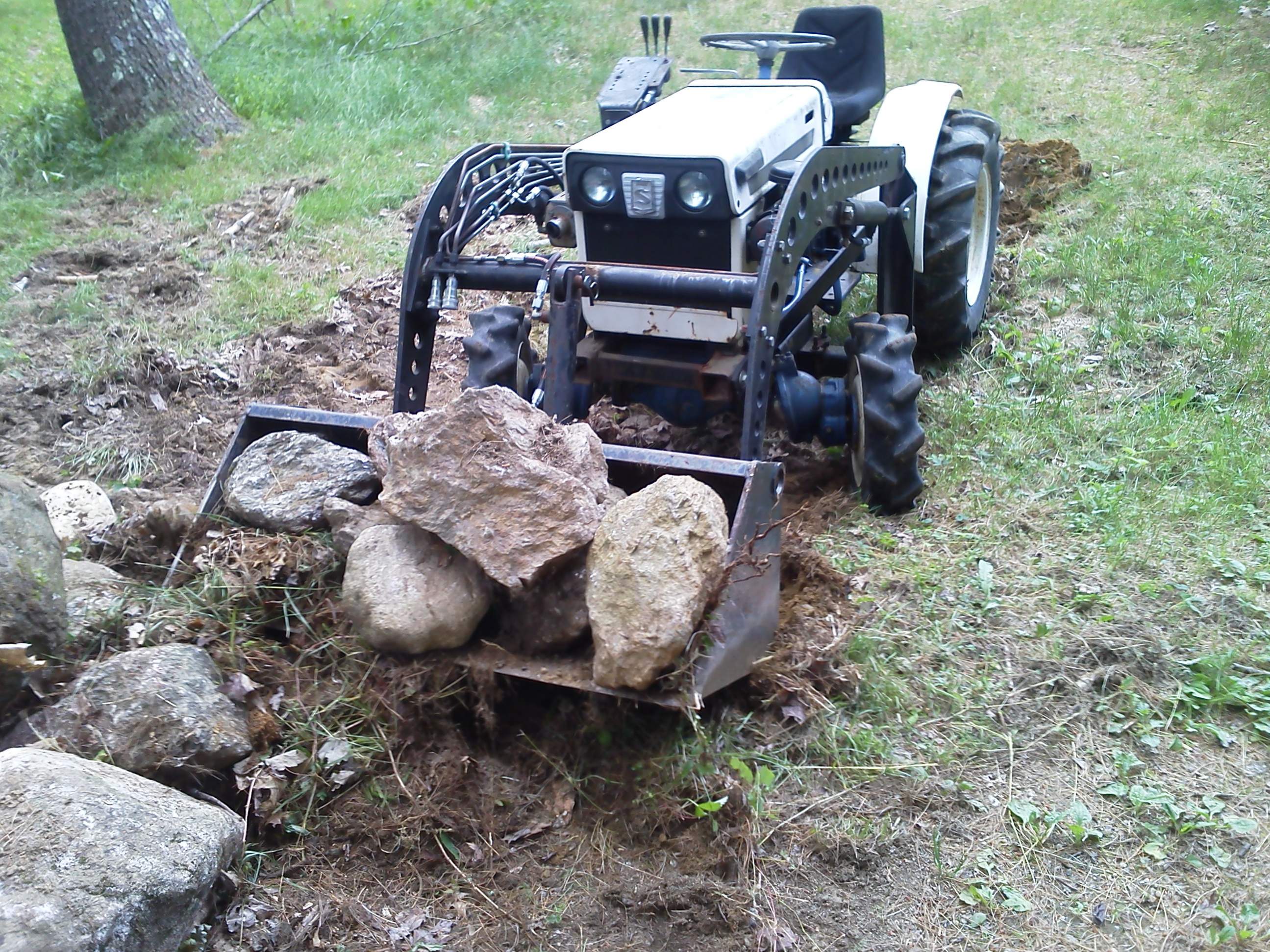

Just purchased my first small tractor, I bought it off of a friend that was done using it. I thought I would post a picture of it's first job after I changed all of the fluids. The first thing I need is some weight in the rear. This tractor will lift anything at idle, I LOVE IT!

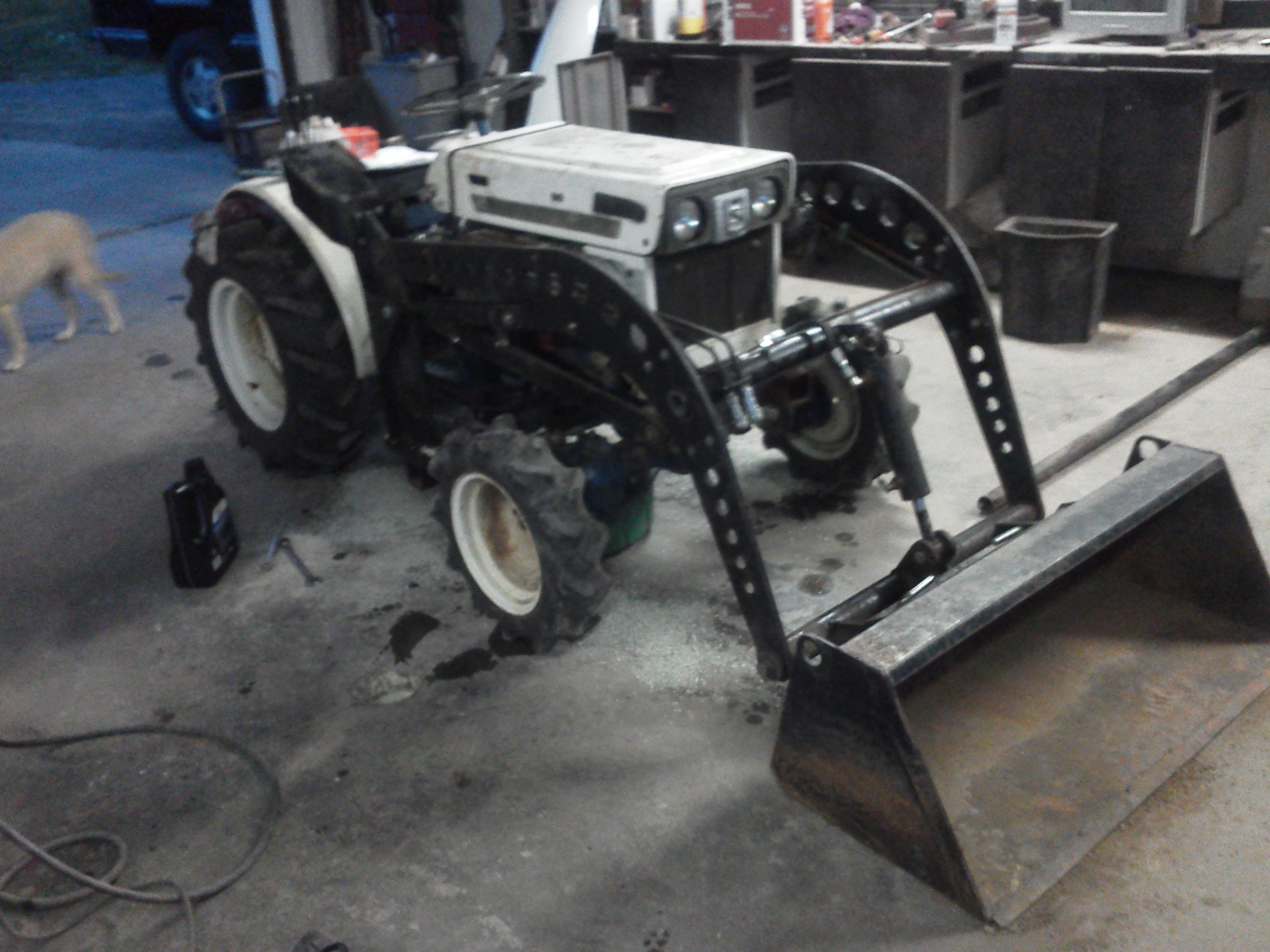

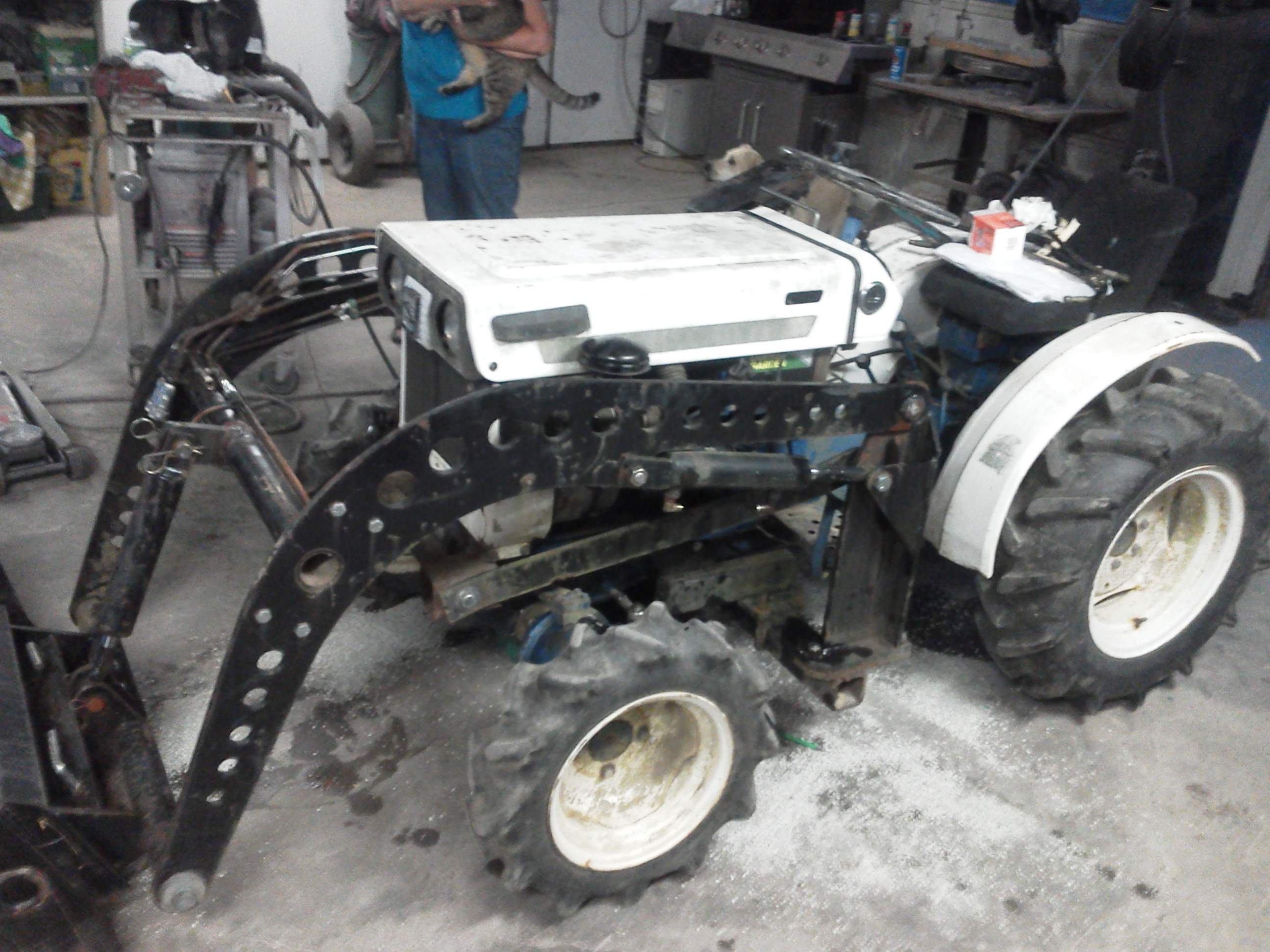

Yeah, the loader appears to be factory made. And very strong.I will try to attach another picture of it

That is not a factory made loader.
Two companies made loaders. They were BlackHawk and Swartz. Both have been of business for years. They both used retangular tubing. Those arms are cut out of thick, heavy solid steel. It looks well built, but honestly a little over kill for our little tractors. Just be careful of over loading that front axle. they are very pricey to replace and break fairly easy. Welcome to the board. Awesome little tractor you have there!!!

Just be careful of over loading that front axle. they are very pricey to replace and break fairly easy...
Indeed. In fact, it is highly questionable whether or not the original designers of these size tractors gave any thought to the installation of loaders for them from a capacity standpoint at all. In any case, I'd make sure the relief valve on the loader controller is set rather low to help avoid inadvertently breaking something. I've heard where the rated capacity is only about 500 lbs and that is easy to achieve with two cylinders and 1900 psig of hydraulic pressure possibly going to each of them.
