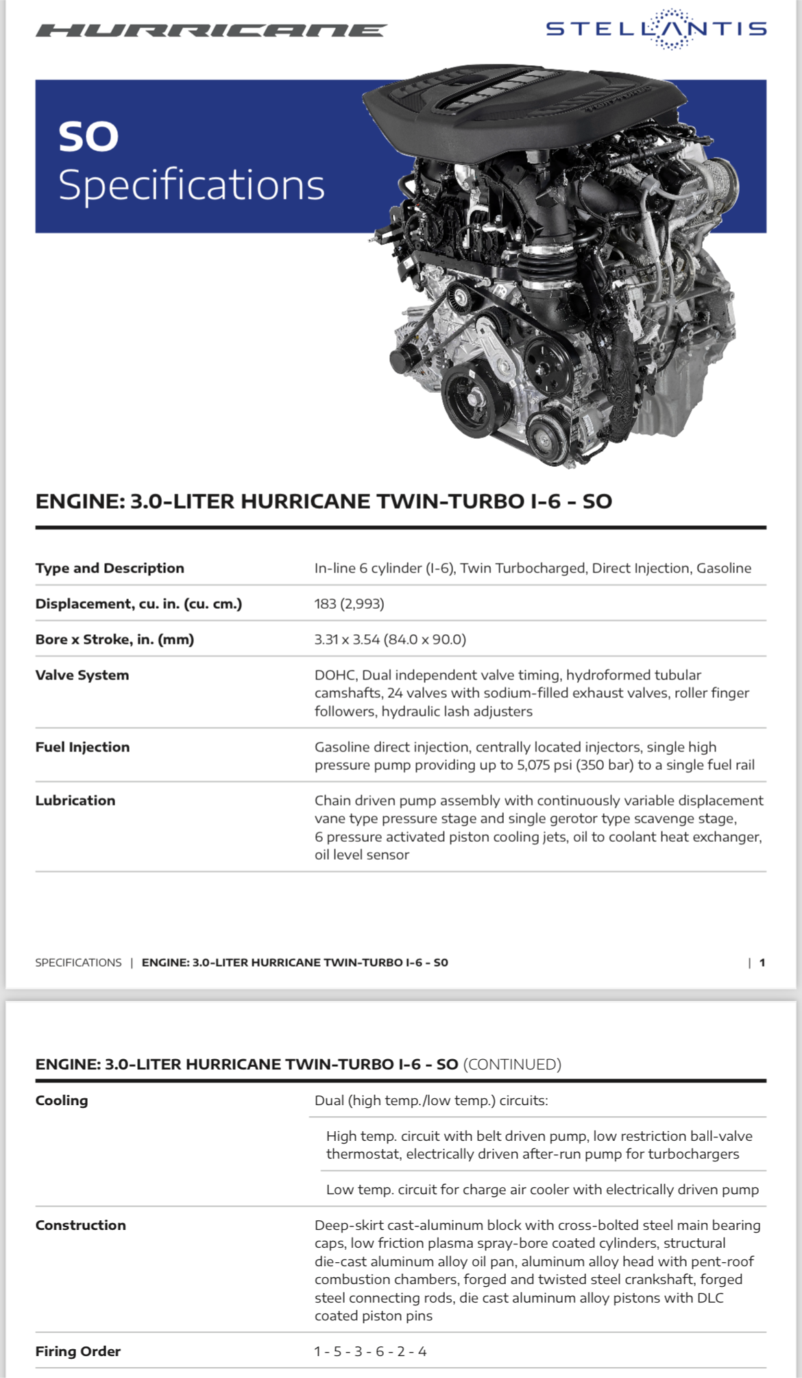

Lotta “stuff” on it.
You wouldn’t know by the shape, there’s a long skinny inline-6 under there 😂
A bit surprised they’re using an aluminum block
Made in their Mexican plant.

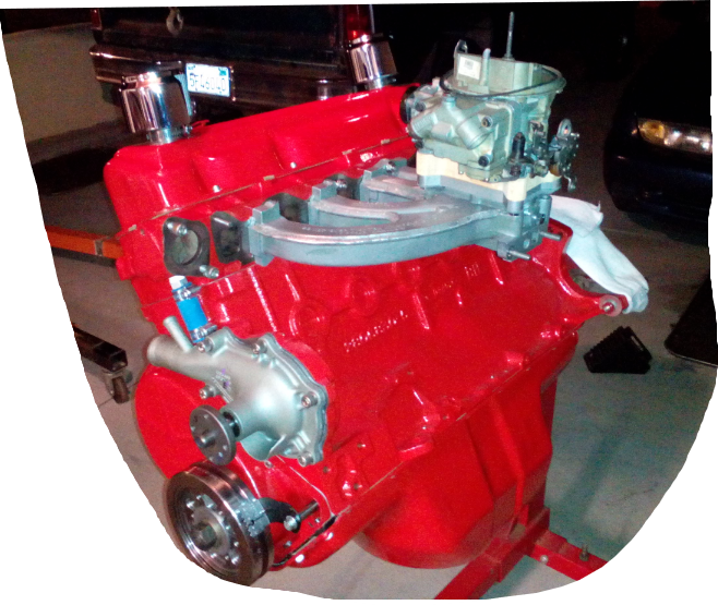

Really tho, other than the pulleys and belts on front giving it away you'd be hard pressed to tell it's actually an engine, ridiculous, I wouldn't want to have to work on it for anything other than an oil change. Always blows my mind when you look at an old engine, take an old 225 slant 6, and compare it to that engineering nightmare:
   / New 2025 Ram 1500 with hurricane engine. #50
That’s a “performance” 2 barrel version😁. My ‘68 had a 1 barrel carb.
All this crap they put on isn’t because they want to. It’s all to meet ever tightening government regulations
