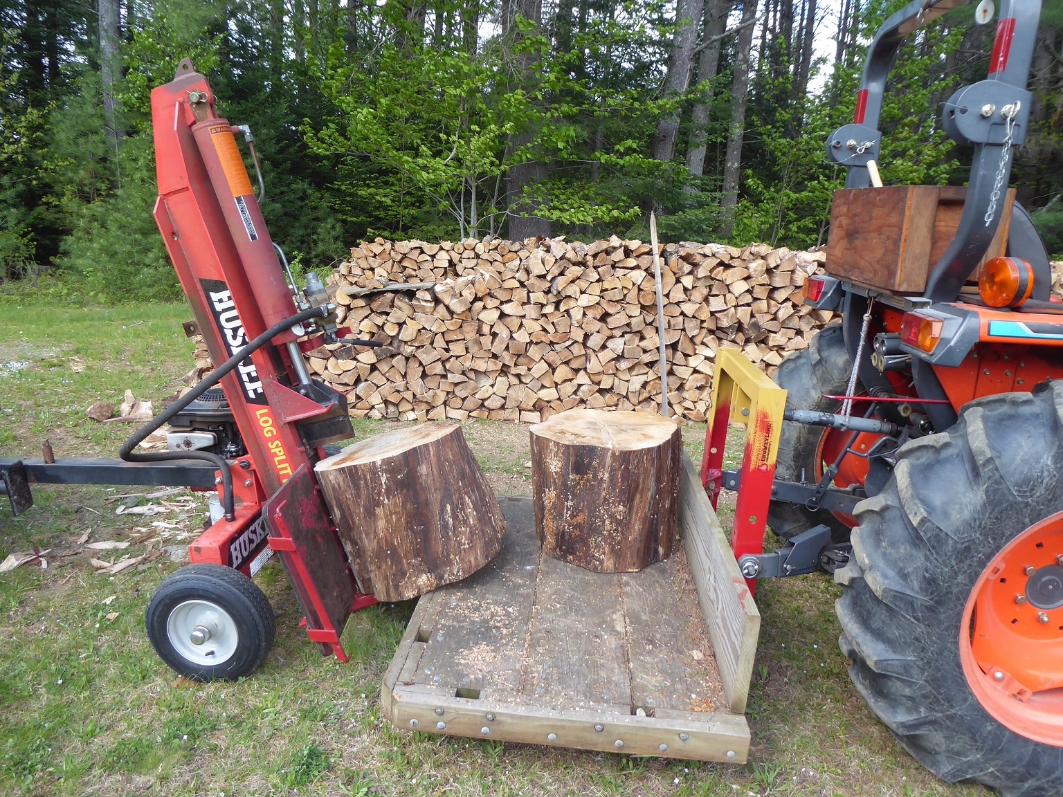

Arrow, maybe you could fasten a rough platform or piece of plywood on the end of your forks to make moving the big blocks around and positioning them on the vertical splitter shoe easier. Sort of like this..
gg
I use the decked carry all as a lifting table for all the big stuff going on to the Horizontal splitter.
Roll the big ones on to the deck, lift with the 3pt, roll the rounds off to the splitter rail.
Bah dah BING!

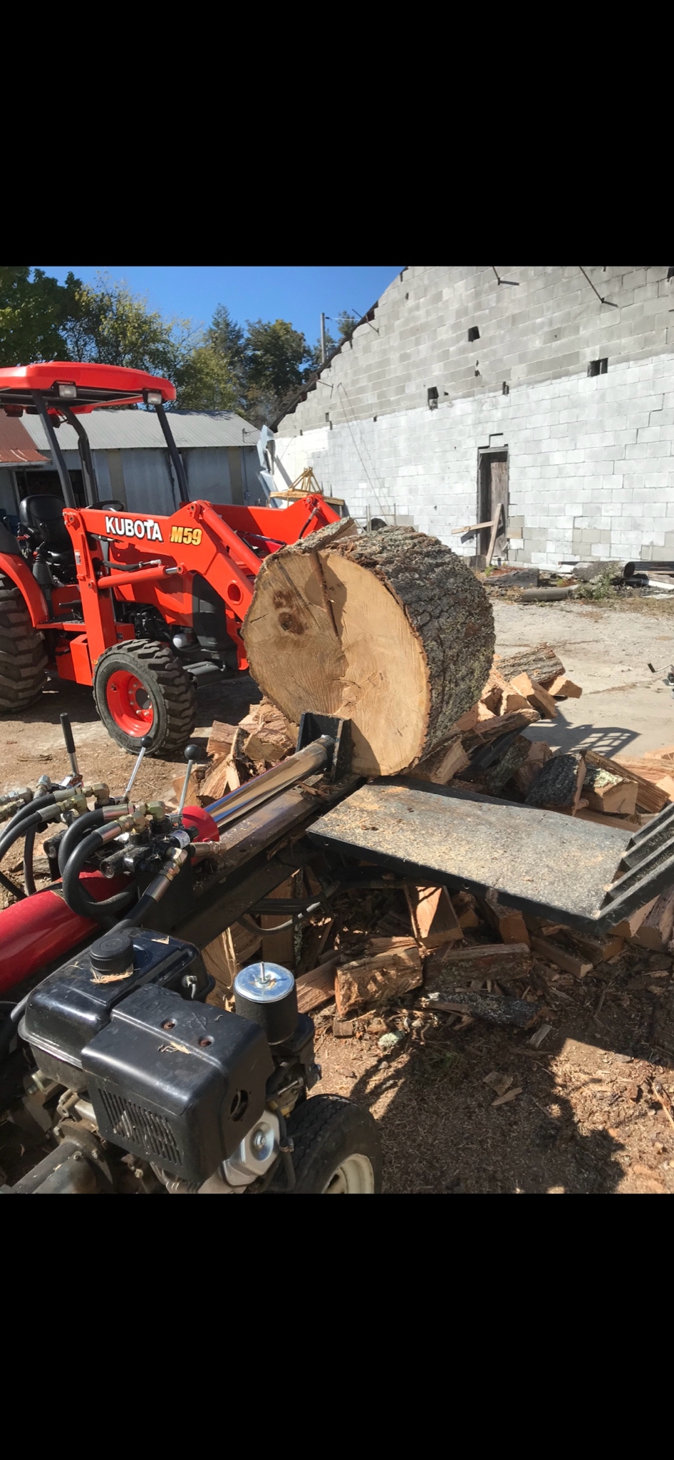

Even if I’m loading them whole and not noodling them all the way I like to put a saw cut in the opposite side as the splitter. They pretty much always crack all the way in half the first time that way instead of having to rotate it around and splitting it again. This one has a saw cut in it. View attachment 4189545
