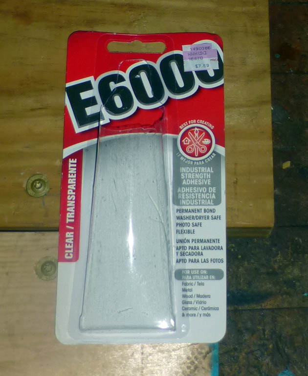

I think this glue will work. I again tried to pull my test pieces apart and couldn't for the last bit.. When I glued the wings pieces together, I spent more time abrading it with 80 grit sand paper, then cleaning them with rags and alcohol. I think I'll again use this glue for the next one.
