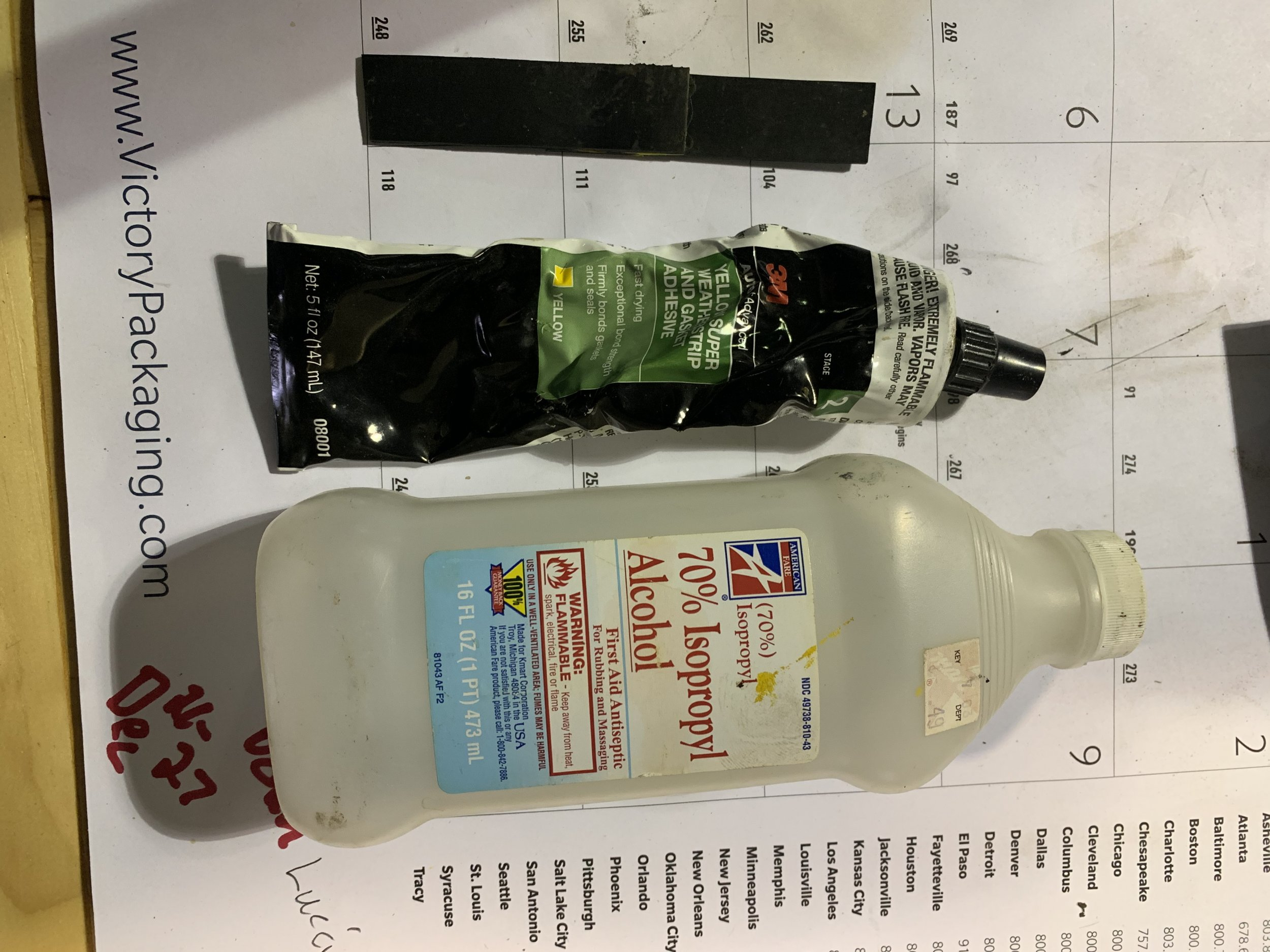

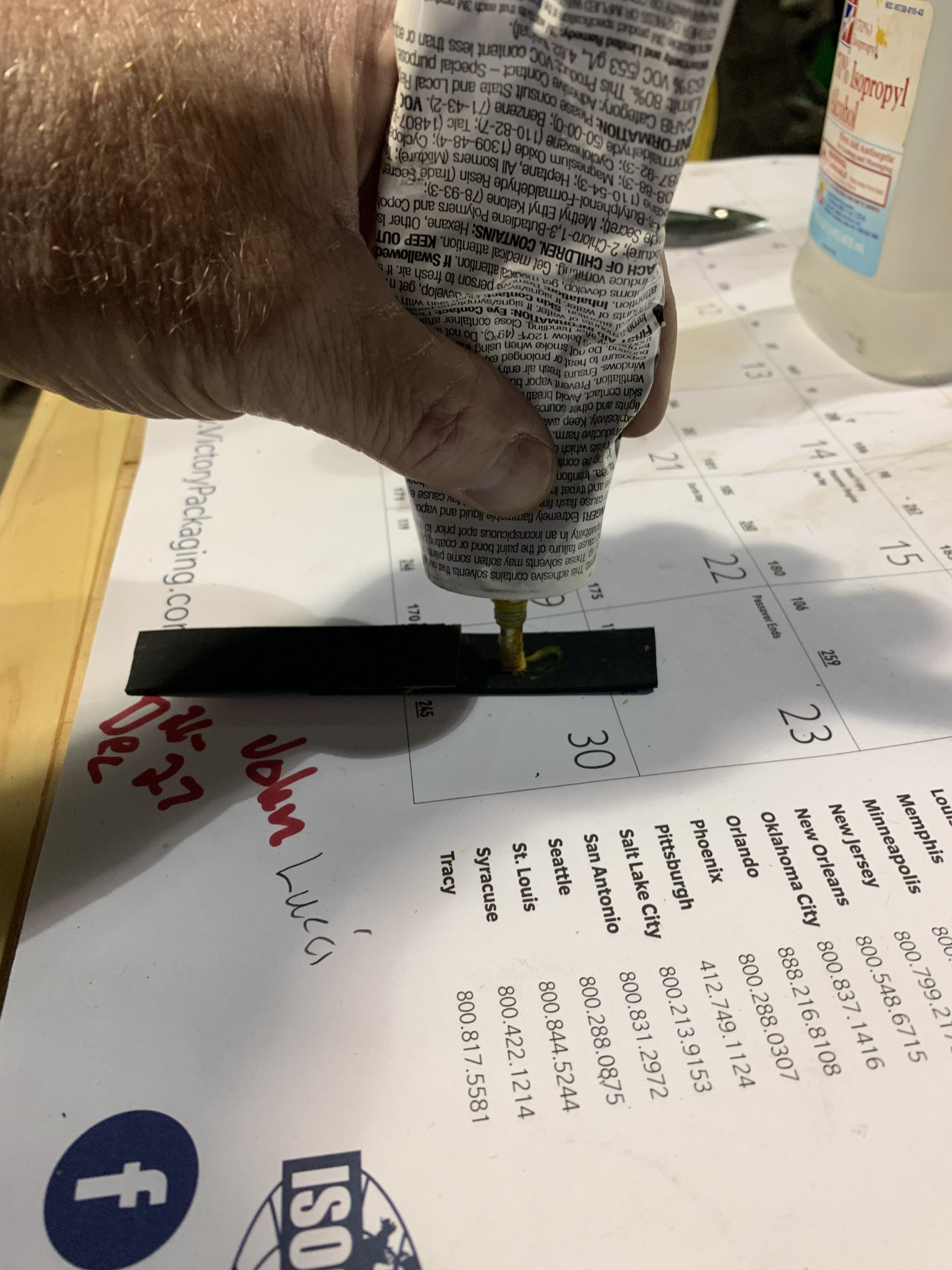

3M super weatherstrip adhesive. Clean both pieces with isopropyl alcohol, apply a thin layer to both pieces holding the tube perpendicular with nozzle Flat to the neoprene squeeze gently while moving the nozzle to coat . Let it dry for about 5 minutes then stick together with good pressure.
