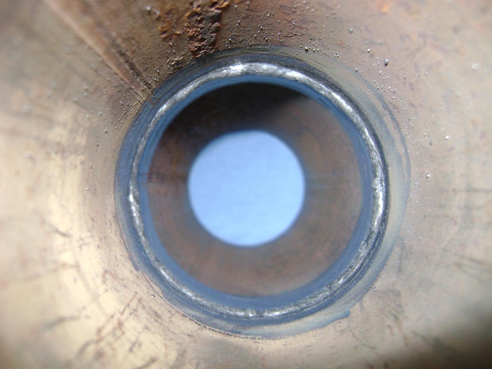

Sometimes I'll run 7018 on DCEN for open root welding. Starting to see it more and more for new hire testing with 7018 open root pipe. Guess the employers want to separate the men from the boys right off. I like DCEN more so just for the root, then switch to DCEP for hot, fill, and cap.
Here's a picture of the inside of a pipe welded from the outside with 7018.

I have seen that also and always thought that the folks specifying that must be the most stupid person in the world when it comes to welding. My thought were always, let me see the sucker who spec'ed this out come and make a test on it. Although it can be done, 7018 is not an open butt rod. Just because one can make a weld with it doesnt mean it should be done. If the engineer wants 70K tensile on the root, there are open butt rods that will do that or the best option, use TIG with ER 70S wire. You get a more uniform root pass and no slag inside the pipe and best chance to make it pass 100% xray. You have to have a perfect fitup to make a open root 7018 weld and getting that in the field under actual conditions is nearly impossible or would take so many manhours as to be impractical.
