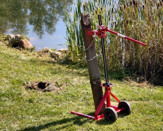

Thought this might be interesting to other members that need a way to easily pull fence posts or the like.
Over the past summer I installed my share of fencing. In the process of finishing a homeowners yard that had just installed an in-ground pool and an ornamental aluminum fence a landscapers Bob-Cat operator got a little to close to and damaged the fence that I had just installed.
As a result it was up to me to make the repair. As it turns out the day that I picked for the repair was high humidity and over 90 degrees in temperature. I had to manually dig out an aluminum fence post that had been set in 120 pounds of concrete. As I dug that hole using a shovel and spud bar I decided right then that I was going to come up with an easier solution for the next repair.
After searching the Internet I found several variations of jacks that claimed to easily pull fence posts with concrete plugs still attached. The jacks sold for upward of $600.00 :eek:
The picture was my 1st attempt at a solution and used a farm jack that I had previously purchased from Harbor Freight, an old 3-point frame, and a set of wheels that came off an old chipper. It worked fair, but proved to be way to flimsy for pulling posts set in concrete.

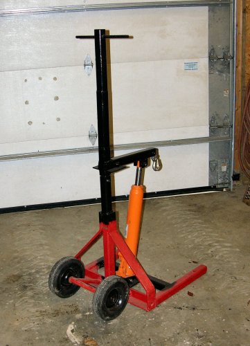

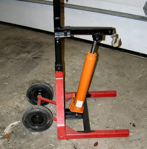

I quickly learned that keeping the center of gravity as low as possible is a big advantage. The final design uses a hydraulic cylinder purchased from Harbor Freight and rated at 8 tons.
I used a hook on the lift arm so that a chain could be used to help pull the posts. I have used this jack and it is much smoother in operation. I have used it to pull 6 X 6 posts set in concrete without problems.
The main support post is 2" X 2" X 1/4" steel. It is made to come apart just under the point where the pivot arm attach駸 to it. Disassembling the jack makes it easy to load in the van or trailer without taking up to much space.
When pulling a post there is no weight put on the wheels which is a plus. Once the post has been pulled the jack can be tilted back and used as a dolly to transport the post.

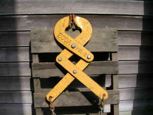

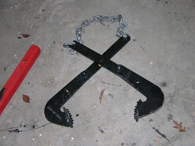

I took an old pallet puller and did a little welding on it so that it could be used in conjunction with the jack. If a fence post is rotted or broken off at ground level the puller can be used to pull the concrete plug so you don't have to manually dig it out. My back is still thanking me for making this gadget.:D
The original pallet puller looked like the picture on the right.

I may be looking at it wrong. I was thinking the horizontal bar with the chain hook on it travelled upward when you jack it.
/ Needed an easy way to pull fence posts
#20
Bob that bar is attached at a pivot point to the main support. The cylinder merely drives the arm upward it's really a pretty simple design.
