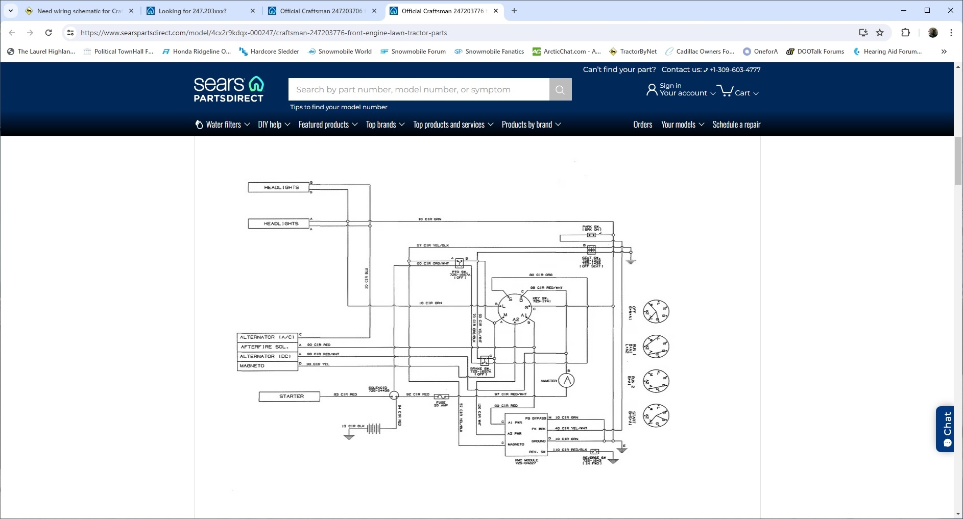

I am stumped on an electrical problem with a Craftsman T900 lawn tractor. Model number 247.203791. It is made by MTD and the companion MTD number is 13AP79XT099. DOM is 2015.
I have searched on line and have not come up with anything helpful. If anyone has a PDF and can share it, I would appreciate it.

Someone brings me this mower after they and their brother inlaw messes with it. They said it would not crank. They charged the battery, changed the solonoid and checked the fuse. Still no crank. They jumped the starter and it turned. There were guessing on the solonoid. They did not test the old one. The
I bench tested all of the interlocks and they work. I saw some home made wiring repairs under the battery and I am suspicious of them. I saw one green wire going no where. That may be correct as it was not stripped and in a bundle tie wrapped together.
This has one of the newer MTD key switches with the light and push button for running with the PTO on while in reverse. I am not sure how that is suppose to check out. Wiring diagram will be very helpful.

Russians don't have it but I think this is what you are looking for.
Steve had it. lol

Thank you . That is the closest I have seen so far. I will confirm more of the wire colors to it later today. Just at first glance it looks pretty good. On a minor note, It does not have an ampmeter on the dash. This might be an option for up graded models. The RMC module has a different number. It is 725-06119A. It may not matter.
Under the battery there is a green wire that is not going anywhere. It may be intentional or it may have been cut by the previous people trying to fix it. The Yellow-orange-white bundle of wires you see are going to the PTO interlock switch. See pic below. If anyone knows where it goes or if it is not being used, I appreciate your input. There are 2 green wires in that bundle. The other green wire coming goes to the solenoid. You can see a bit of it in the pic. This wiring diagram only shows red and orange/white wires going to the solenoid. Just to make it more confusing.
Thanks again. It is a process.

The wiring diagram Stevem posted has been very helpful. Some of the colors do not agree but much of it I was able to confirm with my DMM. The only thing that seems a bit off is the wiring for the RMC module.
I took off the engine cover and found a mouse did a number on a lot of the insulation coming from the alternator, one of the spark plug wires and one of the magneto wires. I am going to have to splice in some new wiring. There is a relay on the Kohler engine that controls the anti back fire solenoid.
The stray green wire traced out to a common ground. I would assume it was never connected on that end since all of the switches in that part of the tractor appear to have the correct wiring. I butt connected a wire to it and connected it to the frame creating a better ground path. It won't hurt and may help.
