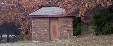

:DI have a drilled well and where I live the accepted frost line is about 36" give or take a few inches depending the the soil type. I built a block structure around the well head with a hinged top. I used pour in block insulation and I also used the extruded polystyrene foam on the outside of the block below grade and also on the lid/roof. it has served me very well. The insulation has paid off well. We had a bad winter a few years ago and we had a winter storm that had the power off for about 20 days and the temps went down to 20 below at night and didn't get above zero through the day. I kept a candle burning in the well house and that kept it from freezing up when the generator wasn't running at night. Not the prettiest but functional.

To some it may look like a small rental cabin disguised as a pump house!:thumbsup:

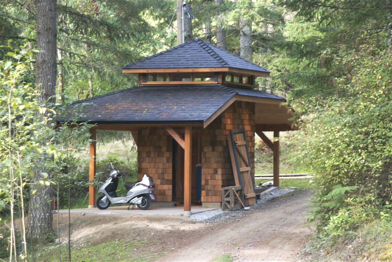

ChevyHDGert , Here's my house. Had some left over alum. got base and corner post welded together. Used enough wood to attach insulation inside. Outside used left over vinyl from full size barn. Got my sheet metal shop to build the roof. Here's pic of pickup when tank had to be replaced.
That gave plenty of "wide open space" to work on pump. Then very carefully sit it back down over the new tank. I have it sitting on bricks.
/ Need Well Cover Ideas #14
It was intended to look like a gatehouse. The client intends to erect gates adjacent with a video link back to the main house. Size inside is about 110 sq.ft but if at some future time the owner were to move the walls out, he'd have around 400 sq.ft., big enough for a cabin.
Nice job, Gotrocks, good looking pump house.

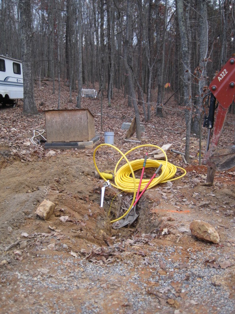

Here are the links to the temporary insulated well house my wife built for our well a year ago to protect it from the weather while we are living onsite in a camper while we build our house. The well guy gave us a loaner pressure tank while the house was being built. We put a drop light with a 100W bulb in the well house for heat. It down got to 7 degrees F outside and the water didn't freeze. The light and insulation were enough to keep the temp at about 50 degrees F.
