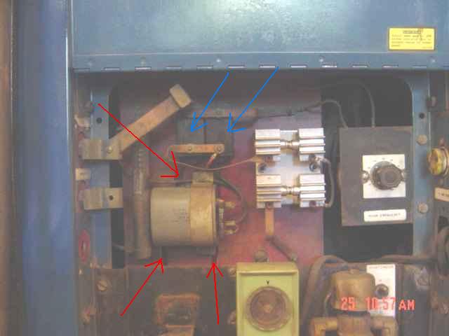

Well bummer, today I found out that the HF transformer was fried. The miller dealer said it is 100$ for the parts. Anyone have an idea how hard this is to replace?
/ Need welder advice... #65
Easy...Big Transformer. Big Wires. Keep track of the Ground. Done Deal. May Require a little Soldering depending on current production.

Yeah it stick welds great. But I got the miller dealer to check out the HF to get ready to tig and they found the problem. I think they want 150 just to install the new part :(
I may just install it myself if it's not too bad of a job

I wonder what would have cause the HF to go out?
Could be as simple as age. Or capacitors, (blue arrows). I know I got tired of changing them on my old Gold Star, thats one reason I bought the Dynasty 300.
