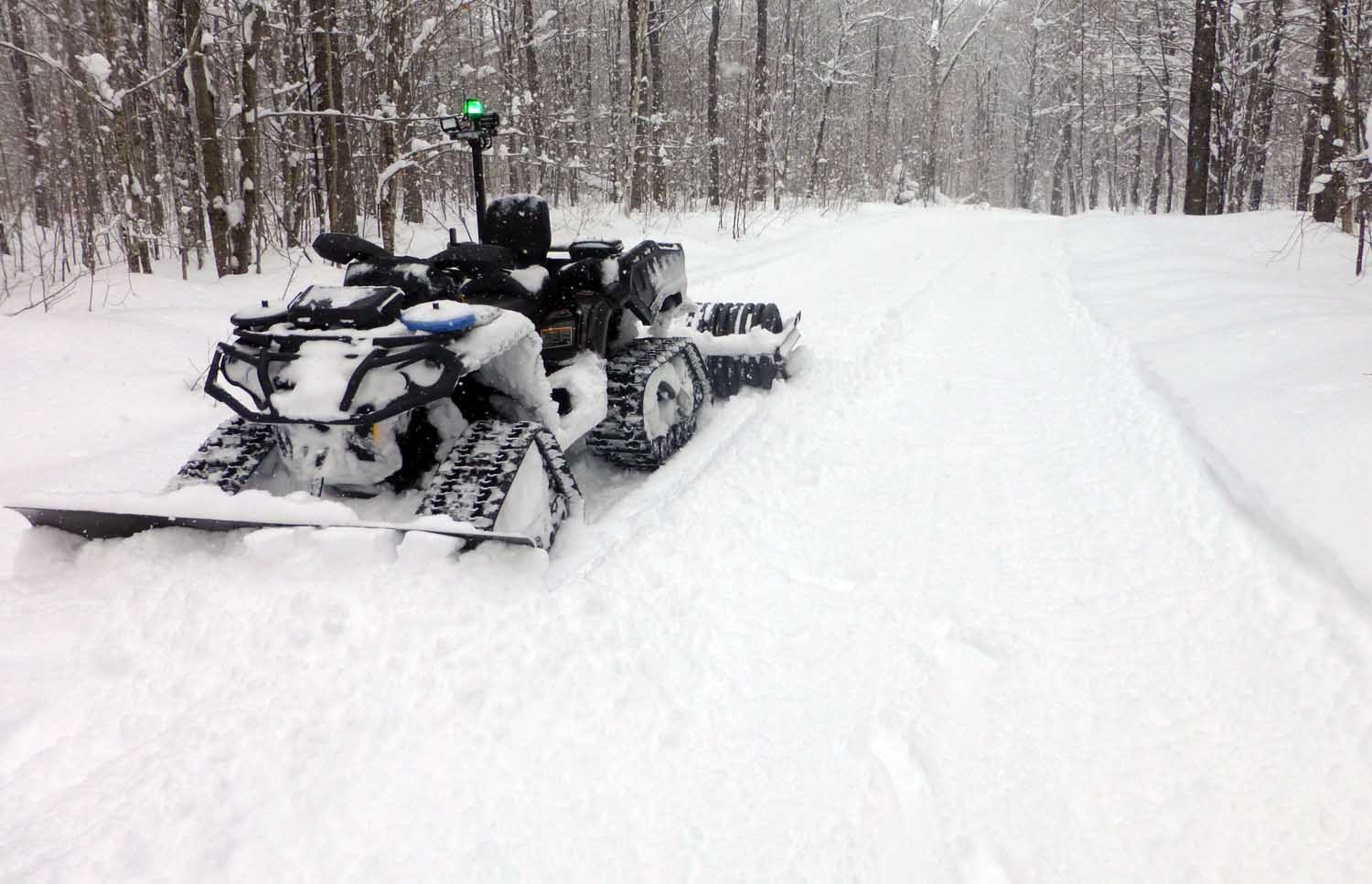

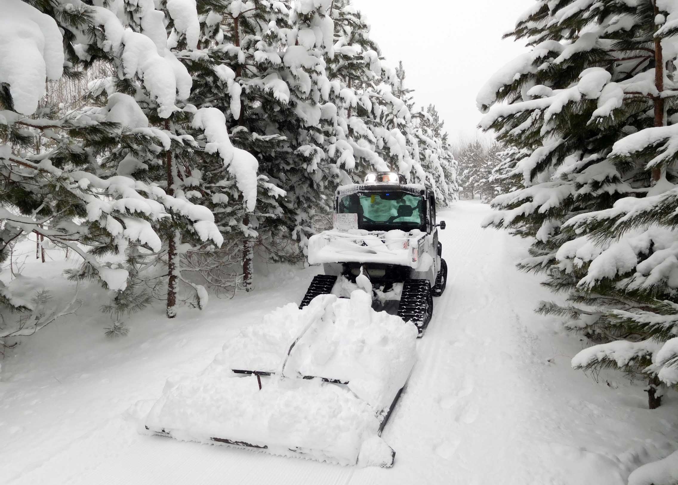

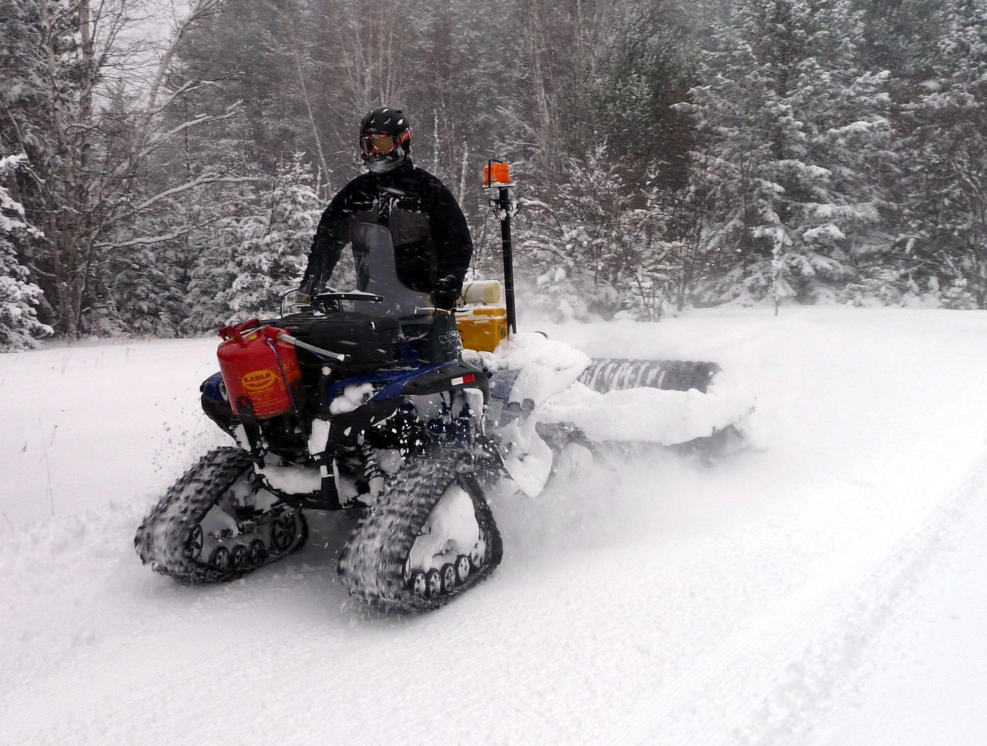

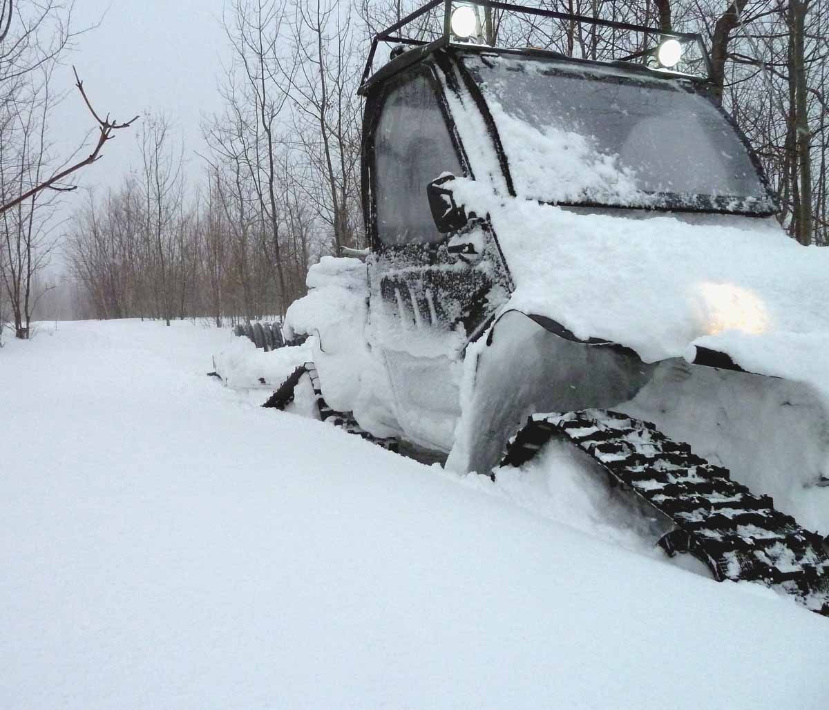

Here are pictures of machines I operated and all they ever did was tow for there lives. None had anything done to there drive lines, except maintenance. All have CVT drives.
