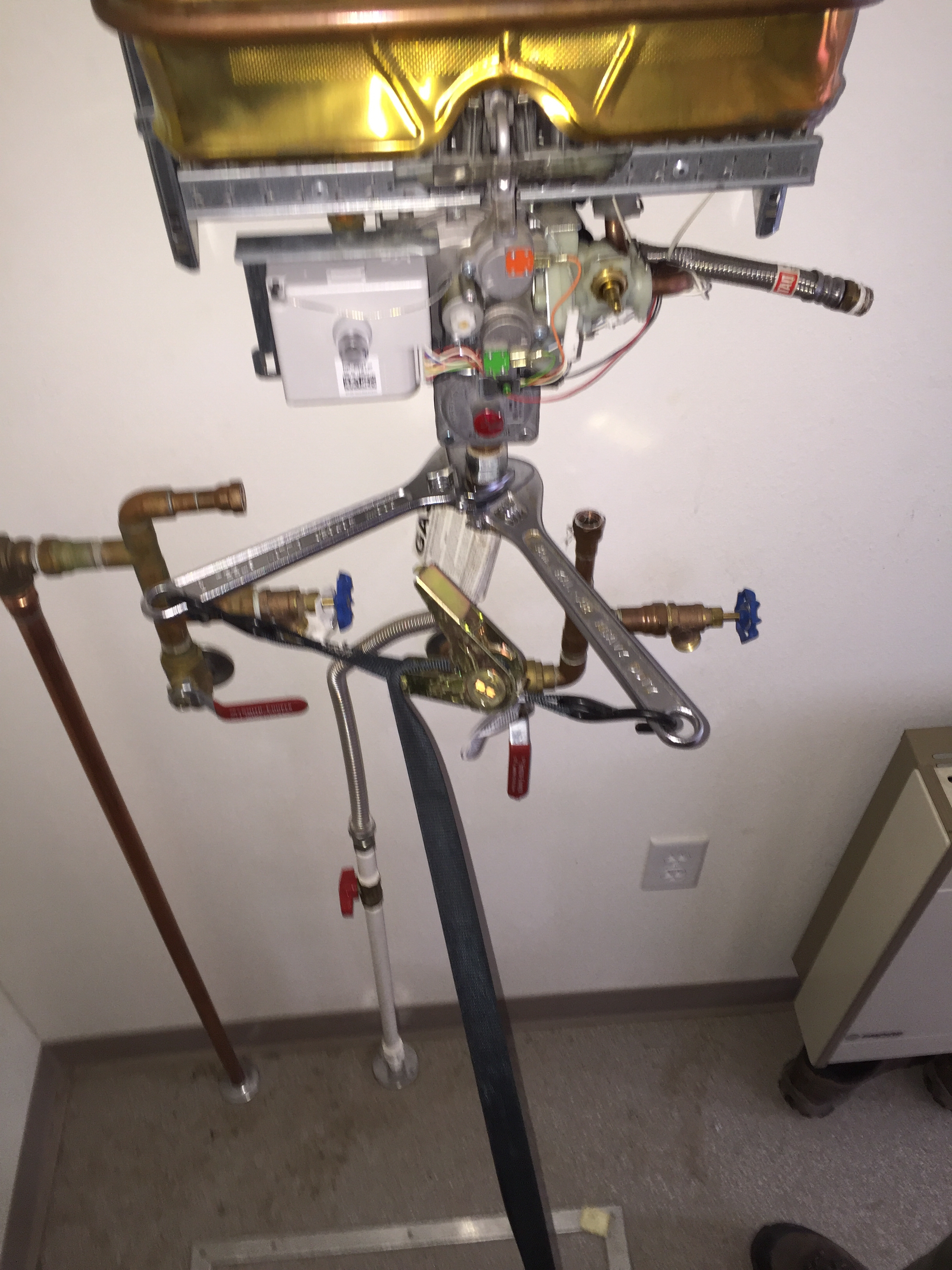

Put on two wrenches with about a 45-degree angle between them. Then add a couple of loops of paracord between the off ends, stick another shorter wrench into the loops and tighten it up.
Kind of like this except with smaller wrenches:

To clarify my earlier post: You put on the wrenches, then tension up the cord between them, until something breaks. In the photo, note that there is a ratchet strap, and it is used to apply force on the wrench ends. Two combination wrenches with the open ends on the fittings, and something to pull tension through the box ends. Smaller wrenches I use, a turn buckle with two hook ends. Really small I go to a couple of loops of paracord, with a small stick or extension to twist them and pull tension.
