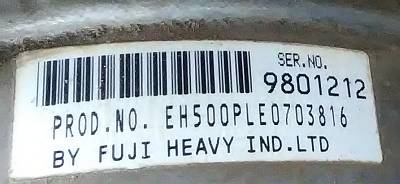

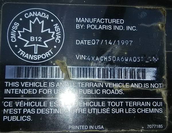

It's showing as made in '97, so does that make it a '97 or '98 model? (See tag below)

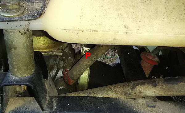

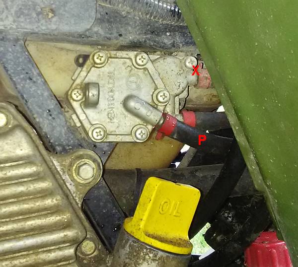

We got it to fire, sort of, but it won't stay running. Shots of ether, carb cleaner or PB Blaster small engine tuneup will get it to spit, sputter and try to run, but then stall. Tried it in a few different places, same result. Hose marked "X" below goes to a small fuel filter, then to the bottom of the carb. I have fuel flowing through to that point. Hose marked "P" below from the pump to the top of the carb .... what does that do? Vacuum to the pump? Or is fuel supposed to flow through that also? If so, it does not.

Has a fuel pump or just gravity feed?
I’d pull the carb and check the float, lost many of those in Alaska when a tiny amount of water freezes in the bowl and cracks it. Can fail open or closed. Also a could chance to soak the whole thing in carb cleaner and make sure it’s getting good fuel to it.

This won't matter though if I can't get it started. Don't know FB or gravity, see the pictures above. Might be able to pull the bar, but I'm not sure how the Choke and Throttle cables connect.

I'd say its a 97 based on date of mfg. I have a 96 or 97 Sportsman 500 (Not sure of year without going out to check the reg). If you got it cheap enough I'd pull and R&R the carb. Change oil and filt. Air filt. Possibly the belt. I bought mine last summer from an ATV repair shop that had already replaced the battery, rebuilt the carb, replaced oil, fuel, and air filters, belt, wheel bearings, and plug. I replaced the 4 tires which were bald, some dash lights and headlight that were out (all bargaining tools to get the price down). Lots of screws to remove but then body panels come off fairly easy. Then I power washed all the crap out. Looks like the mice made a home in yours.

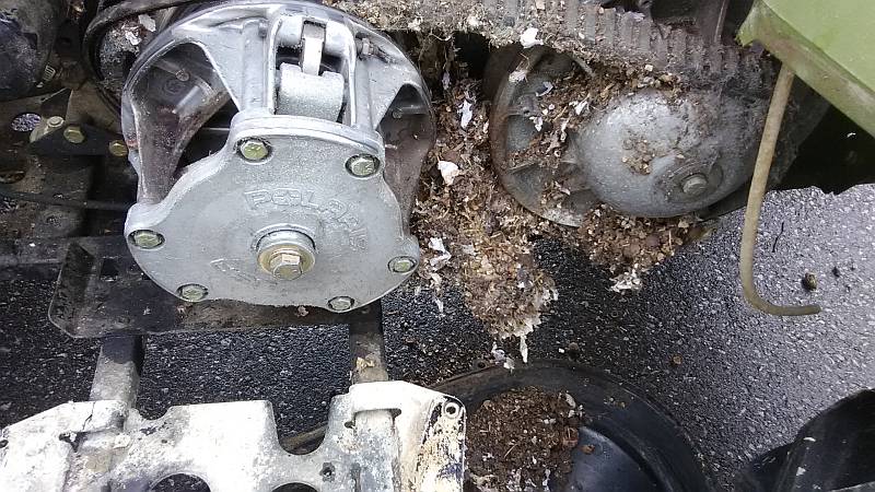

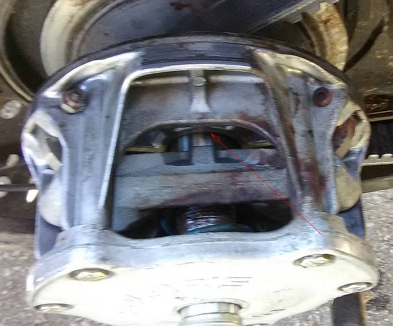

Got the belt and got it on without too much trouble. Started machine and the belt turns while at idle. Not sure it's supposed to do that. Started machine (in Neutral), dropped into Reverse and it stalled. Repeat, same thing.
Feeling is that the clutch rusted into place on the shaft and isn't sliding in/out freely. Hit it with some PB Blaster Penetrant, but I'm not sure how much (if any) I can bang/tap/thunk on the assembly to try and free it. Will let it sit for a while and try again if anybody cares to chime in.

Got it freed up. It'll move in and out now with throttle changes But as soon as you try to go into any gear, it'll stall. You cannot get into motion at all. Even taking the throttle adjustment screw on the carb down to a low idle, same thing.
There's got to be some sort of adjustment I'm missing.
/ Need to Kick a Mule. #14
Now that you have it (the centrifugal part) freed up have you tried starting it in neutral and have someone push you on the ATV then put it in gear and drive it around. Maybe the clutch disc is stuck and driving around may free it up. Just a guess here.

I've had it running and driving around for a while, but it still has issues. Main thing is overheating and hard to start. Seems the corn gas sitting in it for years mucked up a few things. Stuff seems to do more damage than good. Waiting for a few parts in shipment to see what happens next.
