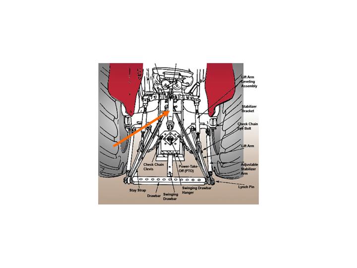

Soundguy said:
Yor orange arrow looks to be pointing to a toplink. This is a standard 'on shelf' item at virtually all farm stores and tractor dealers. They come in cat0, cat1, and cat 2 at most palces.. sometimes you can get 'long or short' in those cat sizes depending on the dealer stock.. etc.
soundguy
The 3-point hitch is a still a mystery to me/us at least until we attached something to it - so is there a leaver associated with the toplink? Thats what the pic looks like where the slot is with no leaver.

MILS153 said:
Hey here's a question Dyer - yes whilst sitting on it last night and again this morning we noticed a slot where a leaver should/would be but nothing there? Since I don't know what I'm talking about will try do describe the best I can. Right side of tractor and the diagram near the slot looked like the piece in the pic (hopefully attached). Was hoping it had something do to with a quick connect for the mid PTO snowblower soon to have attachment and that we are actually not missing something we should have.

Good morning MILS153,
I know the slot that you are talking about and suspect that it has something to do with some aftermarket add-on, because the manual doesn't even tell you what it's there for. The manual shows you the slot in a picture, but does not refer to it at all. My suspicion is that it would be something to do with a backhoe or something like that, but the tractor comes with nothing in that slot and so you are not missing anything. I had forgotten about it and my neighbor had come down to help me clean the yard during the last storm and asked me about it....thought he'd done something and a knob had fallen through or something, but it was the same slot you are referring to.

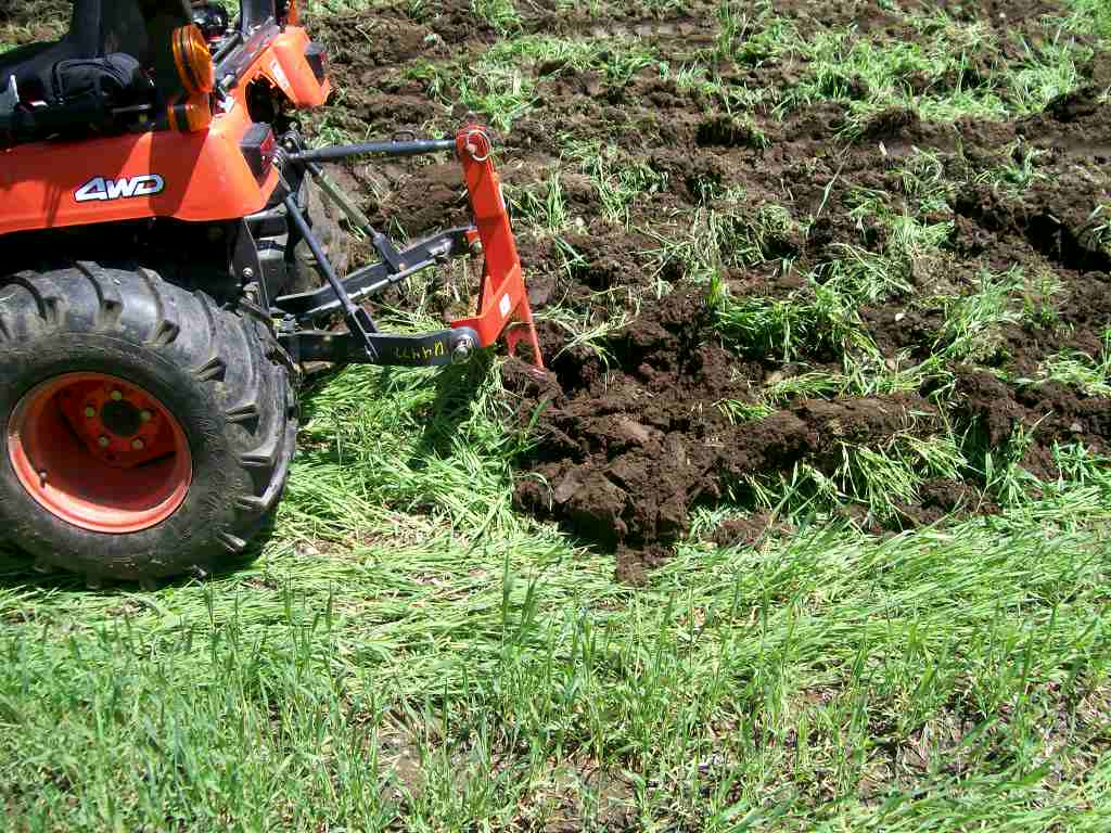

Perhaps these pictures of a middlebuster mounted to the 3pt hitch on my old BX will clarify the use of the top link. As you can see in the pictures, there is a piece that goes from the bracket you pointed to in the illustration to a rear mounted implement. It is adjustable for length so that you can change the angle of the implement relative to the ground. As others have mentioned, they come in standard lengths for a given hitch size ( you would use CAT 1) but can be had shorter ( might work better on your BX1800) or longer than standard. Hope this helps.... :)
No levers for a standard toplink.. it pins to the tractors toplink rocker and then pins to the implement..
MILS153,
I was reading the responses to this posting and wanted to make sure I wasn't misunderstanding your question. The lever immediately right of where you sit with the black handle does lift the 3-point hitch and I'm sure you already know that????? The top link really only balances what you have hooked to the lower support arms and doesn't actually do any lifting itself. It also adjusts for the implement you have, like a box scraper, to create a lesser or sharper angle as you pull the thing. The space with nothing there is also on your immediate right, but toward the rear of the tractor. I am assuming that we had this right in the first place???? John

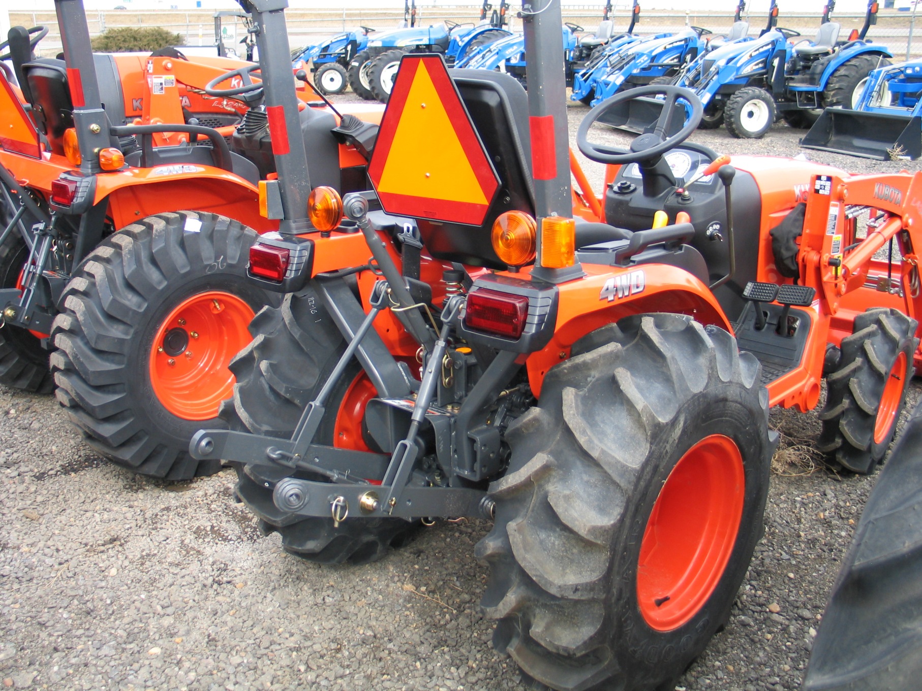

On some tractors there is a blank slot on the right hand side for the lever that would go with an optional rear hydraulic control. You can buy hydraulic top links ( since we are talking about those) for example, and you would need a lever to control how much it extended, or retracted. One possibility anyway. In this picture of a BX1850, you can see the same blank spot if I'm understanding you correctly.

Yup that's where it is next to the seat right side - funny they don't tell you that in the owners manual.

The empty slot is for the Kubota optional (dealer installed) hydraulic rear remote(s). One or two handles will come through this slot. Your dealer can tell you about the add on valves. This kit is really quite reasonably priced. Because of some issue with the backhoe it won't work on the BX24 or I'd have it!
