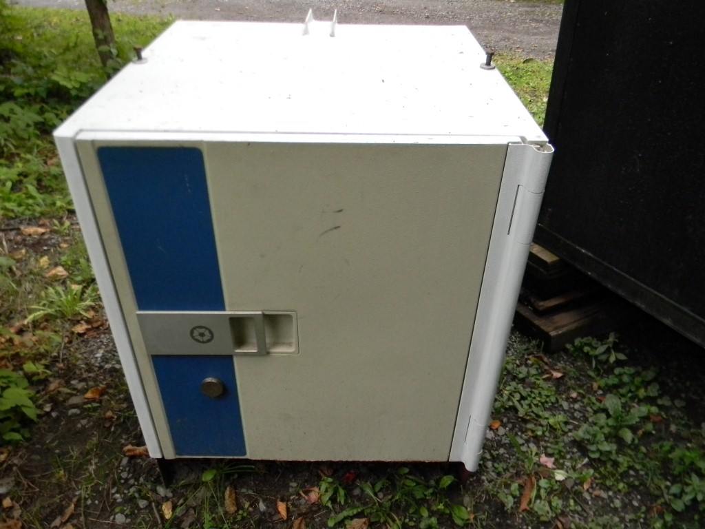

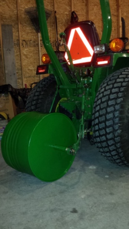

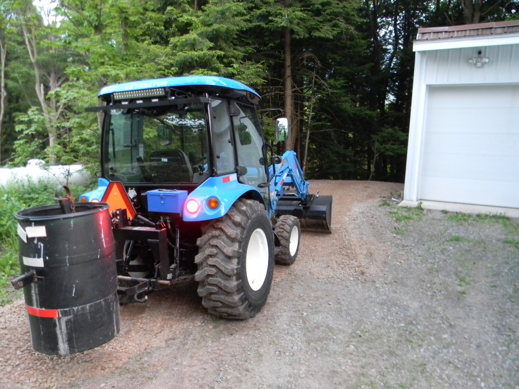

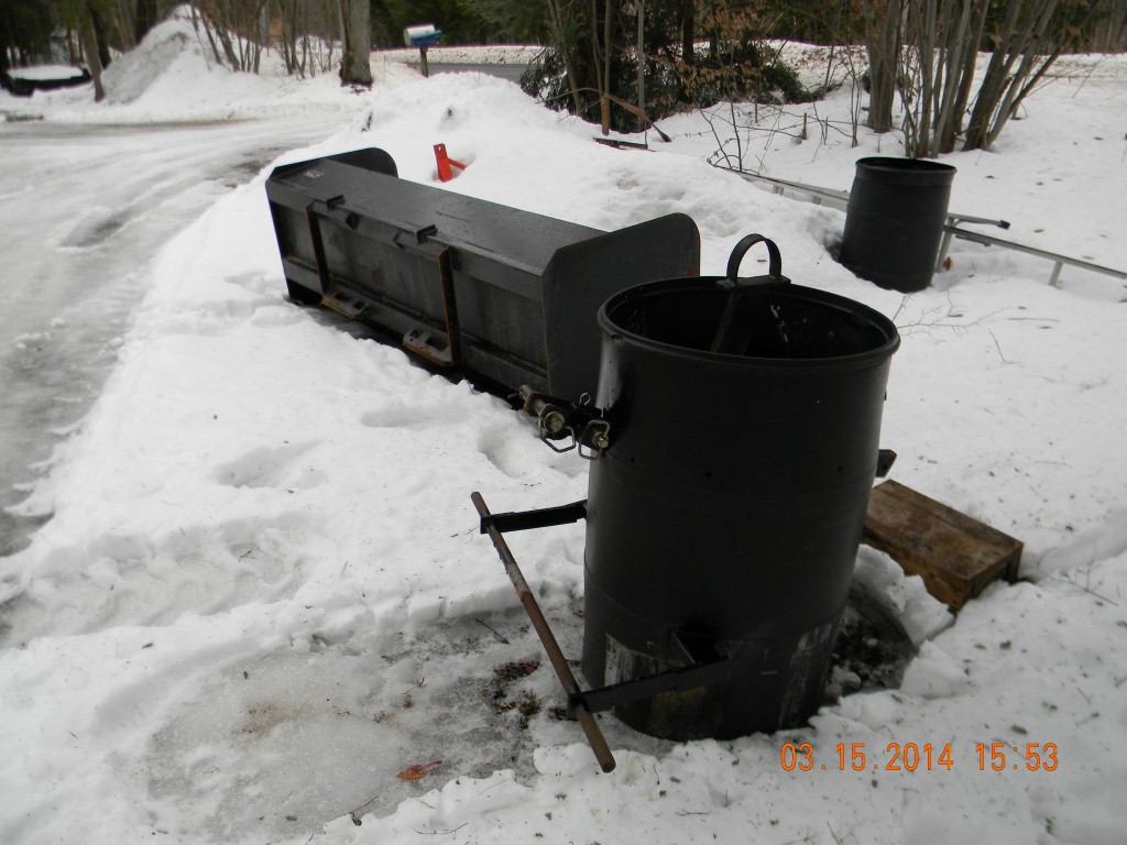

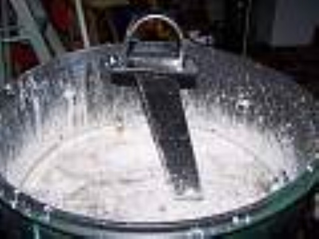

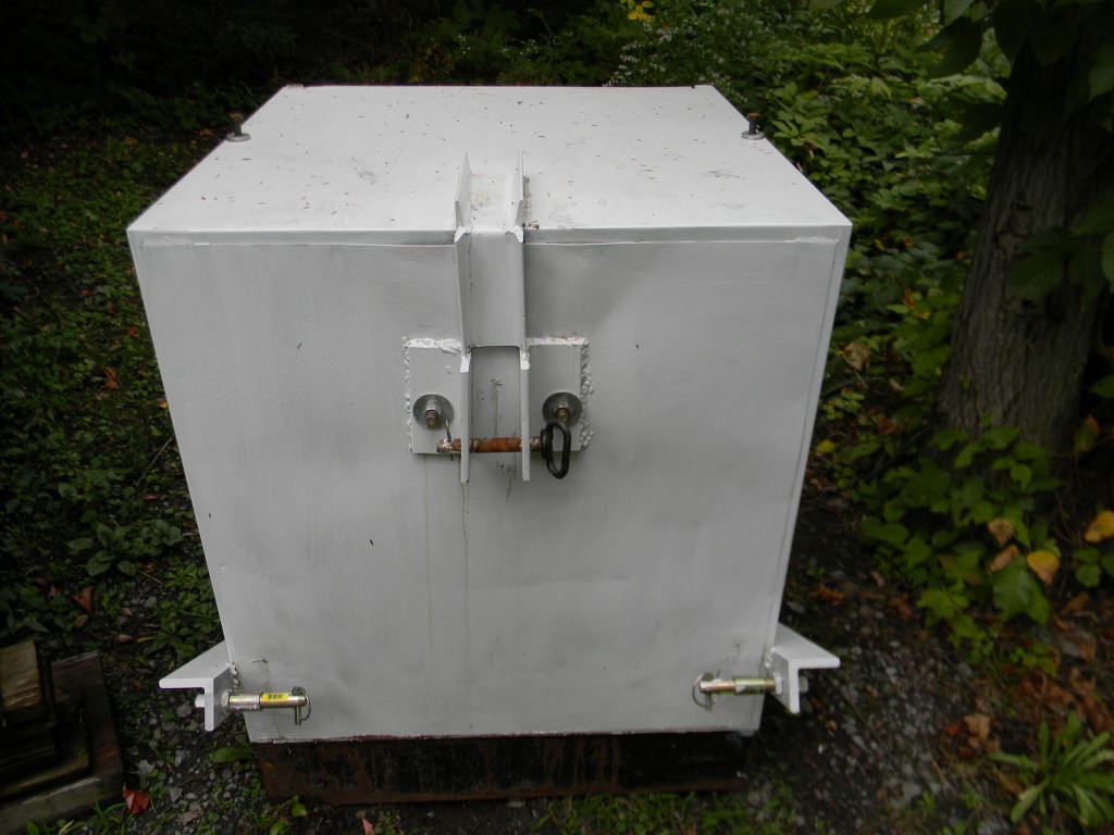

I made my previous rear ballast with a 55 gallon plastic drum. I made a frame inside the barrel out of rectangle tubing. Then welded on 3/8" flat steel and put a 1" solid bar through for the lower lift pins. The tubing comes out through the barrel where I welded on 2 pieces of flat and put a pin through for the top link. On top I added a loop to lift the barrel if I need to move it around. Distance between lower lift and top link is 18-19". Then I hand mixed 10-80lb. bags of redimix and shoveled it in the barrel. Total is 800 lb. redimix and about 50 lb. of steel.
Just a couple weeks ago I built another rear ballast out of an old safe I acquired. The safe weighs about 1200 lbs. I had tried to sell the safe on CL but didn't have any takers. I was going to sell it for scrap but decided to use it as a heavier weight.
I've attached pics of both. Send me a PM as to where you are in Upstate NY.
