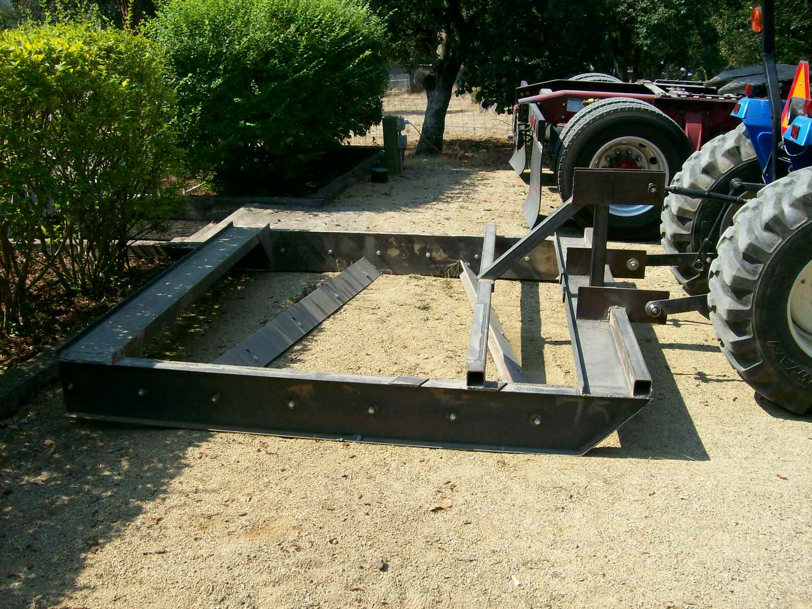

Two pictures of the one I built last year . 8' wide by roughly 9' long . I pull it behind my Tc 30 HST 4 wheel drive . 800' of driveway that starts out flat for the first third then starts up to a maximum of nearly 13% grade . Blades are set as follows . Front blade , end closest to the camera is .5" below side skid while opposite end is .25" above skid . Rear blade is set with farthest end from camera set .25" below side skid while end closest to camera is .5" above side skid . As I start down driveway , I go to right side as I am facing downhill , thus blades pull gravel from edge feathering it towards center , then rear blade slightly feathers it back maybe 1/2 way towards edge of road . Get to bottom and turn around then going up , I again hang right , doing the same .
Blades are nothing fancy , .5" x 6" flat steel , bolted to 3" x 3" x 5/16" angle . Pass down , pass back up , Crushed Blue shale is now flat , graded and smooth .
Tractor has no issue since any excess will roll over blades unlike a box blade that just loads up . First Time I used it , Did pull a lot of shale both uphill and down , but it is not like it keeps loading up rather after a certain point it will eventually start rolling over the baldes .
