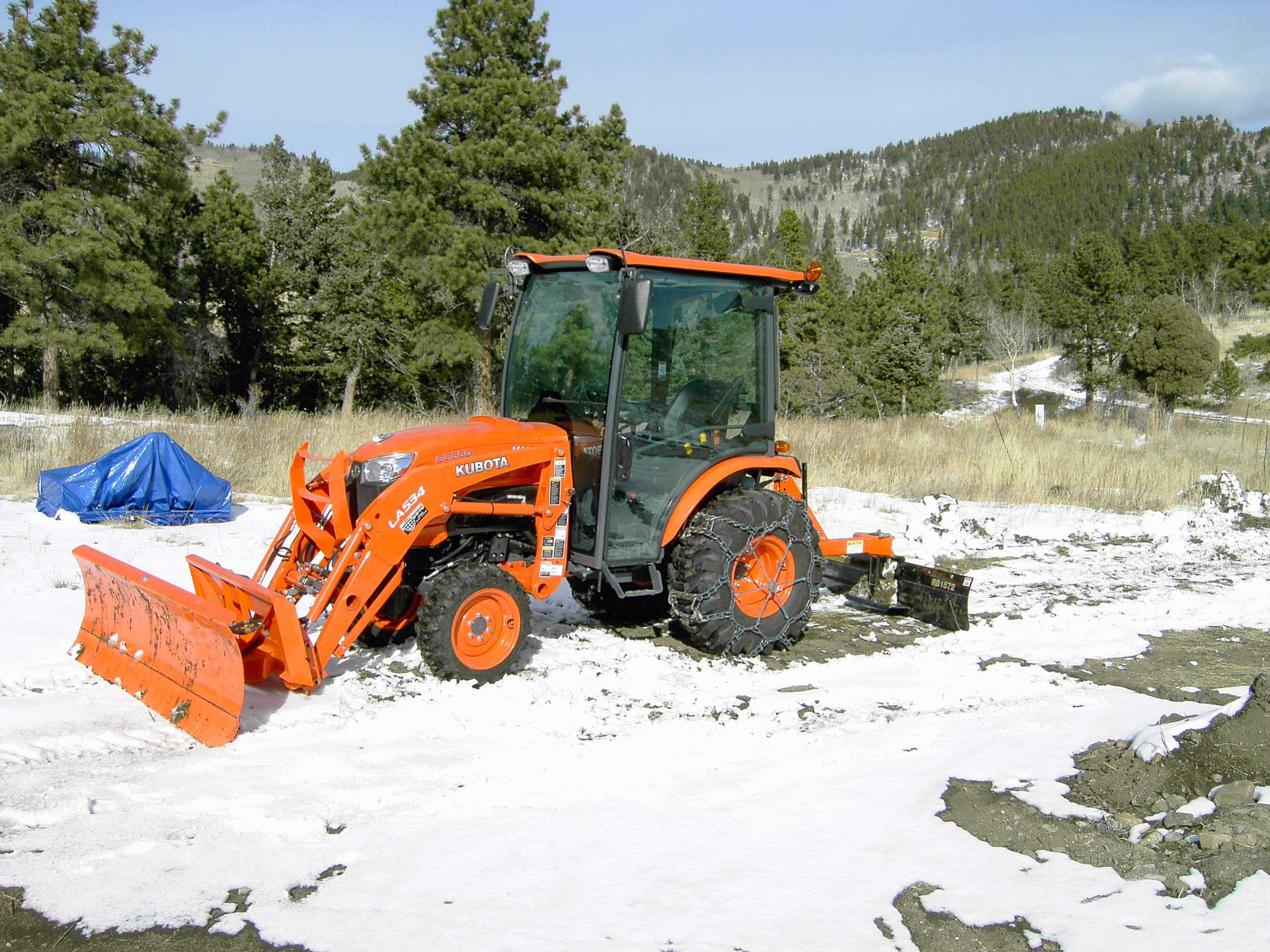

I just got a Kubota B3350 with
Front loader 60" bucket
72 Hydraulic snow blade with a 3rd function valve
72 rear blade.
The dealer was excellent and spent many hours teaching me in how to drive the tractor (I have zero experience/knoledge of tractors)
I need to clear the snow in a little less than a mile dirt road, in the mountains, with some areas of steep grade so I can get the suv to the road.
Q1 how should I orient the rear blade? with the convex part forward of backward
Q2 how should angle the rear and the front blade?
Q3 the front blade has a pin that allow the blade to be fix like dozer blade or to be floating, I set it up floating for snow correct?
Plase any tips very appreciated, even the more obvious to all of you are new to me.

Speedy,
Congratulations on your new tractor! I'm envious of the cab - at this time of year they look like a great idea.

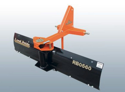

I ALWAYS have the blade reversed and lowered all the way in the "float" position. Depending on the depth of snow, I may be done or I repeat the process. I have a gravel road which is why I always have the blade reversed - I don't want the cutting edge digging in to the gravel.
Gnawbone, Thxs.
If you see the picture of my tractor I have the rear blade like you said because. the only time I tried was easy to move forward with the blade in that position without getting stuck in the gravel. a couple of the member make me aware of the dangerous to damage the rear triangle with the blade in that position (THXS)and I assume that would be the case if I use it for pushing where the blade should be in reverse, but if I only move forward and I use it as a complement of the front blade may be OK. If I understand correctly that is how you do it.
In summary if I use the rear blade in reverse I should not use it to push, If I need to push snow I should turn the tractor around and push with the front blade. Does it make sense?
BTW my rear blade is very simple and it does not have a floating position like the front one.

This year I will use the FEL, front blade and rear blade and try to learn in how to do it. I have plenty of great tips from this thread to try it. Also I need to recover ;-) not only for the tractor but also the building of the place to house it.
When I bought the tractor, I discussed the snowblower quite a lot with the dealer. These are some of the thoughts that I had then:
1. a rear push snowblower was out of the question because of the length of road to clear (1 miles). I though to use a rear camera but again not for that distance.
2. Except for two small areas I should be able with the front blade to clear the snow most of the time and the front blade would be faster than the snow blower (?)
3. These two small areas if they become a problem I can use the FEL.
4. The front blade together with a box scraper I got, would be a good combo to maintain the road during the warm season.

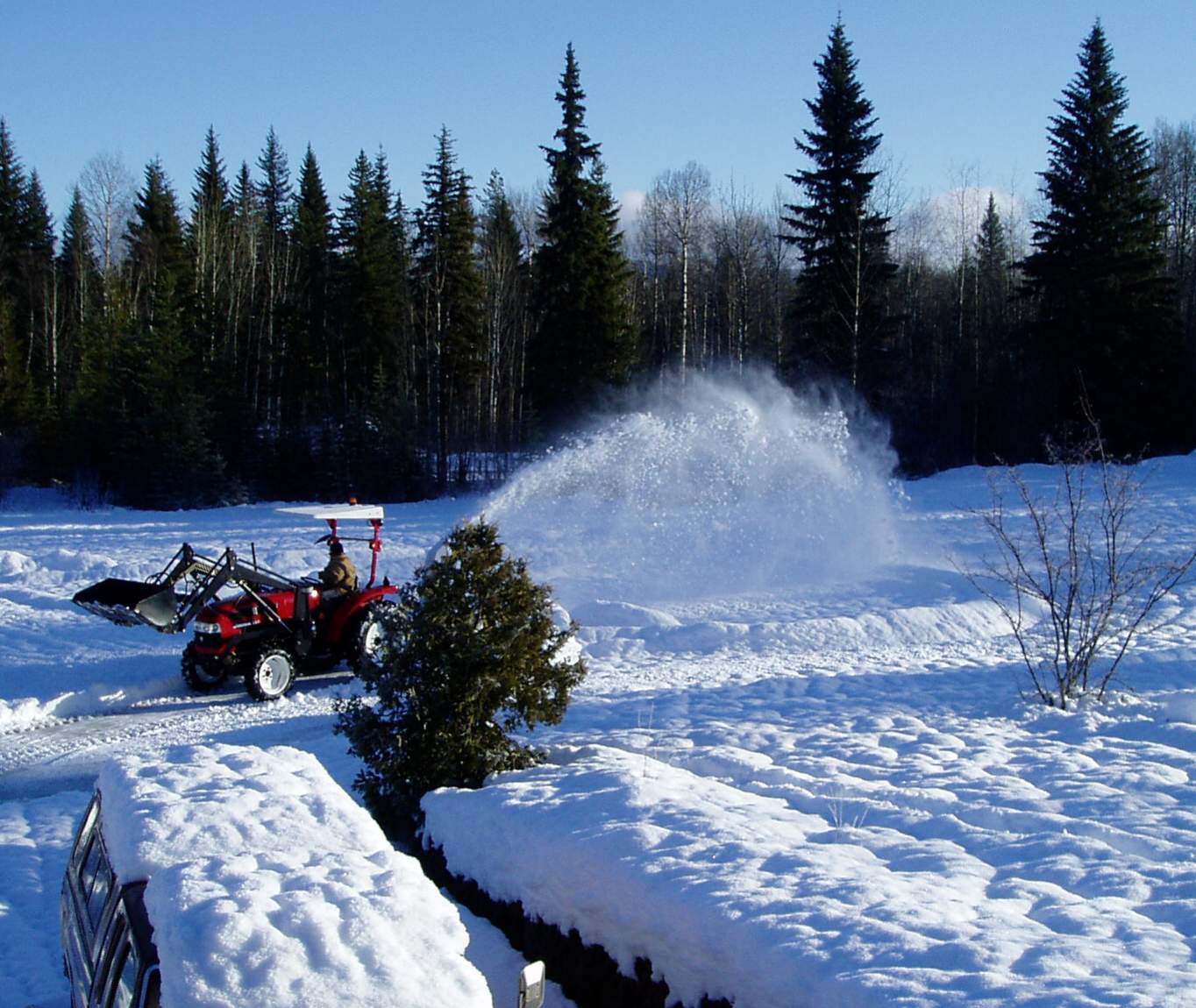

A little on my blower setup.
As others have said, the rear push blower is the most economical to buy and works well. That is what I use on my 1200 ft. plus 600 ft. driveway (two I clear) and I thought I would have problems going backwards. You soon get used to it and I find sitting sideways on the seat pretty much allows for reasonable operation. I don't find it a problem other than the fact that I have an open station tractor and end up covered in snow after each clearing and very cold.
For me my setup works just fine but I have a larger tractor at 55hp - anything smaller will find clearing a mile of driveway, very challenging.
I think it is worth mentioning that the pull type rear mounted blowers may not be that good if you have to go through snow drifts of 24" more. The tractor has to get through the drifts first before the blower can do it's job ! For me that would not be very practical and would test the tractor build/construction severely IMO.
A solution that might work for you would be the front mount blower (most expensive of the types) if you have the mid PTO to drive it. The rear blade would help as well of course.
The real beauty of the snow blower is the snow is blown off of the driveway into the bush and does not become a problem later on as the snow builds up. I also have a JD450 and find that the blower out performs the JD450. The blower is slower but does a better job. My equipment is old but it gets the job done. Have attached photo's of what I have to show you how it works. The blower works best with a minimum of 12" of snow or more - picture shows less than that hence the puny discharge plume which can reach 40' or more.
Hope this helps you with your situation.
Cheers
When you drop your 3-pt hitch all the way, any implement on there will "float", since the hitch provides no actual downforce. It's just the weight of the implement that holds it down, so it will be able to ride/float over terrain just like a front bucket would if you push the loader lever forward past the detent into float position. Almost all ground-engaging implements get used in a float position, allowing gravity to keep them in contact with the ground. Same for a rear blade being used to plow snow.
I don't expect your front plow has a float mechanism other than what would be provided by the front loader arms if you push the lever forward into float. Most likely it's actually a "trip" mechanism to prevent damage if the plow hits something immovable. And it can probably be locked for cases where you want the plow to be rigid, like when plowing loose soil, etc.
/ Need snow removal help #40
You are right Jim it will be some what of a challenge but being retired he may have the time to do it . His tractor with the right set up will be fine if time isn't a problem . We have had 2 large storms here already and I"ll grab the 2650 heated cab over the M5700 anyday . It usually takes me about 2 hrs. with the 5700 for a big storm and with the 2650 it isn't much longer than that . Other than both have blowers ,one has the fel and the other a back blade . If you can do 1000 ft. you can do 5000 ,it is just going take lots of time for those big storms .
