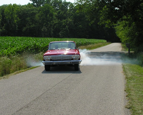

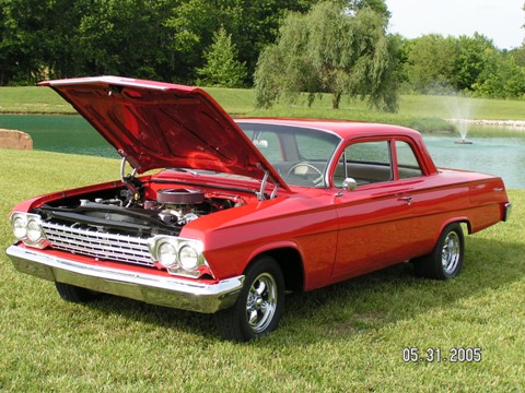

I have a '62 Biscayne with a 625 hp 502ci. During the 5 year frame off restoration, I did plenty of welding on the frame to strengthen things up. That's where I had to have some very precise cuts and darn "pretty" welds that would be strong. If you know those old cars, I had to take out the carrier bearing and tie the "X" frame together along with building a 4 link rear suspension.
I do have a "burn out" pic, but my photographer (my son) was too much "wow" and waited until half the car was hidden in tire smoke.

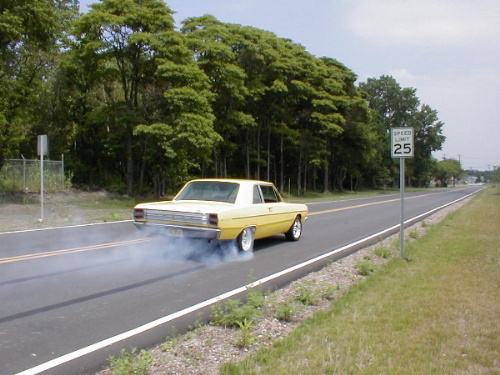

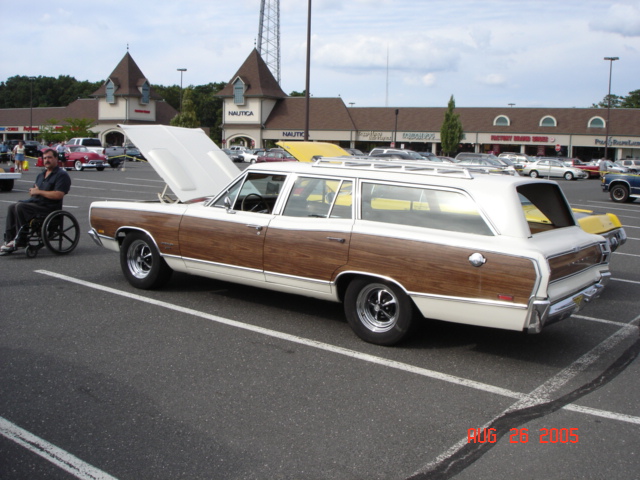

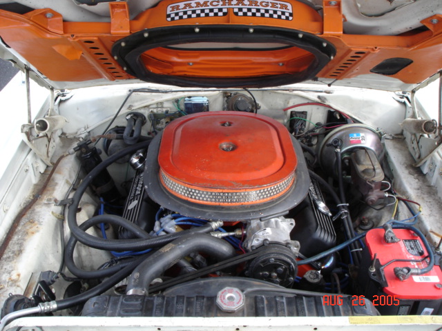

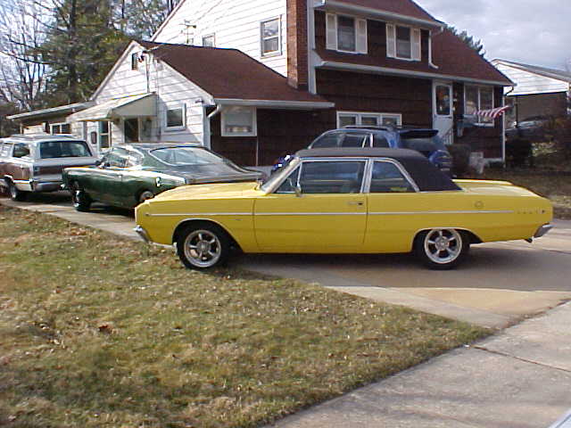

My car is a '68 Dart 2dr sedan built as a canyon carver (mild 360 maybe 400 HP, A-518 4spd AOD, 3.91:1 8.75" LSD rear, & lots & lots of steering & suspension up-grades using bigger car parts). My brother has the "fire breather," a 69 Coronet 500 wagon with a 550HP 590 TQ 493 (4.15" stroke 440), PS, PDB, A/C. Just got done converting from vacuum booster to Chevy 1500 hydra-boost, but still need to swap out the old 8.75" rear for a Dana 60, Cal-tracks & mono-leafs, but it does go for the occasional bomb through the back roads & to the local cruise-in until all the rear parts are purchased(new rear & leafs are here, waiting on the bars & driveshaft). After the rear is swapped, we'll get some 1/4 mile numbers.
BTW, that pic of my car was taken 2 days after getting it on the road. I think it had 30 miles on it... 2 weeks later I drove it to Carlisle, Pa (150+ miles each way) both Saturday & Sunday. The only part of the drivetrain, steering, suspension & brakes I DIDN'T change was the steering column & brake pedal.
