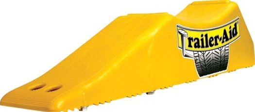

ST tires have thicker sidewalls so they do not sway as much, but they are more susceptible to blowouts because they heat up easier if you have any with lower pressure, heavy loads, or drive fast. That will factor into your decision, because you know yourself. Are you meticulous enough to always check pressure before you go? Are you going to stay off the highway? Will you never over load it? If so, ST tires may be fine for you. I have had two horse trailers over the last ten years and both were moved from trailer tires to LT's because after 4 or 5 blowouts on the highway I was done with ST's. I keep the pressure good, but I also drive 70-75 MPH. I do multiple trips per year that are 1500-2000 km each way and 100-400 km trips every second weekend during the show season, so I am certainly not going to drive 55-60 MPH the whole way.
As far as spares go, I have two full spares on rims because if you are halfway through a long trip and you get a blowout, are you going to do the last 1000 kms with no spare? Not easy to stop for an hour and get a new tire on the rim while horses are on the trailer (when you stop they get restless and start kicking) and besides we often drive through the night by tag team driving. I also keep a full can of diesel in the back of the truck because open stations can be spotty at night.
As far as jacks go, the bottle jack from my HD truck would work but I never use it for the trailer. With a dual axle trailer you want a trailer aid, it is way better.
You just drive the non-blown tire onto the ramp and change the other one. 30 seconds up and down, no jacking or cranking on the side of the road while people fly by 5 feet from you. The last time I had a blow out I was pulling back on the road and my wife looked at me and said "That was 14 minutes! Nice work!" Probably half of that time was getting the spare down from the bracket under the gooseneck. I also have a four sided lug wrench because they give you better torque and are faster to spin off the nuts. plus it has a pry end to get the wheel covers off.
