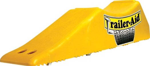

As far as jacks go, the bottle jack from my HD truck would work but I never use it for the trailer. With a dual axle trailer you want a trailer aid, it is way better.
You just drive the non-blown tire onto the ramp and change the other one. 30 seconds up and down, no jacking or cranking on the side of the road while people fly by 5 feet from you. The last time I had a blow out I was pulling back on the road and my wife looked at me and said "That was 14 minutes! Nice work!" Probably half of that time was getting the spare down from the bracket under the gooseneck. I also have a four sided lug wrench because they give you better torque and are faster to spin off the nuts. plus it has a pry end to get the wheel covers off.
