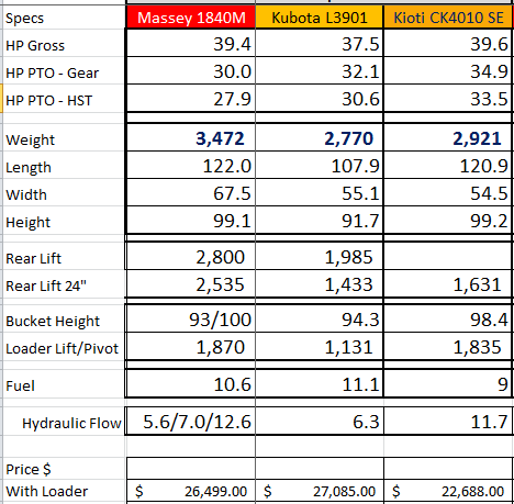

Kioti CK4010 or DK4510 are good choices.
From late spring, last year:
The 6.3 gpm on the Kubota seemed awful low so I checked. That is just for the main pump, there's another 3.8 for PS, so 10.1.
A Deere 3039R would be fairly comparable to an L3901 but the Deere has a little stronger loader and is a couple hundred pounds heavier. Plus it's fitted out as a deluxe tractor with electronic hydro, etc.

Branson, LS and Kioti all make at least one model that competes. I found the L01 series to be pretty bare bones in terms of features. For example one feature I wanted was independent PTO so I would not have to get on the tractor to turn the PTO on and off like I did on my previous tractor. That's a pain when operating a PTO chipper or forestry winch.
Adding the regular and steering GPMs together is pretty much meaningless as they are never used together. It makes a bigger number though, that's why manufacturers do it. Most CUTS don't have enough hydraulic flow to do work like running a hydraulic mower or brush cutter or snow blower. That's skid steer territory of 20gpm and up. All CUTS really need is enough to run a loader or backhoe.

Adding the regular and steering GPMs together is pretty much meaningless as they are never used together. It makes a bigger number though, that's why manufacturers do it....
Of total flow, about 4 gpm is used for PS on tractors this size, the rest for everything else. The chart IndyJay posted shows Kioti's total gpm including PS, while only Kubota's w/o PS.
/ Need L3901 alternatives #16
The spreadsheet evolved over a period of several weeks/months, before I even joined TBN. I started out comparing Kubota and JD. As I added more tractors to the list I started adding more details. I never really thought that I would be sharing the information so I didn't necessarily go back and fill in missing or incomplete data, especially as I narrowed down choices (like going to a larger frame and HP). Since I have shared this a few times and may again in the future I will make corrections to the Hydro capacities. There was no intent to deceive, just plugging in numbers as I found them on Tractor Data at the time.
I wish I had kept the green and blue tractors in the spreadsheets. I didn't think I would ever have use for the information again once I narrowed down my choices.
