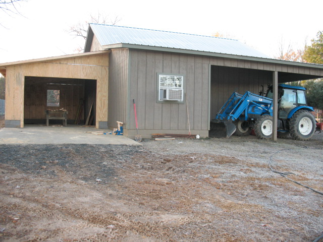

I dont like blown in insulation as it settles too much. In a year, you will have a void at the top. I have 6" bat in my house with 15" of blown in fiberglass on top when new and it is less than 12 after 1 1/2 years. I prefer the fiberglass batts or foam. I used the 6" R-19 bats in my shop in walls and ceiling with insulated garage doors and a 1500 watt heater will keep it as warm as you like. I have one in it now on low heat (750 watt) and with 25F outside this morning it is nice and warm inside and the heater thermostat had it cut off. I also have the reflective insulated boards under the galvalume roofing which helps keep it cooler in summer. I have it sealed in the ceiling(9' 8" height) and walls with 3/8' plywood inside and 1/2" exterior grade plywood outside so there is some insulating value to the wood compared to sheet metal siding or vinyl. Attached photo of shop with currently under construction 14 x 30 addition for boat/ lawnmower storage. I dont plan to insulate this portion right away, maybe later if it starts getting too hot in summer.

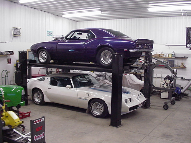

I live in the same area as you and I insulated our 40X 60 X 12 Shop with spray foam on all walls and 14" of blown in cellulose in the ceiling. The interior is finished off with white metal like the above picture. Although the cost of the foam was higher than the other options, it was the best option for me. It made the walls more rigid, it doesn't have the condensation problem that other insulation has because of contact with the exterior metal walls, and it seals all air gaps. I just installed a 100K btu propane furnace this week and it will heat the shop up from 45 deg to 60 deg within 10 minutes and the furnace won't kick back on for 30-40 minutes. And that's with an outside temp in the mid 20's!
If I were to do it all over again, I would definitely use spray foam again. It does cost more up front but the energy savings are worth it.
