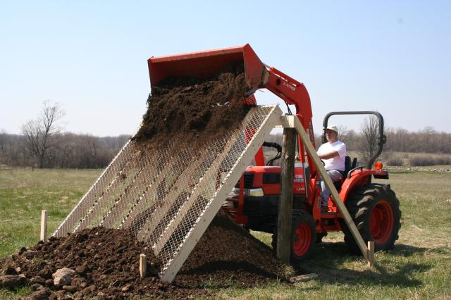

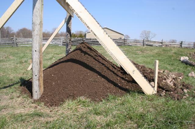

Here is a really simple screen I made using heavy duty 1-1/2 inch chain link fence and a few 2x4s and 2x6s. I have used it to screen about 100 yrd of soil so far this summer. I have screened out lots of large rocks some weighing more than 50lbs without any damage to the chain link fencing. Sod is the biggest pain in the neck because it does not slide down the screen very well.

   / Need Ideas: Rock Screen to Filter Topsoil. #12
</font><font color="blue" class="small">( Here is a really simple screen I made using heavy duty 1-1/2 inch chain link fence and a few 2x4s and 2x6s. I have used it to screen about 100 yrd of soil so far this summer. I have screened out lots of large rocks some weighing more than 50lbs without any damage to the chain link fencing. Sod is the biggest pain in the neck because it does not slide down the screen very well. )</font>
How
long wide and high is it?
How much wider than your FEL bucket is it?
   / Need Ideas: Rock Screen to Filter Topsoil. #13
It is 7' wide by 10' long.

   / Need Ideas: Rock Screen to Filter Topsoil. #14
</font><font color="blue" class="small">( It is 7' wide by 10' long. )</font>
Thanks for the information!
Do you leave it set where it is in your picture or do you take it down and move it around from place to place?
Your tractor is quite a bit bigger than my BX 23 so I'm thinking of going with 8' long by 5' wide. Do you think this size would work with my smaller BX 23 ?
I'm trying to keep it as small and light as possible to accommodate ease of portability.
Thanks again you've been most helpful.
   / Need Ideas: Rock Screen to Filter Topsoil. #15
I leave this one where it is. I do have more chain link fence available and am thinking of building a smaller portable screen. I know it will be a while before I get around to doing it.

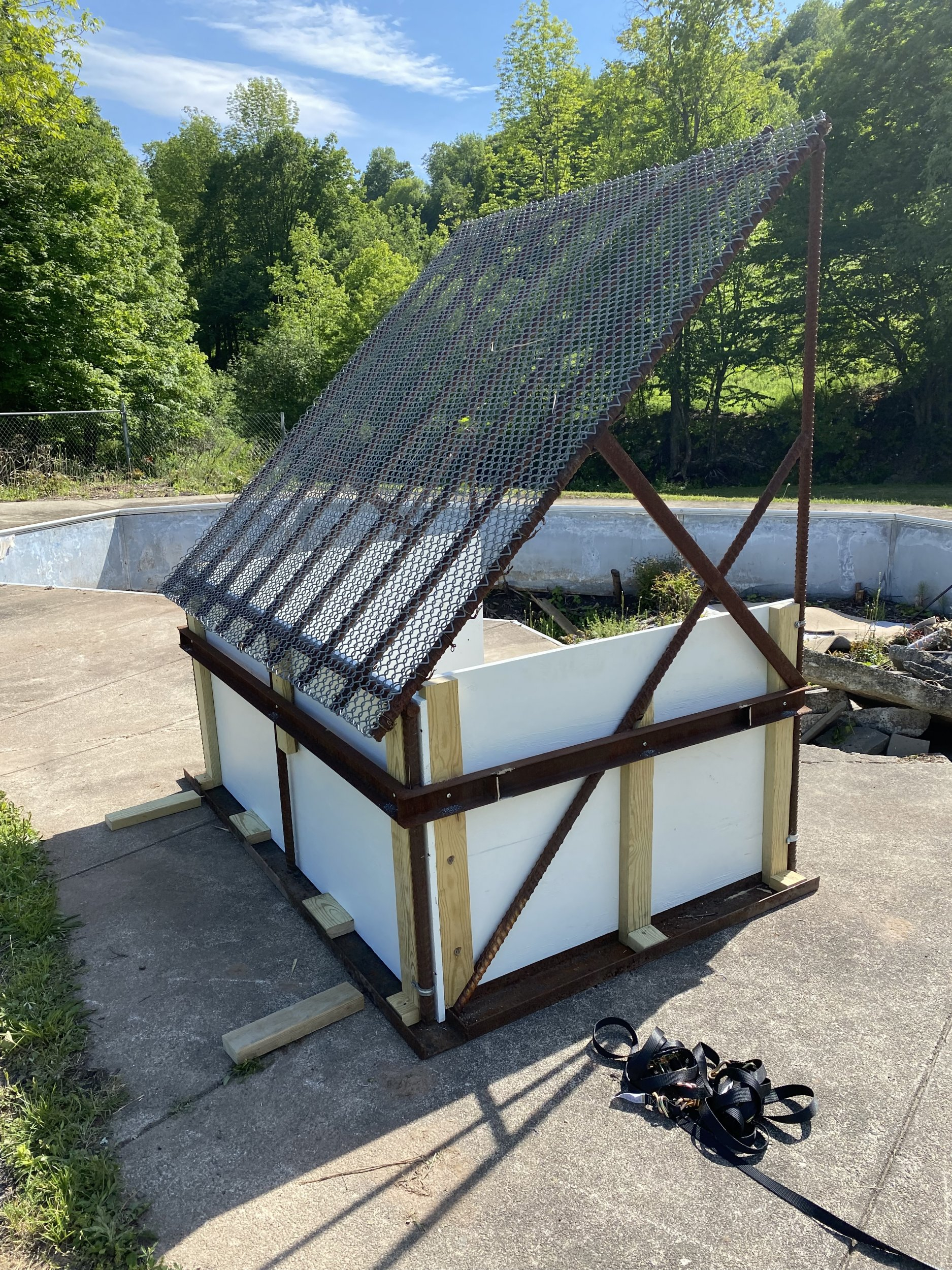

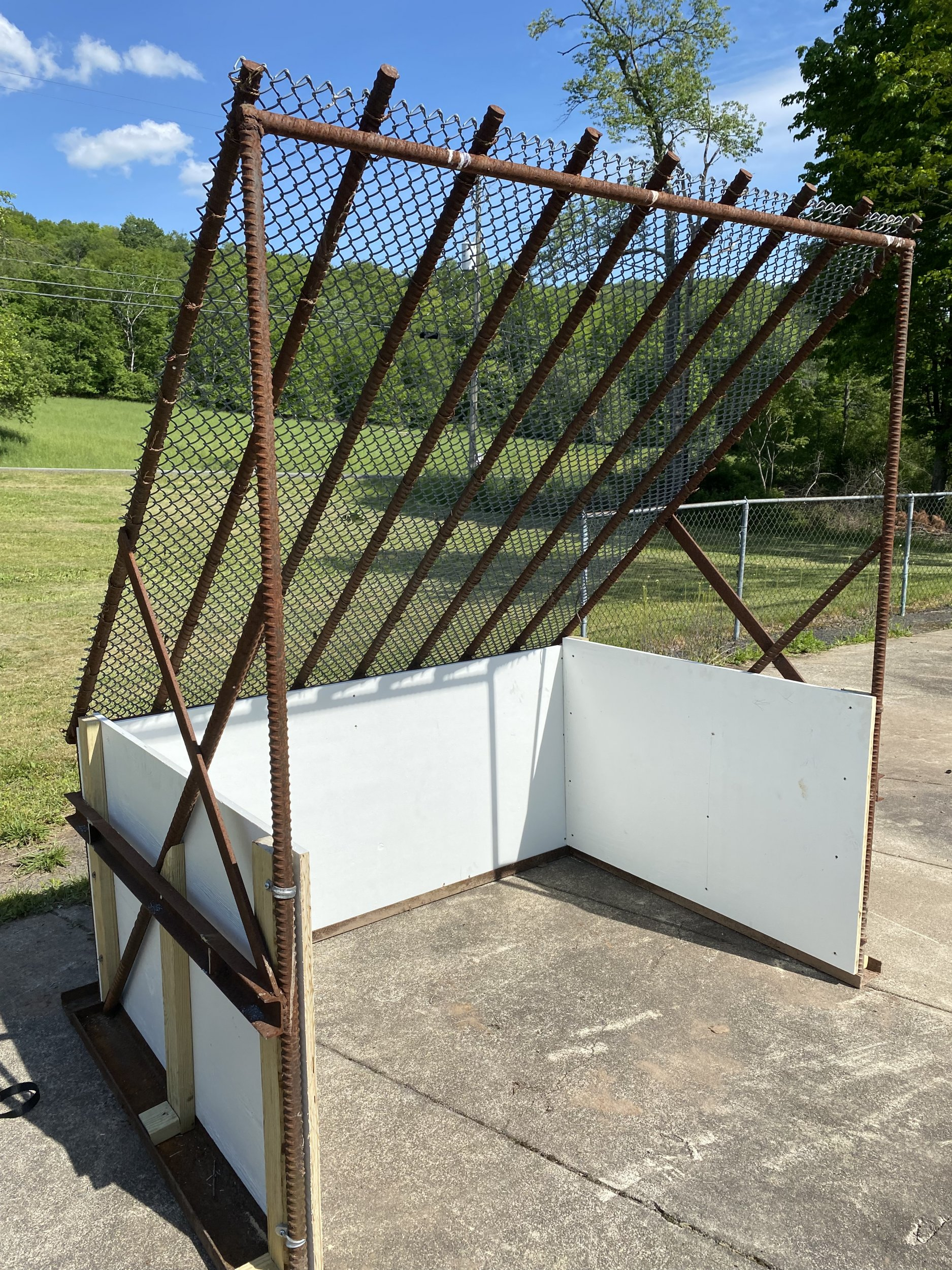

   / Need Ideas: Rock Screen to Filter Topsoil. #19
#11 rebar. 4” c channel. High security chain
Link fence ( small holes ) 64” wide I used my 5’ bucket with teeth to screen
