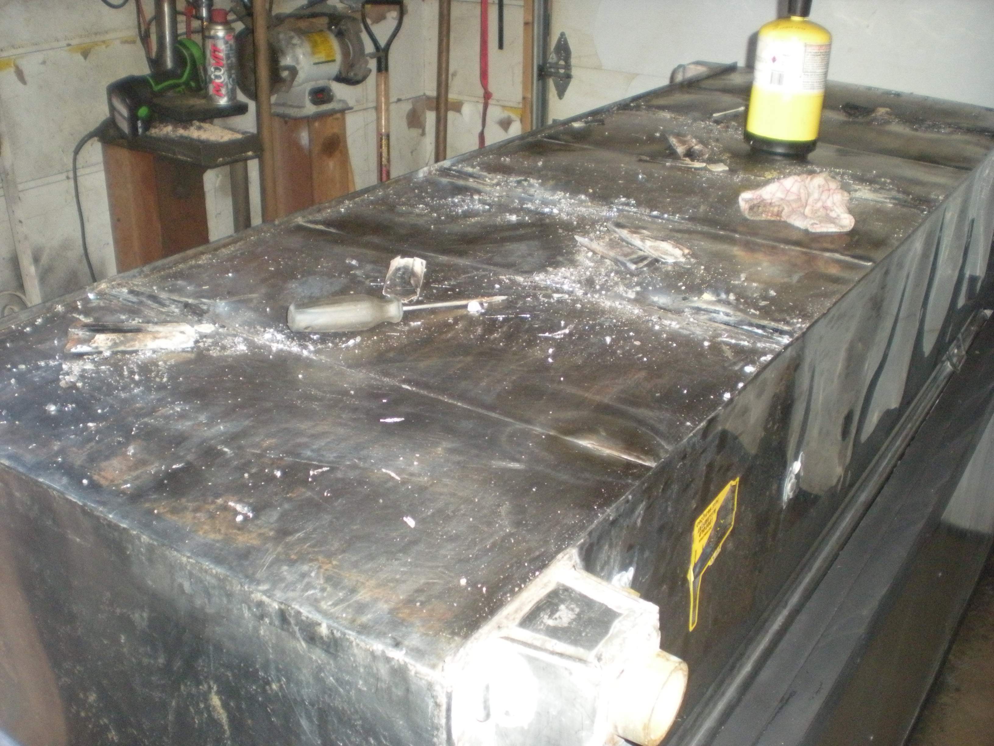

Yeah you will want a properly fitted respirator with P100 filters for any serious work with lead, a well-ventilated area and keep people far away - especially kids. In vapor form like will inevitably happen from heating it to get it out, it is very toxic.
It would be far safer to cut out the joints with lead and discard them (NOT with a torch!!), then reweld/braze the unit.

I used to sell a product that was ground up 56% silver solder in a paste. You could heat and melt out the lead and brush in the paste. Heat and it will flow and stick to the joint. Cool stuff. Or if you use a flux coated silver rod, It will push out the lead and take over the seam. You will still have some lead no matter what you do. Tig option is good as well.

I would assume your pans are 16 gauge at the thickest, if not thinner. Stainless will warp like crazy with too much heat. Keep it as cool a possible when melting off the old solder. I would suggest silver solder. Without seeing your project I would bet a ss electrode would be too hot. And without seeing the joint tig welding could be impractical. You would need to remove all the old solder, I don't think soft solder and silver solder will mix.

I think if it was me I would just use a .040 cut off wheel in a 4 1/2" grinder and cut the corners off (everything with any lead on it). Say like an inch in. A sheet metal shop could bend up a piece of stainless (say 1 1/2" by 1 1/2" so you have overlap) and then you could just weld in new corners. I would weld it on the inside so there's no seams to help make cleaning easier.

i talked to all our sheeet metal and welding shops today..They told me to remove most of the solder. solder with lead free over the the joints..One shop told me to make new pans .they would make the pans for 5500.00 wow.I found a shop that will mig the joints today but i have to remove all the solder..so this week end i will be removing solder

my computer wont upload pics...sorry..he told me 5500.00 for two pans..there not even fluted..rip off....I'm trying to get most of the solder out of the bottom and we'll weld 1 inch strips over the seams where the solder was..Then flip it over and do the inside with lead free...Why they used solder for these pans I'll never know..all the joints on the bottom leaks ....,well the good theing about it i got the whole unit for 1000.00.plus shipping 350.00..so I guess i can spend another 500.00 to fix it..going to make a hood and preheater while i'm at it
