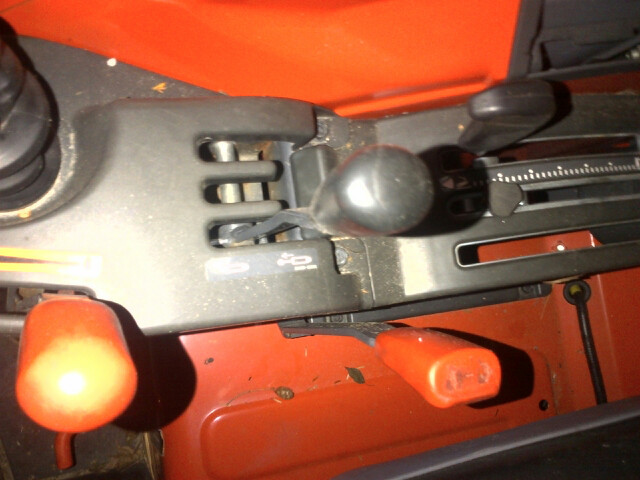

Hello,
I bought a new (used) tractor and it has remotes at the front and rear (see pics).
I have done some research on this site and others and I still do not have a tight handle on how my specific remotes work.
My tractor is a 2012 Kubota M5140. I thought I was fairly intelligent...I was wrong. I understand what the remotes do in general, but I am confused on the different types (detent-how do you know/findout), their function, and how to operate them.
There is a picture of the loader controls and the front remotes. I believe the small white button activates the front remotes and then the 2 black buttons control the flow. I am not exactly sure how. Can anyone explain. I am hoping to hook up a plow and control the direction with these.
Then at the rear there are another set that I believe are controlled with the lever pictured, but I do not know how.
There is also a single hydraulic hose by itself that I do not know what it is for or how it works.
Finally there are connections for the backhoe that were hooked up upon purchase so I understand how the connect and operate. From reading the manual I read that these connections need to be hooked together when not hooked to backhoe (no picture).
I would greatly appreciate any help.:confused:

On the rear remotes, notice the sticker that shows how to connect a cylinder to the quick couplers. Left is piston side of the cylinder, right is the rod end of the cylinder. The lever activates the rear remotes. Notice it has a sticker showing a cylinder and which way to move the lever to extend or retract the cylinder. Detents will be built into the valve (if you have any), if the lever returns when released when moved to end of travel in each direction you do not have detents.
The loader control should have a detent for float of the boom (joystick all the way forward.)
Hard to tell about the front remotes without tracing the lines. Same for the single rear line. Your front remotes could use a diverter valve that uses the dump/curl circuit, but then it would not need the two black buttons. You may have a third function valve that is electrically controlled using the two black buttons. That would not need the white button.

From some more research it looks like the white button does activate the third function remote up front. The black buttons then control the direction of the flow.
The side lever controls the rear set. You can push or pull the lever and if you push or pull harder the lever locks in.

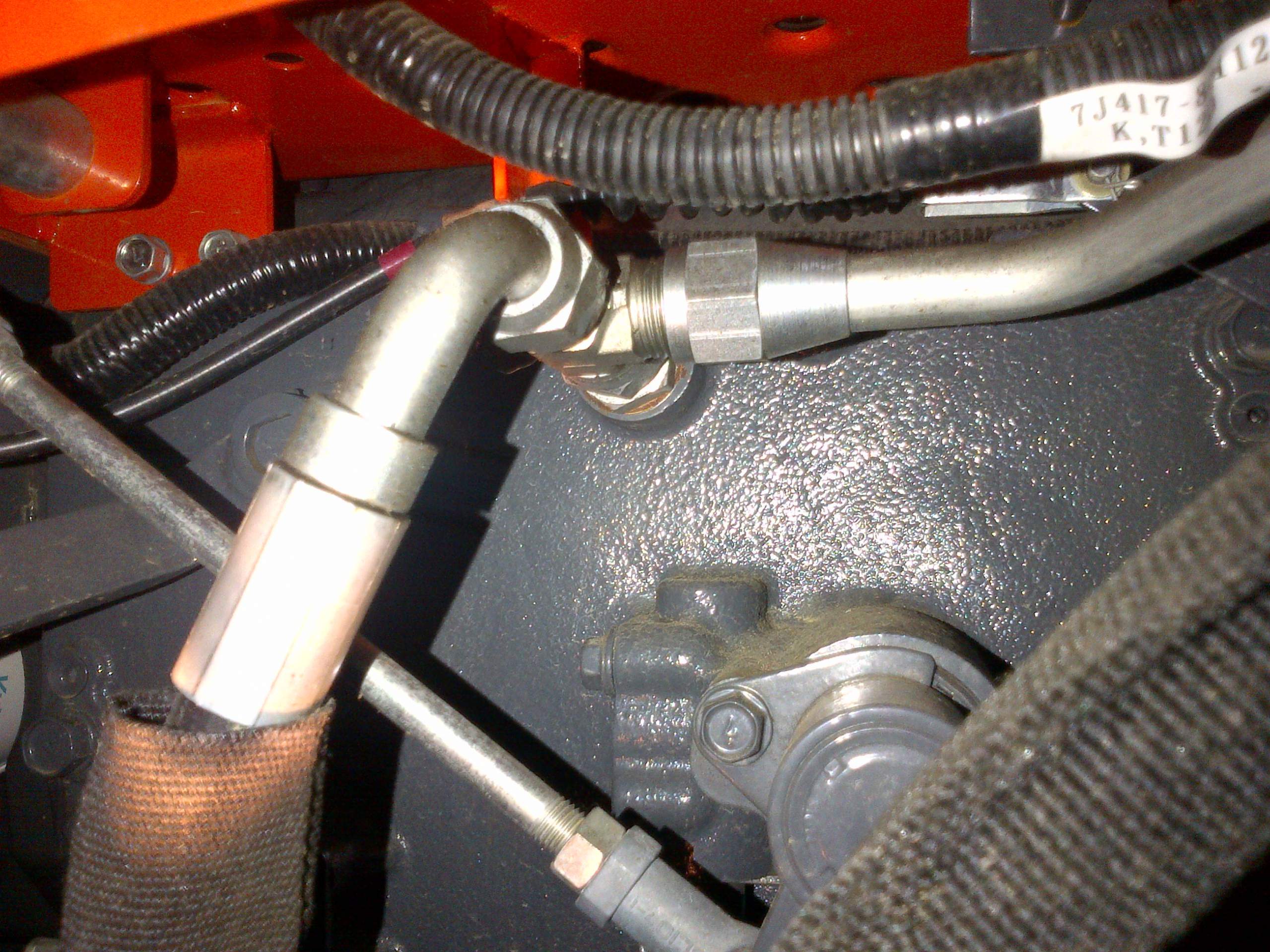

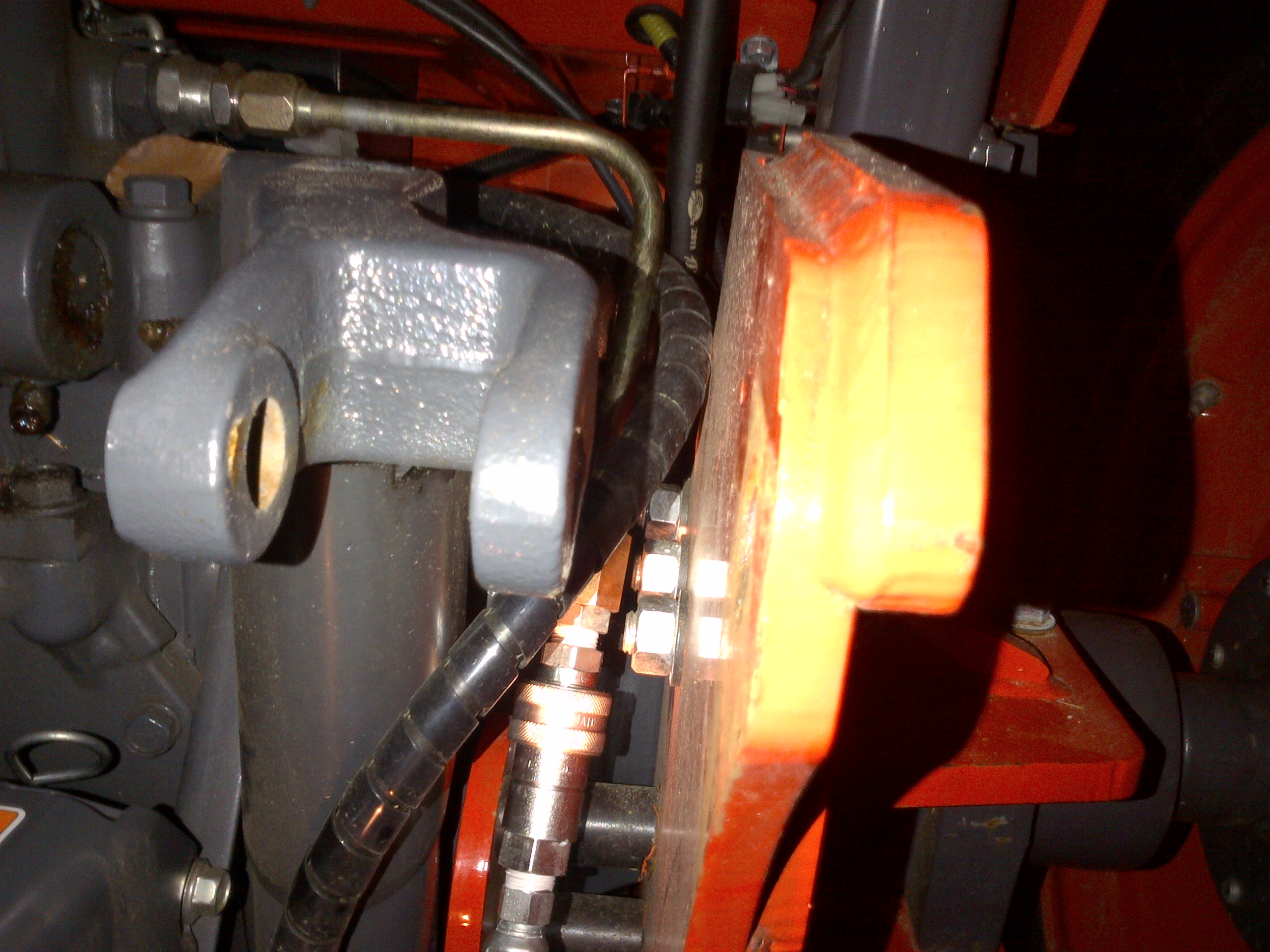

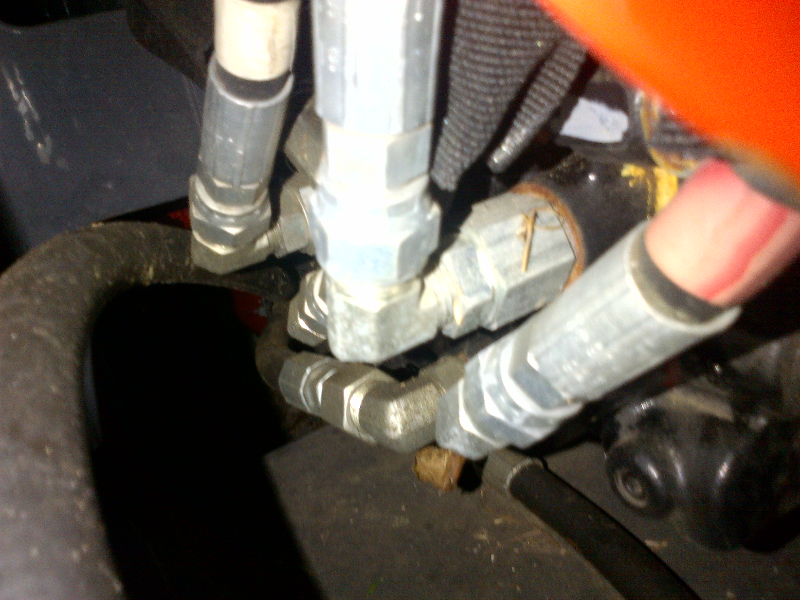

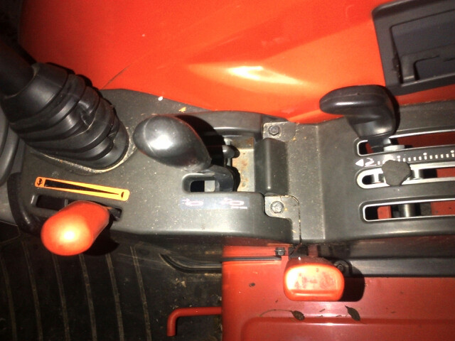

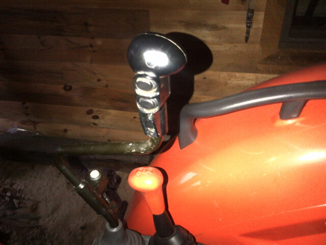

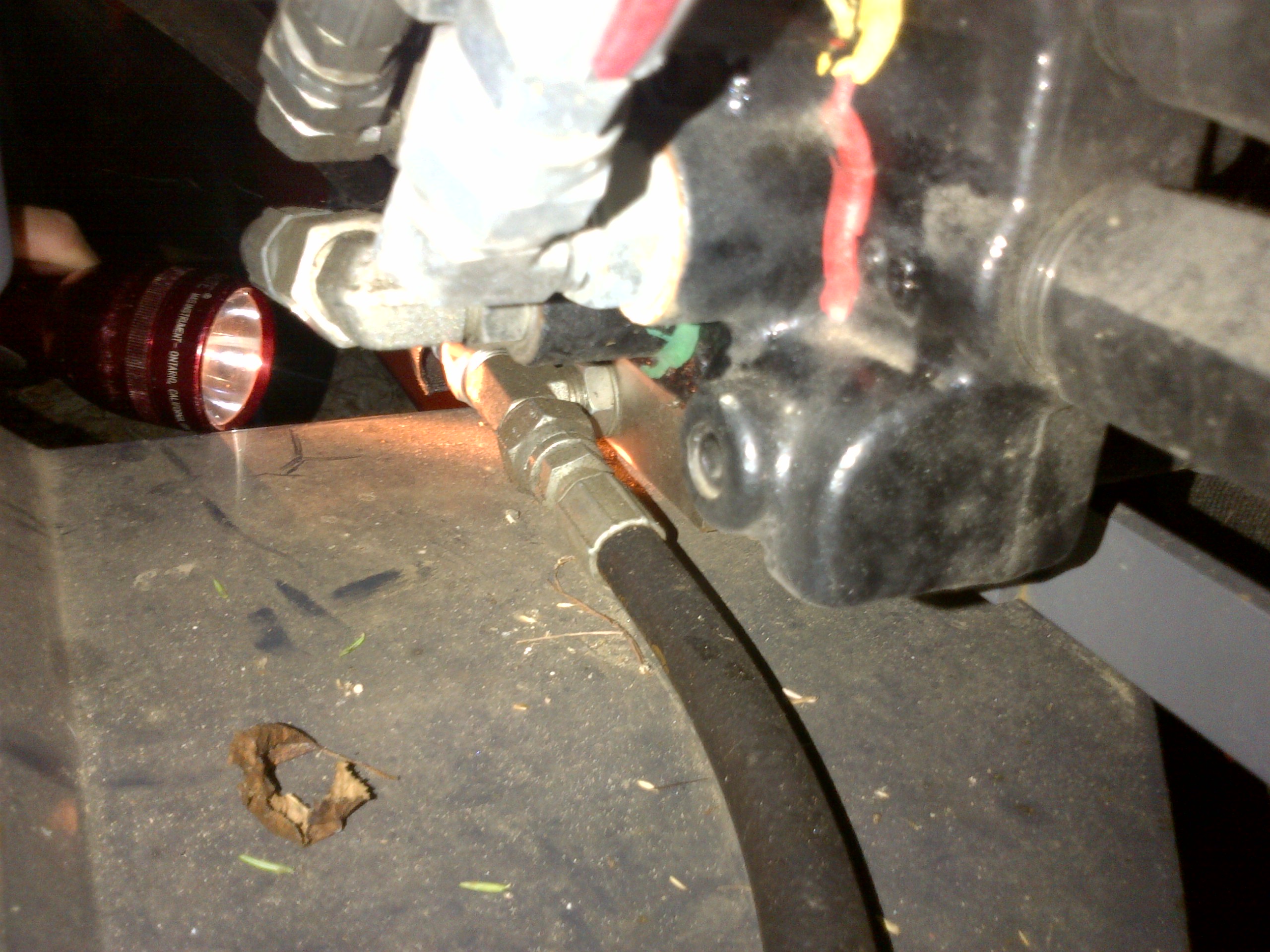

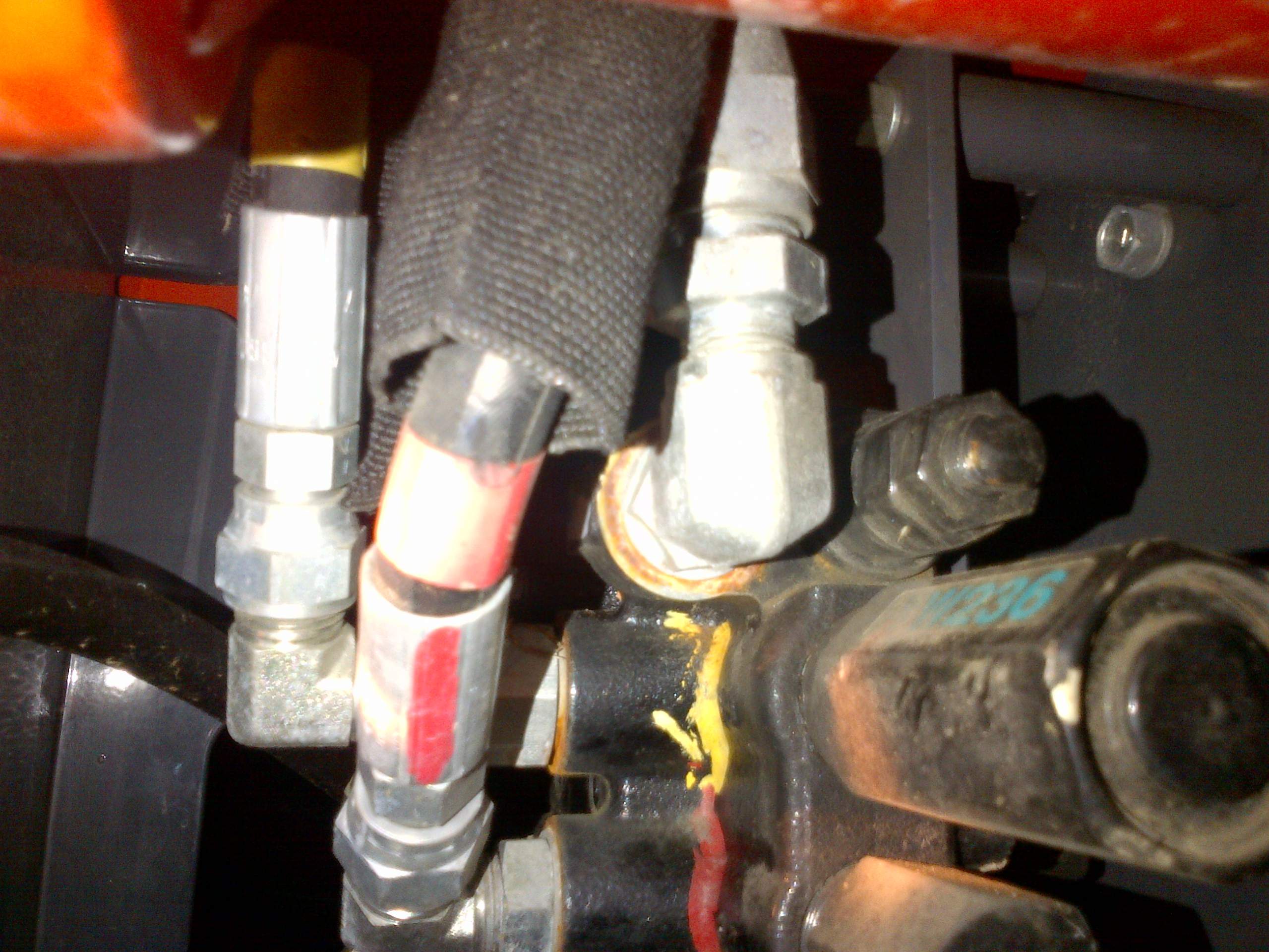

View attachment 337045View attachment 337043View attachment 337044View attachment 337046View attachment 337047
I am still unsure of the single hose. It does go to a T up near the loader valves into the tractor(first pic). Then continues to another T (second pic). The metal line that comes out of the second T goes into the front of the loader valves (pic 3).
The lines I connected together from the backhoe- One is a metal line that connects just under the rear remotes (pic 4) and the other hose goes up to the connection where the loader connections are. It does not T into anything in has its own port (pic 5 bottom most port).
/ Need help with remotes. Identification and controls #11
If it is a tee, it is probably a return hose.
If your loader has PB, it will have seven hoses on it.
