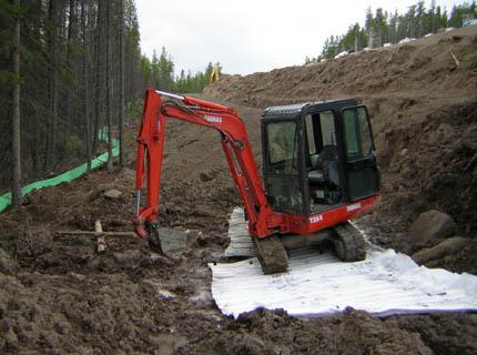

/ Need help with Corduroy road #31
Nilex have a great technical department. If you google their nearest office and ring, you'd get better than a guess which is all I can offer.
I would imagine you'd need to do some grading but this should be possible by rolling out the matt and working from on top of it, much like in the attached photograph. This should allow you to do some grading without getting your feet wet.
#32
Great suggestion. Looks like they only have 1 office in USA, in Denver.
If the matt in the picture a Nilex product? I looked at their website and didn't see anything that looked like it.
It would be great to be able to just plop something down on top of the muck-mud-water-peat and walk/drive over it.
/ Need help with Corduroy road #33
I didn't realize Nilex were a Canadian company. I guess makes sense, they probably work a lot on terrain in the tundra.
The illustration was taken from this site which I got from a link on the Nilex web site. Terrafix is a Canadian company too though.
http://www.terrafixgeo.com/content/?id=145
