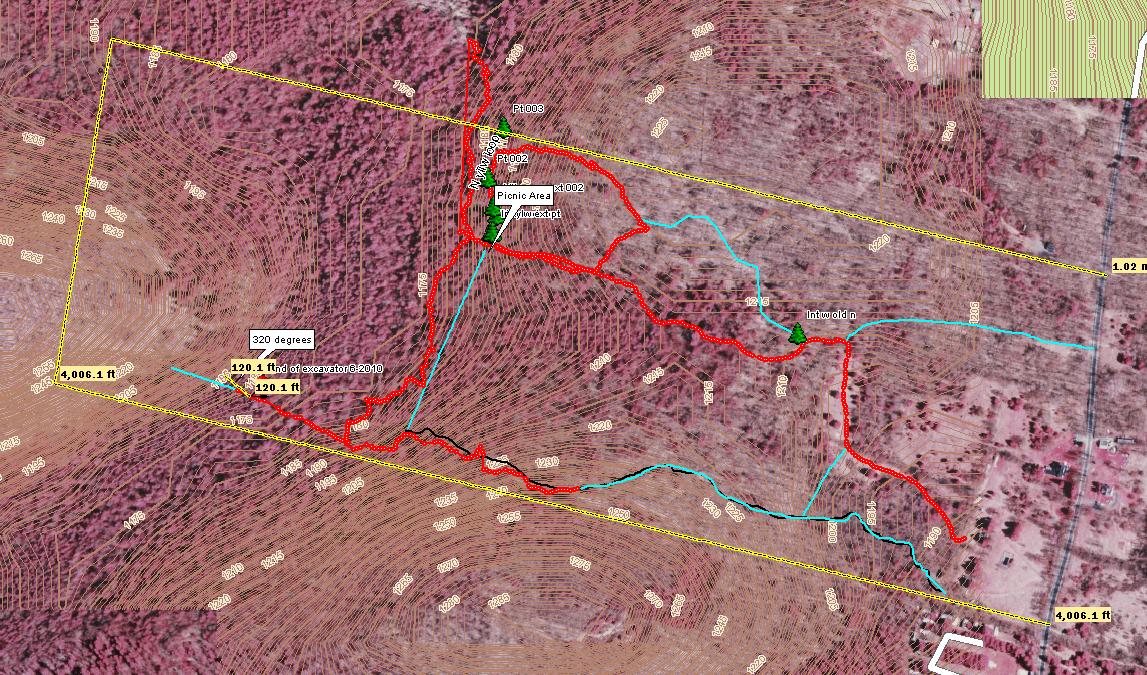

Hi,
I've been searching and am so happy to have found this thread describing the building of a corduroy road:
http://www.tractorbynet.com/forums/projects/153596-building-road-whoulda-thunk-itd.html
I have my own problem project and sure would appreciate some help.
I have about 100 acres in Sullivan County, NY, shaped as a rectange of about 4,500' by 1,200'
About 3,000 feet back, the ground is low and wet and over the decades (centuries?), an incredible wall of rhodedrum of grown -- about 12 feet high, and about 300' deep.
The ground has about 2-3 feet of peat-like stuff -- very soft, spongy ground, likely on top of clay (the dirt around the area is heavy with clay).
I've been trying to break through for years.
First with a dozer hired with a guy, who got a few feet in and refused to continue out of concern the dozer would sink.
Then I hired a guy with a mini-excavator and we walked into it a bit and said he could do it. I said 'are you sure you won't get stuck' He said 'anyone who gets their machine stuck shouldn't own a machine' Could hours later, he came walking out and had to get his buddy with another machine to pull his stuck machine out.
So I have a path that goes about 1/2 way through (150') that I can walk just fine, as long as I stay to the sides and dance around the softer middle (5' wide path created by the excavator), but I can't ride an ATV on it because it's too soft and wet. Then it stops -- where the excavator did.
This past summer, I took my chain saw and loppers and opened up a very small, difficult walking path through the remaining 150'. There's fallen trees and wet area and no way for an ATV to pass.
Past this area the land elevation rises sharply and reveals 30+ more acres of mine that I'd sure like access to.
So I've been reading and researching how to make it so I can pass with an ATV and the only thing I've come up with is a corduroy road of 6-8" diameter tree logs.
I've never done this, and getting manpower up there is difficult.
I was hoping the more experienced guys on this board could share some hints, tips, suggestions, warnings, etc. on how to get this done. I'd like to get this done in April, or May if it's still too cold.
All I've thought of so far is to find a few guys to work for a few days with me (I don't have the guys, but I'm looking), bring the chain saw, loppers and some hand saws back there and have at it. I could certainly have a truckload or 2 of gravel brought to the property, and shuttle it with my little trailer behind the ATV to the site (3,150' feet from where the dump truck would have to leave it.
Thanks very much,
Joe
Here's a picture -- Yellow is the outline of my property, others are paths.
