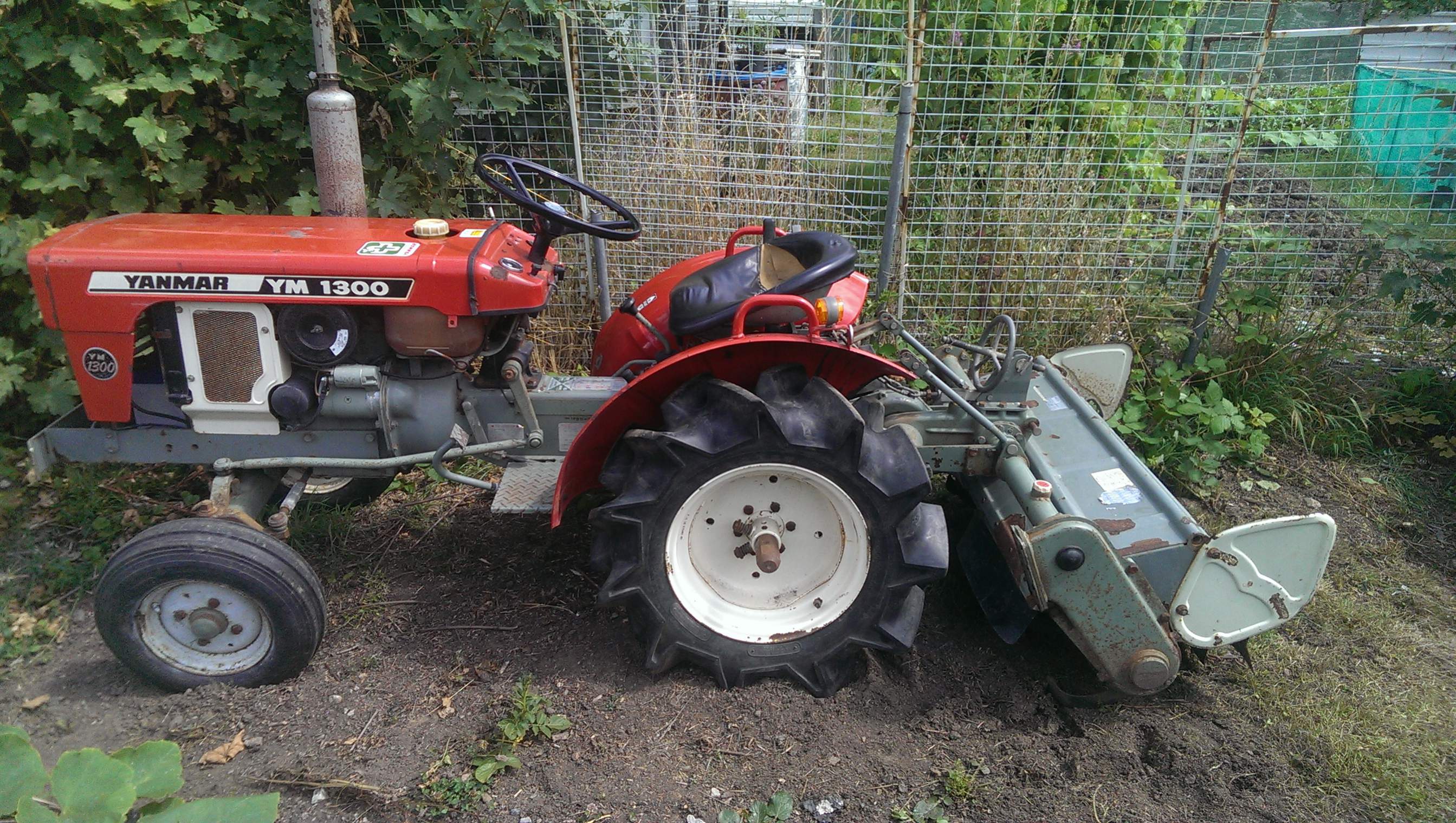

Have just joined this forum after buying a Yanmar 1300 compact with a yanmar 1000 rotovator, it decent nick and at a decent price.
Not this machine doesnt have linkage from what the guy was saying, which is fine i can get hold of that for a relatively cheap price as i want to buy a single furrow plough
However i need to work out how to detach the powered rotovator from the tractor as the connection looks complicated and i cant work out where i need to undo it.
It looks like its connected straight to the machine, the is no exterior drive shaft (if that makes sense)
I have one picture which doesnt really show the setup that well
However the setup is NOT like this https://www.google.co.uk/search?q=ya...80;640;480 it seems like quite a close connection
If anyone can see what i need to do or please let me know, otherwise i can take another pic
/ Need help with a Yanmar 1300 #3
The setup on your YM1300 is actually quite simple, though it is a bit of a pain to attach compared to a traditional 3 point attachment. There are 4 studs on the back of the tractor around the PTO output shaft. The tiller has an articulation that allows it to pivot up and down, and a female PTO connector inside a more or less square box that makes up one side of that joint.
Remove the 4 nuts holding that box onto the tractor, and the lifting links. Then pull on the implement and it will eventually slide off the studs and PTO shaft. It can be fairly difficult to remove; it has probably been on there for 30 years or more. Just be careful, as the implement needs to be forced off all at once, but it's not a bad system really: It produces an extremely compact unit of tractor and tiller, so is very user friendly.

Thank you 284 :), that is a very straight forward and easy to understand reply. Have got some one with some long bars (socket set) to undo the nuts!. It looks like it has some new nuts and threads
Am thinking would it be good idea to raise the tiller place it on two pallets, undo the nuts, links etc and then drive the tractor forward, does that sound like a good idea?
Is the any risk of doing this?, or when it comes to reconnect it ?, i understand it may be hard to undo the unit as you say it certainly looks like it has been attached for a long time. I assume the PTO shaft inside will then need undoing?

Yours may very well come apart more easily; mine would not have come apart had I not tethered it to something solid the first time. The tiller isn't extremely heavy. You could probably lift one side of it at a time onto a pallet to keep it off the ground once it is removed.
I'm not trying to frighten you off from removing it, but mine is markedly harder to connect than a conventional 3 point tiller, mostly because the splined connections have to match up, but rolling the tiller back and forth also spins the the shaft, so it can be annoying to connect.
The PTO shaft doesn't have any retaining device. It simply slips into the female portion, and the entire apparatus is located and retained by the 4 studs.

#12
I think i am going to take peoples advice and not bother with the plough!!
However managed to get the rotovator off nice and easily:) Luckily Partners dad has a garage so brought a lot of tools along and in the end it came of really well
