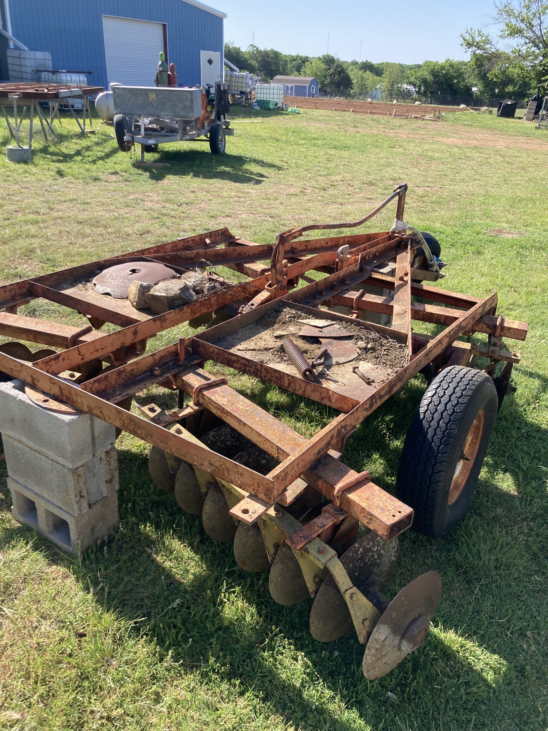

Disc Harrow Need help to ID this harrow disc
   / Need help to ID this harrow disc #1
Matt need help

That's gonna be a tough one. A LOT of companies produced discs over the years. Are you needing parts or just want to know what you have?
I want to rebuild it, need good parts
   / Need help to ID this harrow disc #4
I deal in them old implements. I have never had one they can't sell me parts for. Just measure the bearings, axle, disc, hubs, whatever you want. Make that call to a parts place. There's a 14' disc I'm pondering now. I bought a baler from him already.

I was able to buy gang bearings at O'Reilly's. Wheel bearings would be the same.
Discs, just need to take it apart and confirm center hole design/size, then determine diameter of disc you need.
Keep us posted on your progress!!!
   / Need help to ID this harrow disc #6
ASC had all the bearings and assembly plates I needed to rebuild a 8 foot set of Long brand harrows..
As mentioned remove a section and take measurements of everything..
Axle length
Diameter
Bearing outer and inner
Assembly plate size and bolt pattern..
Spool lengths
End spacers..
I went with Brazilian made blades . Don't fall for the cheaper Indian made ones.. the sand will literally cut grooves in them.. ask my friend about that .
