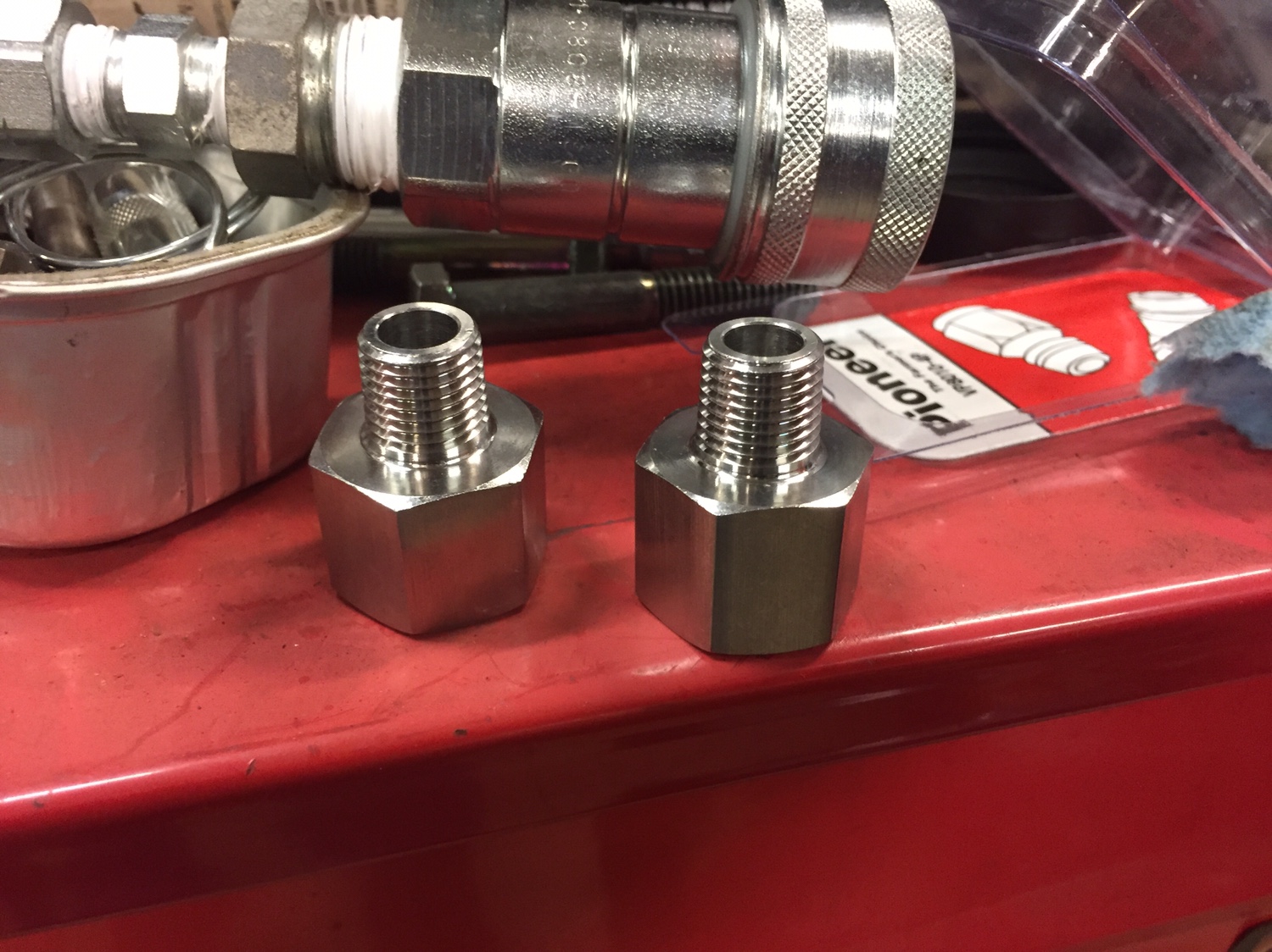

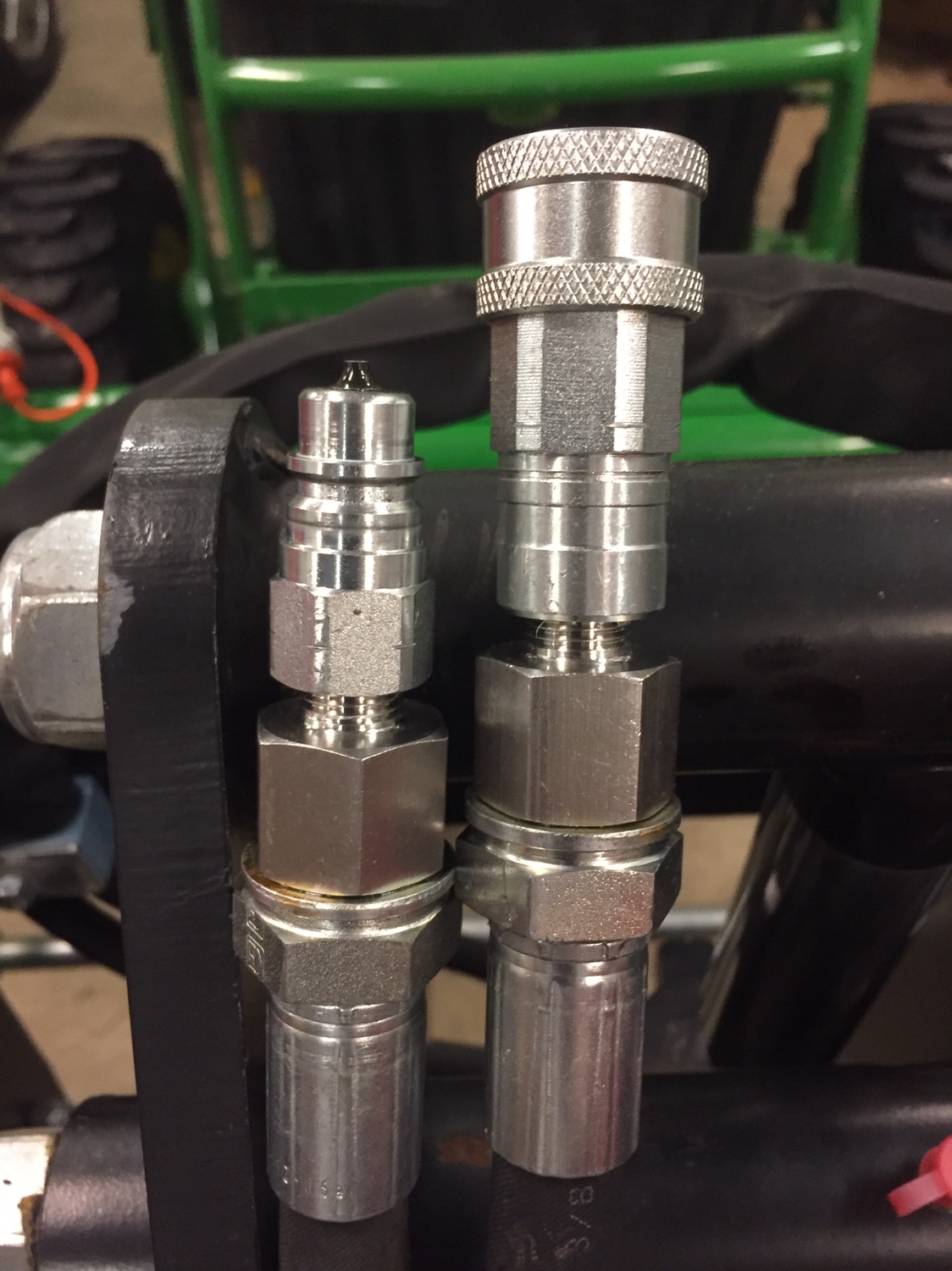

Finally, the unobtanium fittings arrived this past Monday and I got the grapple in the garage tonight to get everything hooked up. I am a little concerned at the small hex diameter of the adapter vs. the sealing washer, but I'll have to wait to the weekend to see daylight and test it out.
