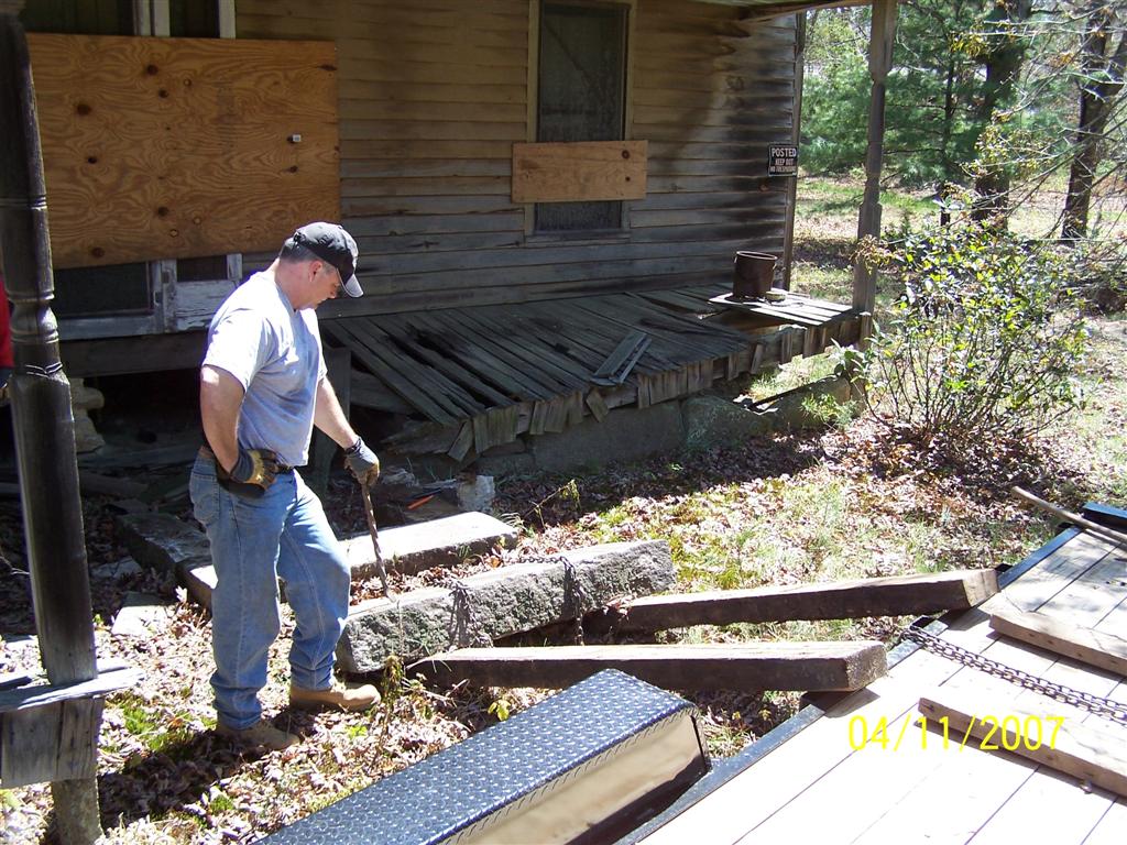

The granite step is on ice as of RIGHT NOW.:thumbsup:
Getting some melting and any adjustments with the pry bar have been a piece of cake.:thumbsup:

That is very cool!:) I thought the poster was joking at first!
/ Need Help; Setting Granite Step #27
I'm still digesting the ice idea, But obviously it works. I just wouldn't have the patience to wait for it to melt to finish the job.

Well, it took roughly 5 and a half hours for the ice to melt....too long. But, it was nearly effortless to shimmy the step into place throughout the day.
If I had to do it all again I think I would use some small blocking with a couple of pinch bars.
Boy, am I glad that project is behind me. Next.....:thumbsup:

Good job, at least it is done and no marks. Hope the wind doesn't blow it away.
If I were to use ice it would be more along the size of ice cubes not blocks.

I did get some minor scratchesin front of the step. If it bugs me terribly I will touch up with a small amount of the polymeric sand. No biggie.
I wanted to use ice cubes but I thopught the weight may crush them.??...Maybe that would have been best.??

It would take a lot of weight to crush the ice.
Seriously, I would likely set it in place and use a pinchbar to get the straps out. Adjust as needed and move on to the next one.
