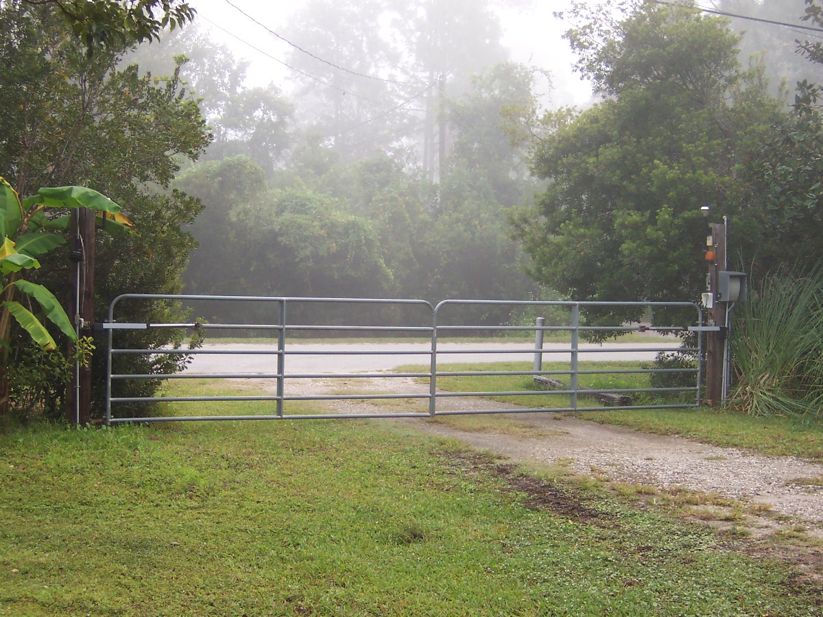

I've had these 12' gates for about 8-10 years with no problems. I bought them a Tractor Supply. Not sure of the gage metal.
I should have bought the gates with the mesh. I had to wire fence material to them to keep dogs out.
