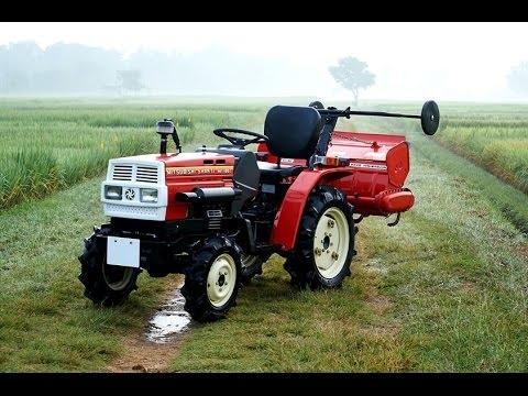

I have a Eurotrac 180D that I believe to be identical to the Mitsubishi 180D. The starter is bad and would appreciate advice on removing it. I have it loose but can not be moved forward enough to swing it out. It hits the hydraulic pump. I am afraid if I loosen the hydraulic pump that it may not go back enough and have the same problem as the starter - neither can be removed without hitting the other. If someone has experience with this please tell me how to proceed. Thanks.

Thanks for the downloads bmaverick. I appreciate having them. VST 180D is on the hood of the tractor. I am 77 and losing a lot of my courage taking on projects. I saw a video online of someone removing a starter on a very similar tractor but the starter motor itself was slightly different. It took me a few viewings before I noticed that the steering rod and hydraulic pipe below the starter was removed. This will allow the starter to swing down instead of away. I will let you know if this works.
   / Need help removing starter from 180D
I only had to take off the steering shaft at the bottom of the steering wheel shaft. The steering shaft would then swing over the left front wheel and give room for the starter motor to swing down and out of the engine.
