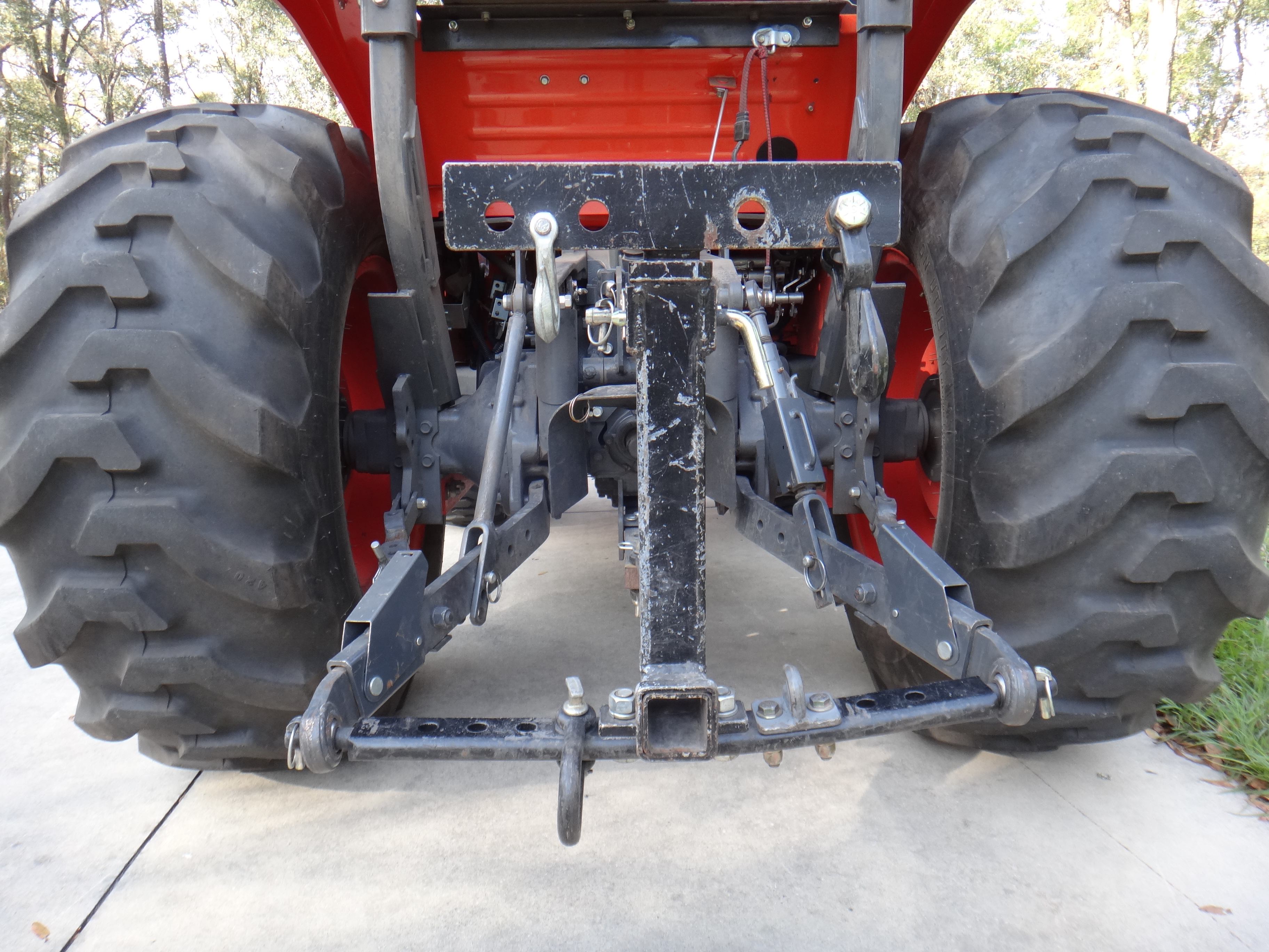

Neither a BX nor a B will be effective with a Disc Harrow. Plan on purchasing a PTO powered roto-tiller instead. Disc Harrows and roto-tillers are both soil mixing implements.
Moving heavy loads in an FEL bucket up, down, or across slopes is extremely hazardous. If one tractor wheel drops in a hole or rut the tractor can roll in less than one second. If this is a must, get a larger, heavier tractor. Larger wheels are less likely to be swallowed by holes. Greater weight means more stability. Fill your rear tires with liquid, to lower tractor center-of-gravity. Carry a very heavy counterbalance on the Three Point Hitch to offset load weight in bucket.

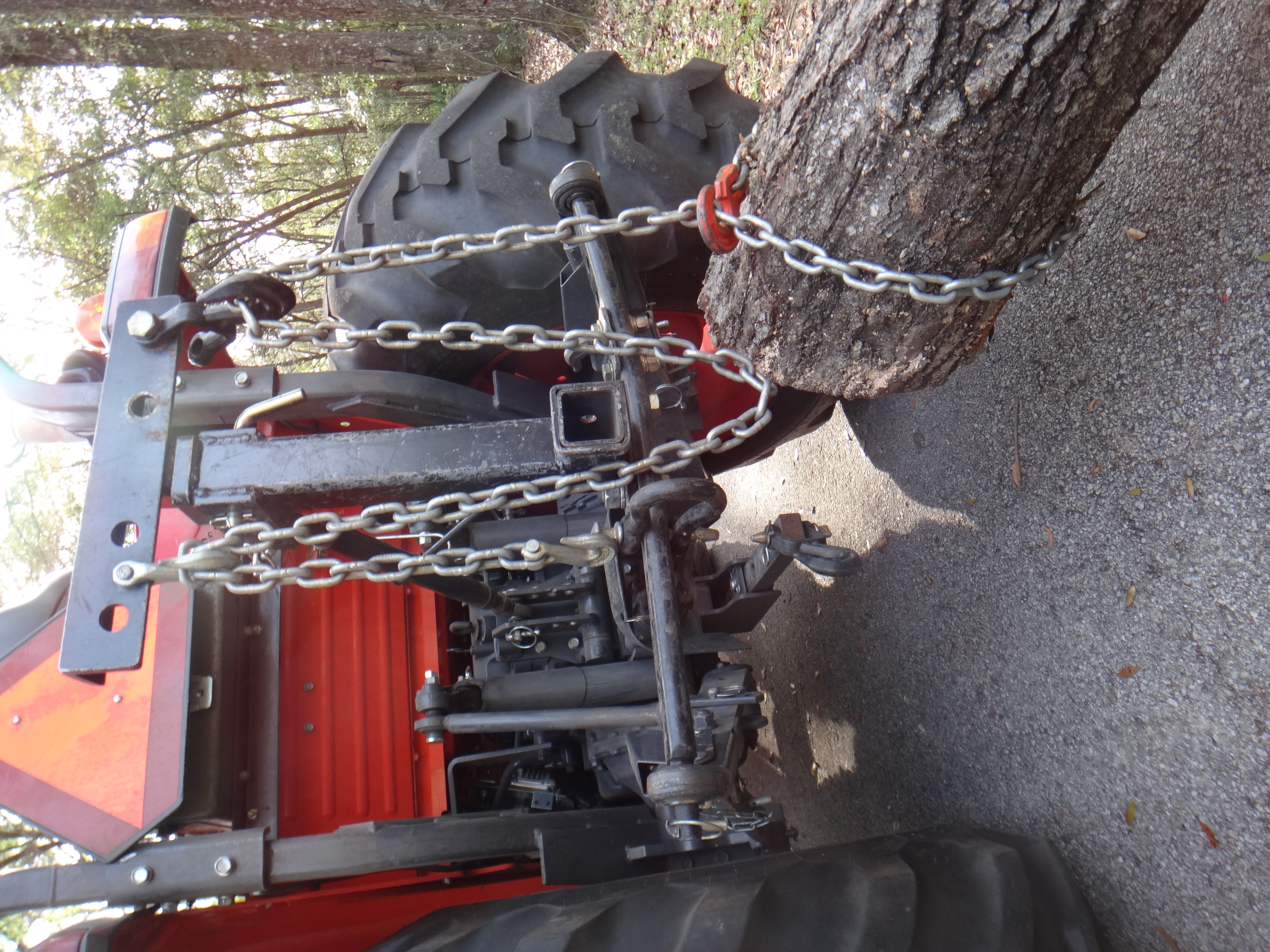

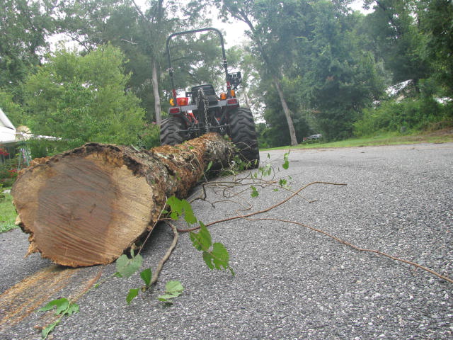

If you elevate log butts, reducing ground friction, a small tractor can pull pretty heavy logs on level ground.
Photos #4,#5,#6, #7.
