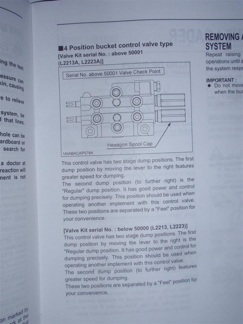

Edit: BTW, the manual on my 723 loader says there is a non-regen position on the dump valve. There are 2 versions - the older one has the regular mode that is all the way to the right. So just barely opening it puts you in regen but full push is normal mode. The newer valve appears to be the exact opposite.

I had to look real close, but I see it now. The cross-overs were hidden by the other hoses. It looked like it was just crossing-over the back ports to each other.
To me that moves the problem upstream. Something must be restricting the regen flow. Could that block be doing it? Or the solenoid? Any one of these add some sort of check valve in them?
Also check out the photo of the manual I posted. You should have a position that allows you to avoid regen.
I will be curious to see how this works out...

You have an LA853 loader, per your first post? I guarantee you have regen as that manual page I posted is from the loader manual for LA513/723/853 loaders. There is only one valve offered at a point in time (one for older models, one for newer ones), like it says. The regen is the second stop on the older valve, but the first stop on the newer valve.
I dont understand how a valve with regen as the 1st stop could give you a controlled dump. It seems it would start to move quick :eek: and then slow to your choice of speed in the 2nd section. Sounds bad.
larry

I just read the manual that I have. Duh
It tells me that serial numbers higher than 50001 have one that dumps fast then slow (regular) as you move the lever farther right.
Valves with a number lower than 50000 have the other. It dumps slow (regular) then fast as you move the lever to the right.
My loader number is 558?? so I should have the first one. However this is not how my loader works. It works like the other one.
Just when I think I have the answer they change the question.
Russ
