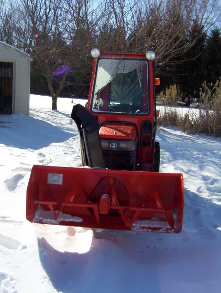

Freds, I've come a ways since I started this thread back in Sept. I've installed 5 - 55 watt lamps on my CUT I have two Trapezoidal beam lights on the front of my canopy and two more on the back I was concerned about the draw from the lights so I installed a three point switch forward for the front lights back to run the rears, all four lights could not run at the same time (boy am I smart). This is when I realize that when doing FEL work at night I would need to back up (not so smart afterall) so instead of rerunning wires I installed a fifth light, spot type, between the other two on it's own switch. I've since used the tractor several times this winter moving snow and am very happy with the setup. Hope this helps

I like the trapezoidal pattern ( even if it is a round lamp shell.. etc.. ).
Wide beam.. decent light...

I bought my lights from Northern Tool about $20 each. They're not high end lamps but they're more than satisfactory for me, I get good distance and overlap. I'll try to explain trapezoidal beams if I can spotlights are just what the name says a direct and narrow beam with good distance, floodlights send out a wide beam but not for a great distance. Trapezoidal again, like the name says sends out a wide triangular shaped beam without sacrificing distance, with two of these you have an excellent overlap mine are actually angled out a bit to give a wider beam. I've had no problems with power I have an L3710 with the 40 amp alt. I have been running with my headlights and flashers no problems.

If you have a TSC nearby, you might want to check there for lights. I put two trapezoidal facing forward (55w) and two floods facing rear (55w). I paid about $15 per light. As far as switches, etc. go2marine has the best selection.

I hunted down 4 lights at two Autozones. Apparently they only stock two at a time called tractor lights, which are the ones with the trapezoid beam pattern. Picked up some wire and plastic flex conduit. Looked at some switches at the local Carquest and found the same thing cheaper at the local hardware store. It's a toggle switch with a rubber boot labeled "marine" and I was told that all the grapepickers without cabs use that kind. Picked up two bolts for the ROPS too, to mount my angle with and 4 rubber grommets to use as isolaters for the lights. I may get to messing around with it today... in amongst disassembling one wall of kennel runs for my remodeling project, cutting 2x4s and drywall, picking up a new printer because my color one won't feed anymore and I need to print some stuff in color.... just the usual stuff when you finally have a nice day and want to work on an outside project (the lights -- no garage). /forums/images/graemlins/grin.gif

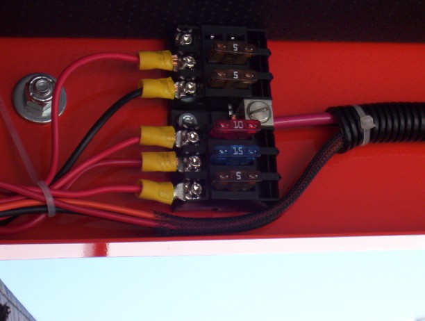

We had a day in the fifties earlier this week and I got the light bar and lights on. I got a good jump on the wiring, also. The flex conduit is a lot flimsier than I expected so I let the wires come out a seam and wrappped the heck out of it with tape. It appears this is how the factory did it. I soldered the connections so I didn't have bulky connectors to try to fit into the 1/4" flex conduit. The 2-12 ga wires took up enough room on their own.
It looks like I'll be hooking up to the battery /forums/images/graemlins/frown.gif . I had really wanted to utilize the fuse box, but can't locate the female terminal for the other side of the mini fuse holder and the hot wire, not even at my dealer. Seems kind of dumb that they would have a spare slot with one terminal in place, but spare terminals are not a readily available item. Might be nice to be able to flip the lights on without having to have the key on anyway.
Of course, it's winter again so I'm on hold for a while..., but the good thing is that I got to do some snow plowing again yesterday /forums/images/graemlins/laugh.gif and it looks like I have lights that work /forums/images/graemlins/tongue.gif

Freds, depending on its location, it might be easier for you to run your power wire to the alternator stub instead of to the battery. A lot of tractors have the battery all the way up front and the alternater is often easier to get to without running wire past any spinnng fans or moving belts. Just a suggestion you might want to consider.

Thanks Bob, the thought never crossed my mind. I was going to run them alongside the existing harness and there's even some "ties" in place for some option I suppose... I'll have to give the alternator a looksee. I can't even picture where it is right now. /forums/images/graemlins/confused.gif

What is the difference between the FR-10, Fr-11 and FR-12, and do you recommend a fuse or a breaker?
   / Need Help, Lights, I must be dummer than most #76
Congrats you've now found someone dummer. What type of fuses plug into the ET 220 fuse block from sherco?
