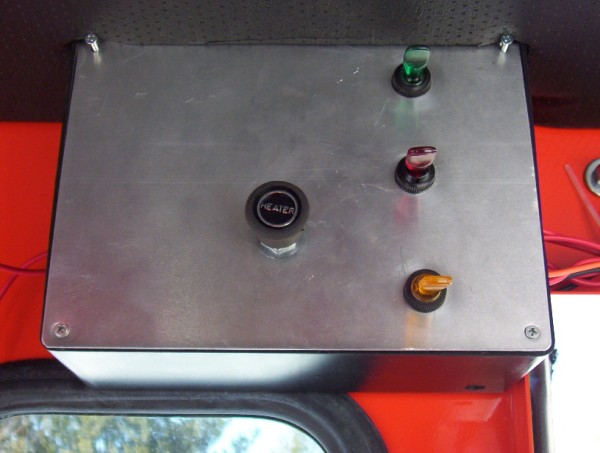

Freds . . . I purchased my stuff from Go2Marine over the internet. They obviously are a marine supplier. I wanted waterproof stuff. Go2Marine Web Site
There are probably dozens of other sources for the same/similar parts.
IF you are at all worried about drawing down your battery, and you want to run 4 lamps at once, you might want to consider 2 35 watt lamps and 2 55 watt lamps. That would likely keep you at 40 Amps. Your own use will determine if it ever becomes an issue, but I'd probably feel very safe with 4 55watt lamps and just switch them off when not really needed.
