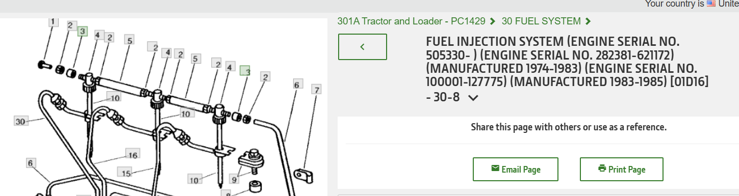

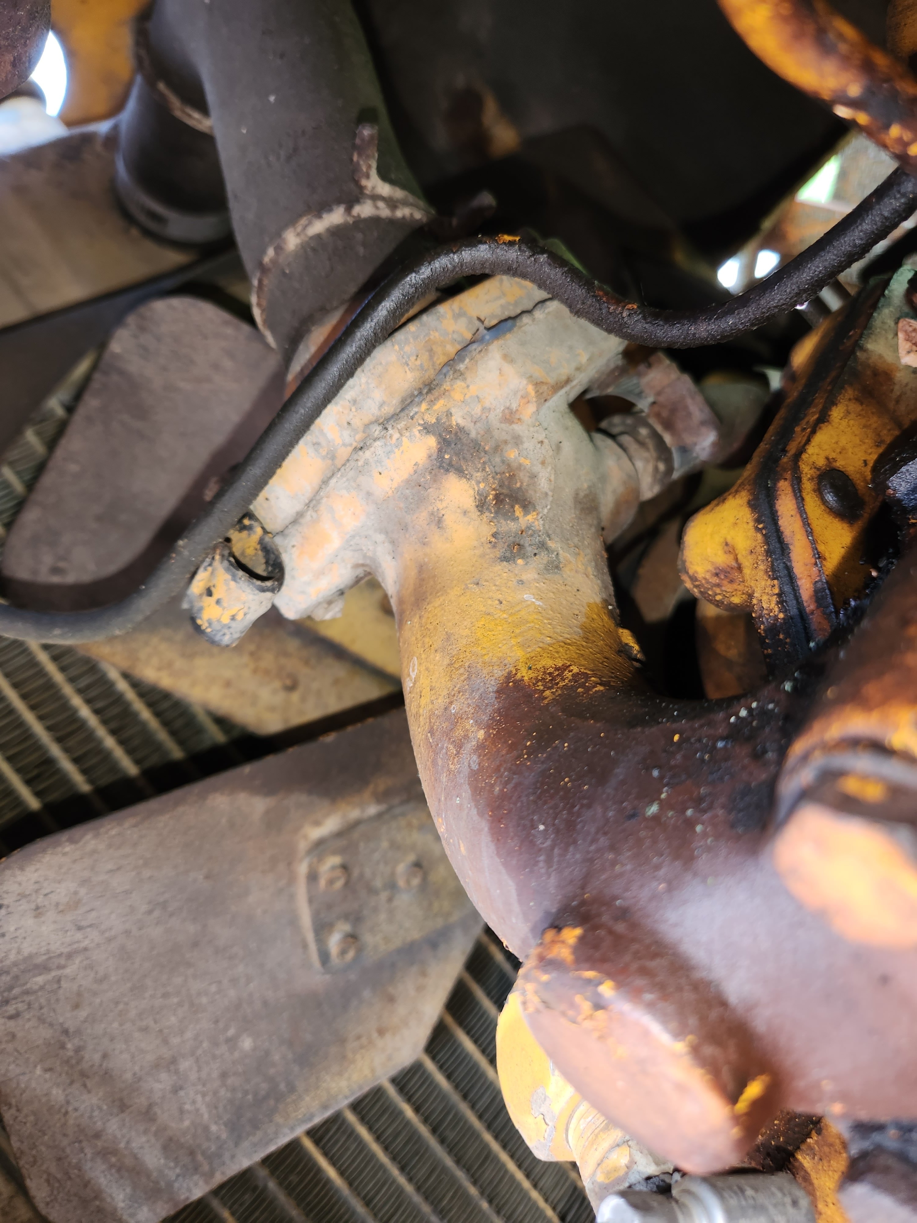

What us this line. It's leaking at the fitting.
A part number would be great

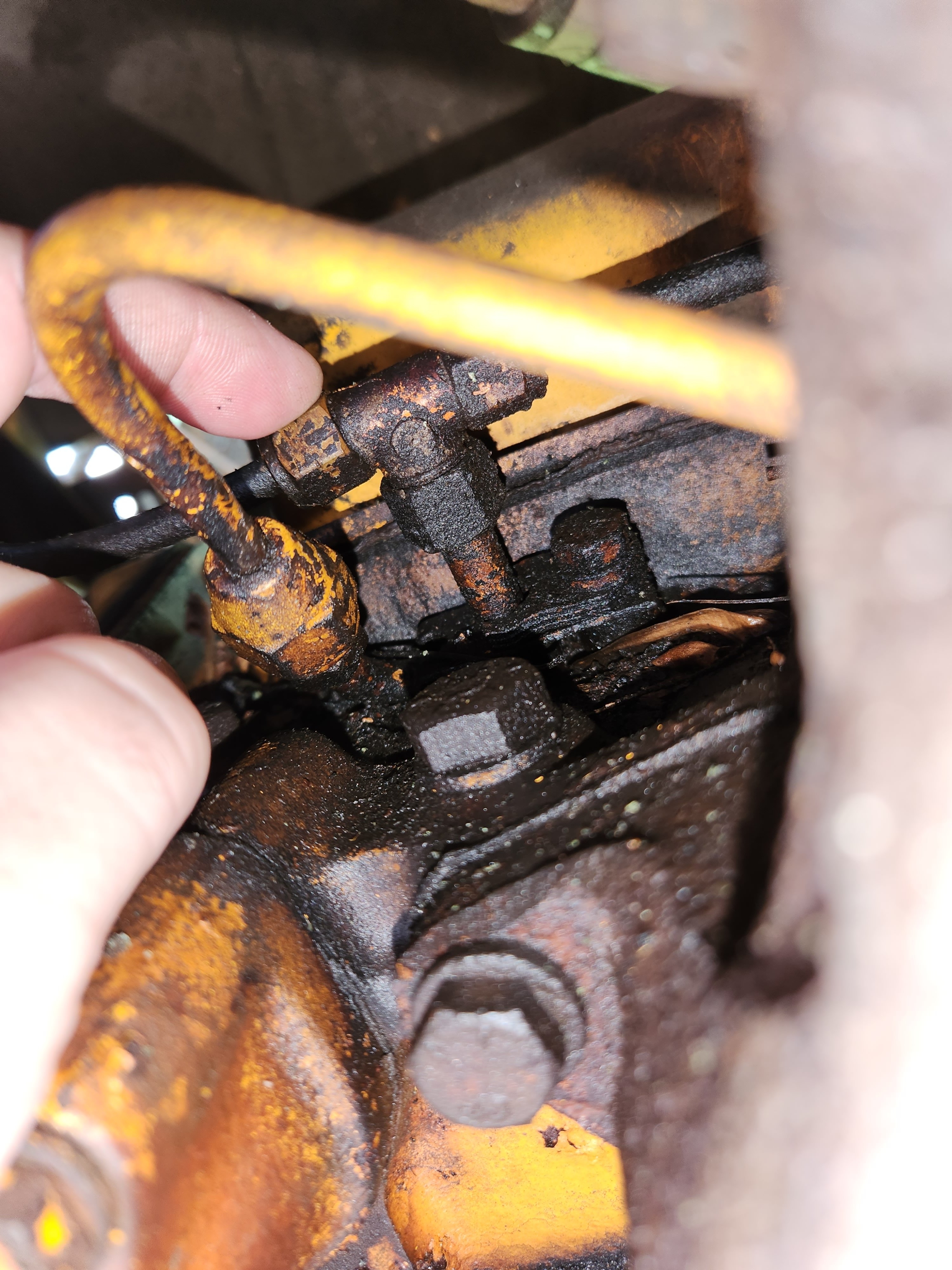

My finger is on the fitting that leaks
It runs to the bottom of the fuel tank I believe
   / Need help identifying this line John Deere 310A backhoe #2

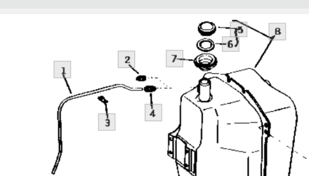

Tee fitting that you have your finger on is on the fuel return line that leads back to "top of fuel tank". I think I located the correct seal(item 3) part # R51936 if your tractors serial range resembles SN in photo below. Seal on top of injector is part #R79605. Item 1 in 2nd phot is fuel return line to tank.

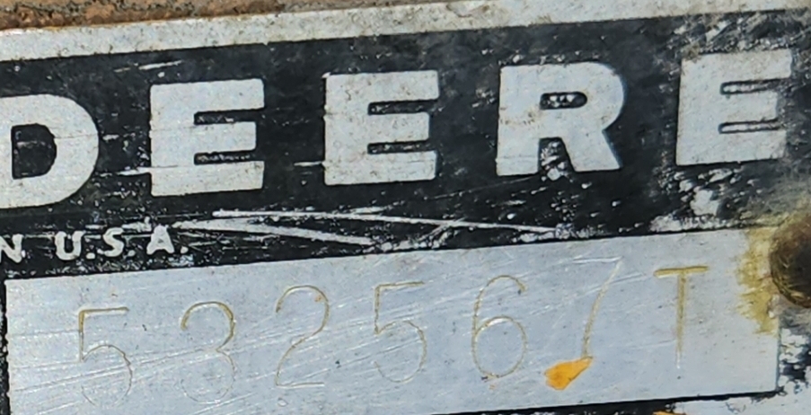

Hopefully you can see it.
This ends in a "T" so Im not sure this is the correct serial number...
It is on the engine. Right side.
Upon further review of the line it does indeed go to the top of the tank.
Thank you much for the ACCURATE and quick response !!!!!!

Number on tag on engine is the engine serial # not model serial#
You're welfcome
Thx for that.
By that serial number on the engine do you think the part# you presented will work?
Thx
   / Need help identifying this line John Deere 310A backhoe #8
Sorry I forgot that the thread I posted listed engine serial # range. Yes I think part #s I posted should fit your tractors fuel system.
