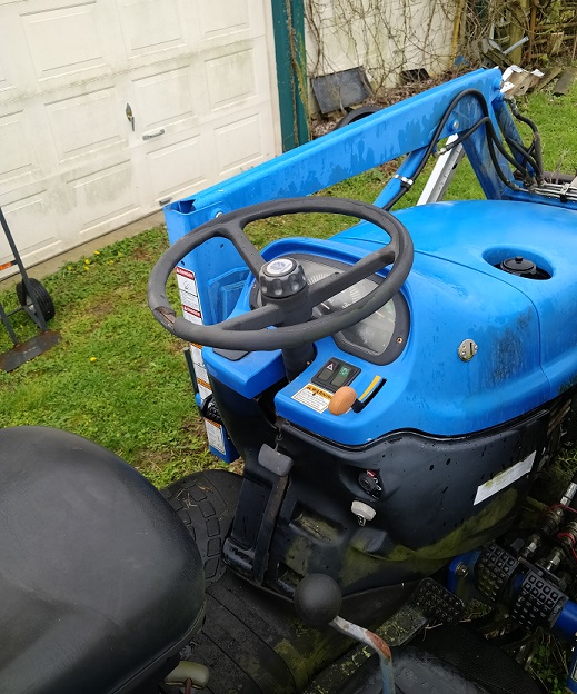

Another question I had, and I feel a bit silly having to ask it...how do I remove the oil fill cap next to the fuel cap? I sat there for several minutes trying to figure out how to open it and either it's really tight or it doesn't come off the way I think it does.

Yep, cap is just very stuck. Thanks again.

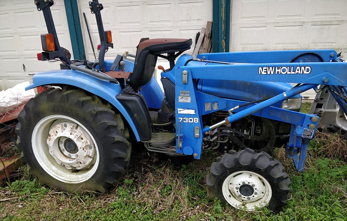

I'm trying to fix a tractor, left behind by my father in law that passed away recently, so my MIL can go back to using it to tend to their property. I was told that it stopped starting with the key one day so FIL was bump starting it with the solenoid I think, and eventually the starter went out and he possibly replaced it but determined the replacement was the wrong type. I found a fairly clean looking starter in it, not tightened down and not wired up, and I took that to Autozone and they confirmed it's good. However, I have no idea if it's the right starter because I have no idea what year or model this tractor is. MIL has been trying to find all the paperwork and title but no luck yet. She desperately needs this tractor and its brush hog up and running soon.
After looking it over all I've been able to conclude is that it has a starter half-installed(only one bolt tightened, not wired up) and when I took that starter to Autozone it tested fine. I have no idea if it's the right starter because I have no idea what model this tractor is. Once I figure all that out and can get a starter for it, or if this starter is correct and works, I then need to figure out why it won't start with the key which I assume is probably caused by an open or bad killswitch somewhere.
Pics...
Any ideas on year/model, and any tips on sorting out the no-start issue?

According to a previous post, looks like it's an '03 TC29D.

Tractor Number: G040849
Unit: 3A08D
There is a 2004 on TractorHouse with a serial number that is close to yours, so I am guessing it is a 2004
2004 NEW HOLLAND TC29D
Less than 40 HP Tractors
For Sale Price: USD $15,000
Hours: 1037
Drive: 4 WD
Engine Horsepower: 29 hp
Serial Number: G040659
Hours: 1037
Drive: 4 WD
The unit code dates the tractor. As stated the build date is Jan 8 2003.
