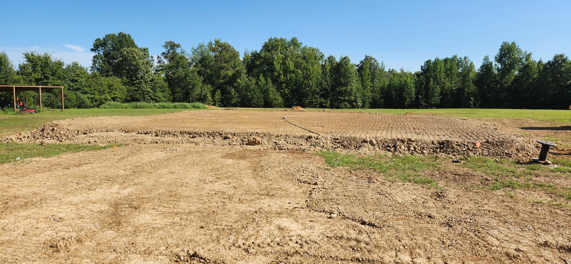

Title says it all. I have my pad built and I think there may be a picture in my shop thread. I wanted to break this thought out so there would be more visibility and hopefully I'll get some good thoughts. I'm planning on renting a mini-x this weekend and getting it ready for concrete. I have 2 things I need help with.
1) I want to dig the footer turn downs to the finished size and add forming above instead of digging wide and using 2x12 boards all the way to the bottom of the footer. This way I can save money on boards and get a little deeper footers. But, I've never formed anything and I don't really know how to make it all line up and hold together.
2) How do I get 4 runs of re-bar to hold together. I know there are rebar chairs that will hold the bottom 2 off the bottom but I don't know how to elevate the top 2.

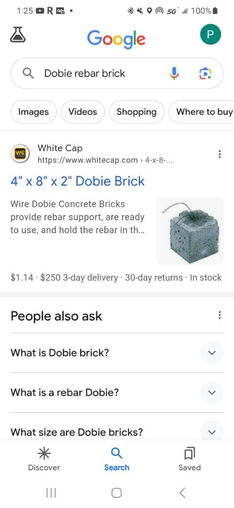

top 2-#4s, tie them as well. The 'beam' will be kinda floppy, so don't think you can lift/place more then max 20ft at a time. The bottom of the box will need supported by chairs or a'dobe' bricks. (basically a solid brick with a 2 tie wires in the top of it.

You can also look for some 4" tall dual bar chairs, and then some 8" tall dual chairs, and not tie anything but laps and corners.
/ Need Help Framing a Turn-Down-Slab #8
Looks like a #3, 6"×8" rectangle stirrup is 4.08 Cunuckistan Copek, or about $3/each. Trouble will be finding them in stock, but Whitecap and many other custom bend rebar.

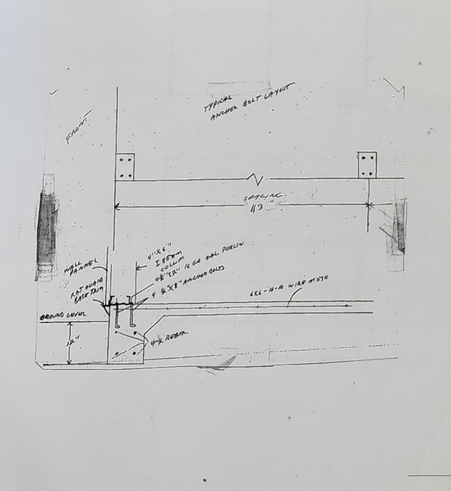

The drawing is pretty vague, it's the picture on the first post. He said the biggest thing is just to make sure there is 12" under ground. I was planning on 12"x12" footer with the 4" slab on top of that. So the footer portion should end up about 16" thick.
I have an option of a 12 or 18" clean out bucket. I don't know that I need to go 18" wide on the footer?

Quick sketch. Looks like a 2x10 form board will be plently; and for that, I dont feel kickers will be required, as long as you don't use 2x2s or 1x2s as your form stakes. Also attached a generic image, that I think, explains a bit of what I mean about just forming the exposed face.

The 12". Once that native ground or fill is over excavated, you will either have to form it, or deal with Major over runs in concrete. It's very difficult to add material back with earth forming.
