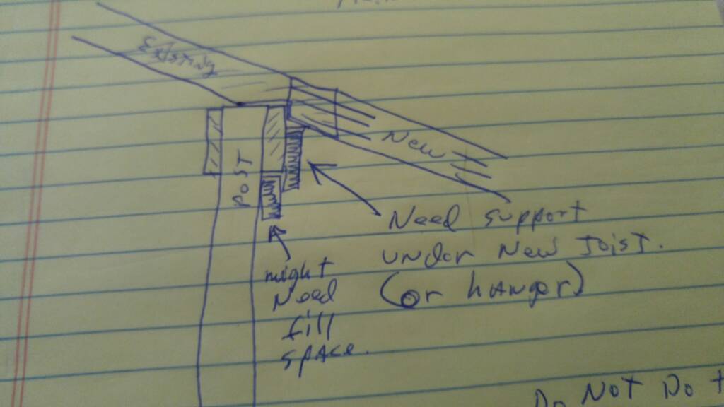

Finally got some other projects out of the way to hopefully get this one going.
1. How do I get the nails out of the siding if I plan on reusing the existing siding? How about a big pair of nippers and cut the heads off? Probably took me an hour today to just get two rows of nails out so I could peel back the siding enough to peek underneath. First I took a flathead screwdriver to dig the rubber grommet off then I could get my hammer to fit around the head, most of the time..

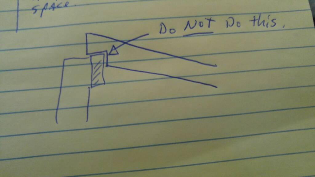

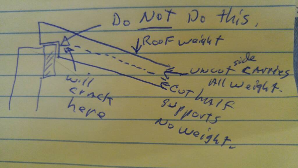

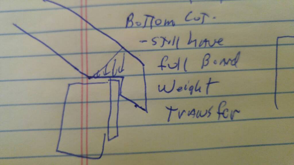

2. Here's how it looks. Looks like I've got about 6.5" of header under the soffit, 5.5" if you only count the exposed wood portion. I was thinking of butting up a 2nd board underneath the existing header. I'd use rafter hangars with the hangar nailed to both the existing and to the new board underneath

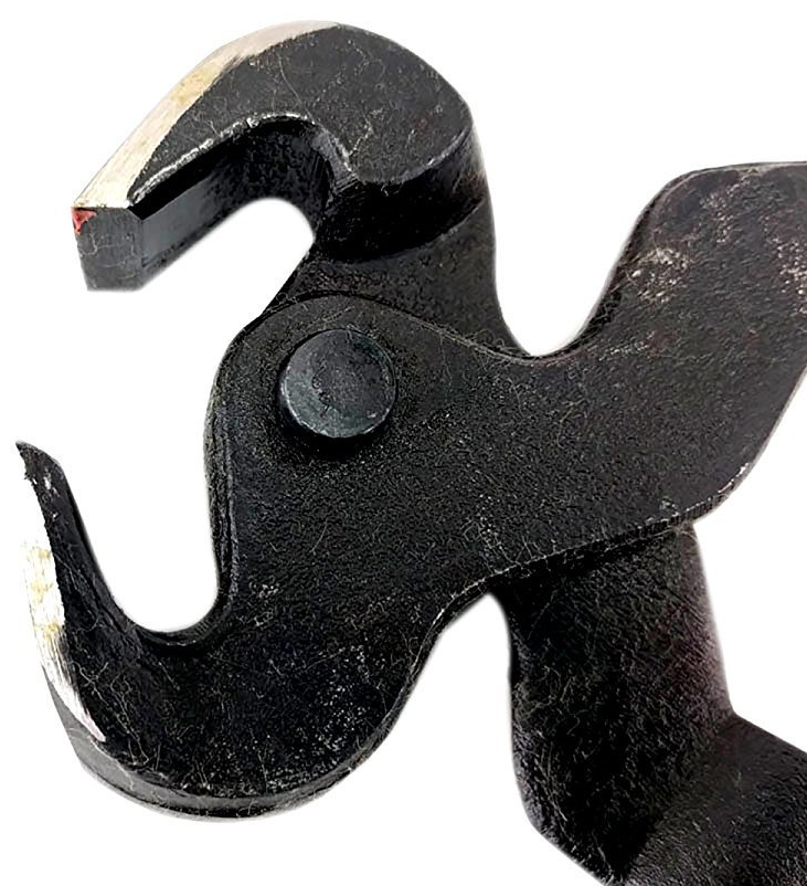

Just picturing it in my head I don't think the bolt cutters would work well. When I looked it up earlier I saw the hoof nippers and thought the design looked pretty good but wasn't sure if they were strong enough since they're made for hooves.
Why hoof nippers and not bolt cutters? You need something that will cut flush to the siding. You've got about 1/16" of clearance and I don't see bolt cutters having enough room. Although looking at those bolt cutters, I see they have a flat side and a diagonal blade, so that might work to catch the nail head.
Here's what a hoof nipper head looks like and why the shape is perfect, but again I question the strength of those to cut say, 300 nail heads off.

Have done this proccess of cutting the nail heads. Hoof cutters are too weak. Use the ones that look like them with the blue handles

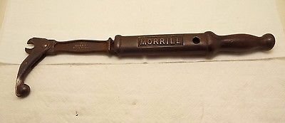

Here to tell you huys that old time nail puller i posted does a surprisingly good job.
/ Need help figuring out barn extension #36
I'm sure it did. Those are good at pulling nails.
If you were pulling the nails did you get any damage to the siding?
Put a board under the part of the tool against the siding and you will have very little damage. The one timed i used one years ago i was amazed.
Does that have a hammer slide on it? Hardware store near me had something like that. Had something to grip on one end and a hammer slide on the handle.
/ Need help figuring out barn extension #39
The one I used did not. You use just like a claw hammer, the difference, those jaws clip under the nail/screw head, and the more you pull the more it tightens. You can put some real pulling force that way. It just flat works.
