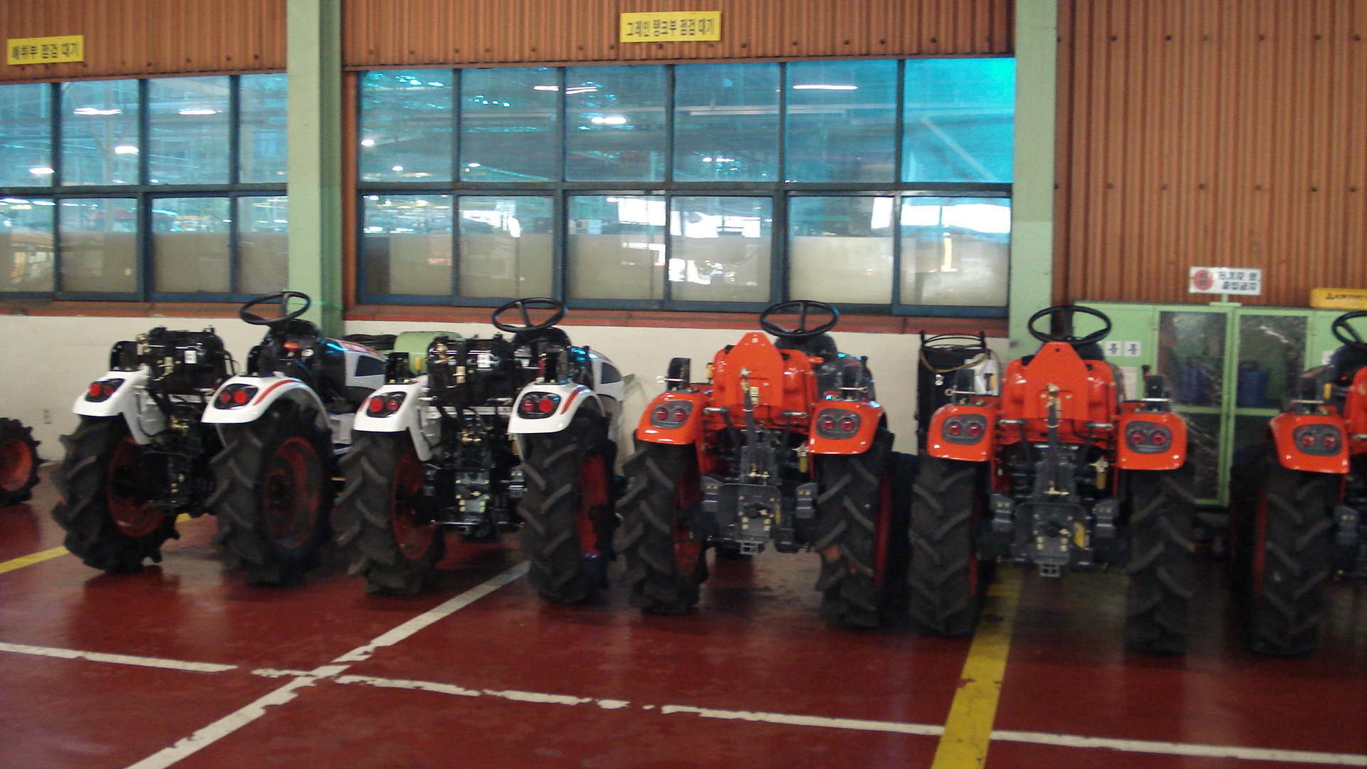

Having been through the same process last spring, I finally purchased a Bobcat CT122 (basically the same as the Kioti CK22) which is the same as a CT120 except for 2 more horsepower. I was told that there were about over 130 changes from the Kioti, but that Kioti did adopt most of the changes except the following: I still would like to know the changes??
1. Sealed electrical connections (like our other equipment) Hmmm when Iwas in Korea wathching the Kioti and Bobcat come down the same assembly line it didn't look like they had different baskets of parts they were picking from the same basket of parts were used for the same tractor as a matter in fact now that the Kiotis are coming thru with black frames I'll bet the only way you can tell them apart is the white fenders and hood korea trip 239.jpg
2. Spark Arrestor muffler (to prevent sparks from exiting the muffler and starting a fire) Same muffler
3. Not only our standard seat is different but we also offer a suspension seat. (it does not tilt on the back but has a height adjustment and a suspension adjustment)The only difference is Bobcat uses a gray seat with their logo embossed in the back rest, they are both suspension.
4. Operator condensed hand book attached to the tractor Kioti does not have this option
5. Loader & Backhoe attachments are made to Bobcat specs (more durable & quick exchange on larger tractors)
6. Parts support (Bobcat uses a central warehousing system to stock parts beyond what the dealer has in stock) instead of ordering directly over seas and waiting. Also can pull inventory from other dealers if the warehouse is temporarily out. Kioti also has a central warehouse and we also can get parts from other dealers.
I do not know if Kioti has made those changes yet. I doubt Kioti will ever make the 3 changes..ie. Bobcats seat, white color and manual holder.I liked the local Bobcat dealer and since they are about six miles from my house instead of 45 miles as the Kioti dealer was I went with the Bobcat. If my bc dealer had nt not had a good reputation I would have gone with the Kioti.
