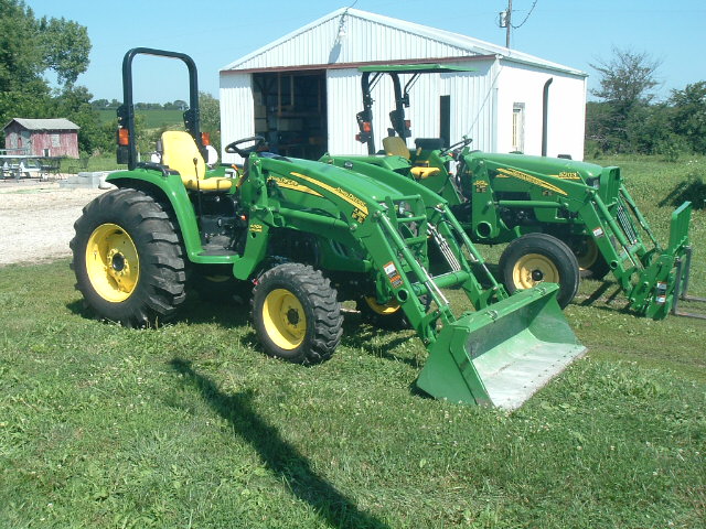

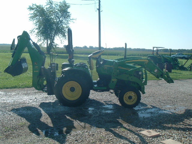

If you are looking at going ground engaging work I would recommend a JD 4120 Power Reverser. I had a 3320 ehydro and quickly upgraded to the 4120.

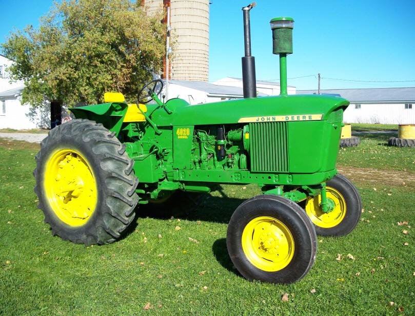

Hmm...interesting. I know I mentioned the equipment but honestly for the most part I will mostly be using just the loader and mower on this tractor to move things around and clean up. My 8n has one but as with a lot of old loaders it is a hassle to get on and off (basically have to crawl over the loader like a jungle gym to get on) and the new tractor seems to have a higher load capacity than my Dearborn loader not to mention the lack of power steering on my 8N. I forgot to mention the disc is fully adjustable and that we actually used to pull it behind the 8n we used to have years ago and those are only about 25HP but ours prolly wasnt makin that at the time...would it still be too much for this tractor or..? In the future I intend to get a John Deere 4020 to take care of all my plowing duties and use the new tractor to move things around for whatever I might be building/restoring at the time.
