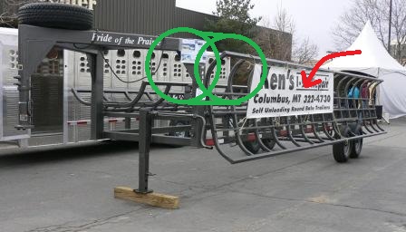

like this...

No, just have it pivot on one side and side dump. have some sort of stabilizer bar to fold down and dump the load on one side.
   / need help building hay trailer "unloader"!! #14
Kinda like this...

i think maybe two stabilizer bars.
   / need help building hay trailer "unloader"!! #16
Be sure the stabilizer bars are in safe locations so they wont get crushed.:)
   / need help building hay trailer "unloader"!! #17
Hard to beat a hay van for hauling rolls.
I had a trailer I considered doing some thing similar when I only had poor loader tractor,
I had come to a conclusion that if I built a cradle and then put the pivots in the stock pockets of the trailer, (was concerned about the width and was wanting to keep them from falling off the trailer as well),
but then put some hydraulics on trailer to push the cradle up, very similar to the hay hauler like in the pictures, but adapted to fit on a 20 foot flat bed, and removable so the trailer had more than one use, if a post was fitted in between the cradles one could use a winch and cable to lift the cradles as well,

i am thru hauling hay for the year and can now get u all some pics and
get to work. i believe a plate down the middle about 3 foot wide and raised
by either hydraulics or a lever type device would work good.
